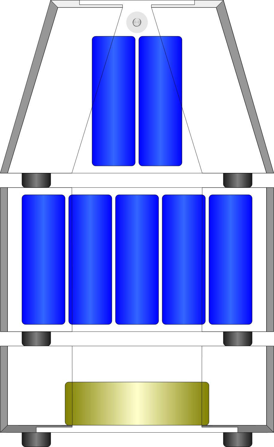

Here’s a quick status report on what I’m up to:
* We have a preliminary schematic for the output section so I purchased 3000 TO-3P transistors to begin matching. Tedious work by the way – I’ll need plenty of English Breakfast tea (cream and sugar, please).

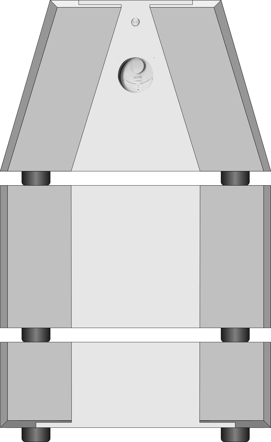

* I procured eighteen aluminum plates, each 18” wide by 28”deep by ¼” thick. Each of the 6 monoblocks will consist of three chassis (see sketches below) and each chassis will contain one of these plates as the main structural mounting plane. Zero and I are fine-tuning the layout of the innards, and then I’ll have the plates CNC-machined.

Regarding the capacitors in the sketches, each amp contains forty 26mF, 250VDC screw-terminal electrolytics, which adds up to over 1 Farad per amp. Each capacitor is 3" in diameter and 9" tall.

Regarding the capacitors in the sketches, each amp contains forty 26mF, 250VDC screw-terminal electrolytics, which adds up to over 1 Farad per amp. Each capacitor is 3" in diameter and 9" tall.![]()

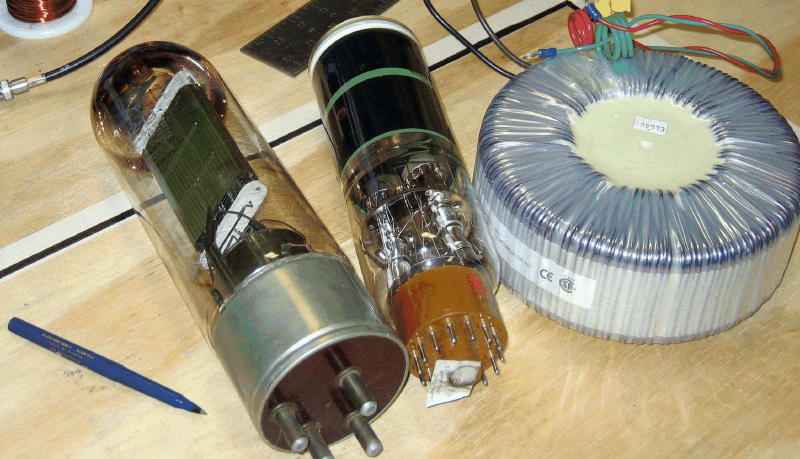

The one on the left looks like it has the base of a 212, but what on earth are those valves?

Audiousername: Sorry to mess with ya. The tube on the right is actually a CRT from some very old piece of test equipment. The one on the left I picked up at a garage sale many years ago because it looked cool. I’ve never actually designed any tube circuits, but if Grey is serious about trying a tube front-end for Le Monstre, I’m very interested in learning!
