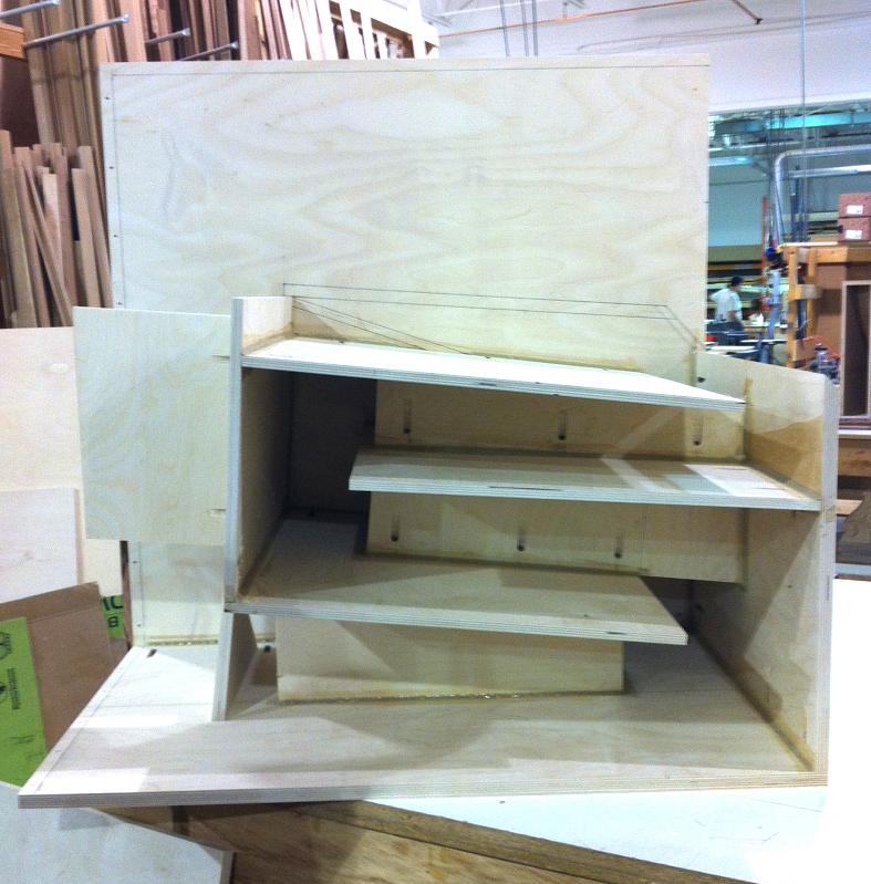

Not holding out. The cabs are getting built but it is slow going this time of year what with the holidays coming up and all. As soon as I have anything worthwhile I will post it. 🙂

Wow fresh PL faintly glistening in the light.
IT'S ABOUT TIME!
Don't lose momentum on us now.
IT'S ABOUT TIME!

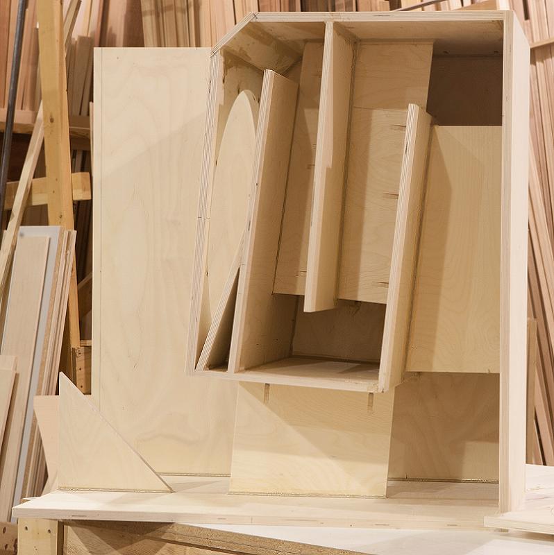

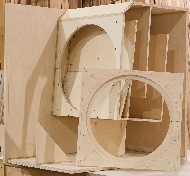

Have you experimented with hollow-ing out the bracing? Many report the lf dropping a bit w/solid braces.
Looking great!
Looking great!
Looking great!
Nah. I am highly dubious that it will make much difference at all. I could be wrong but I would have to see some hard data on it.

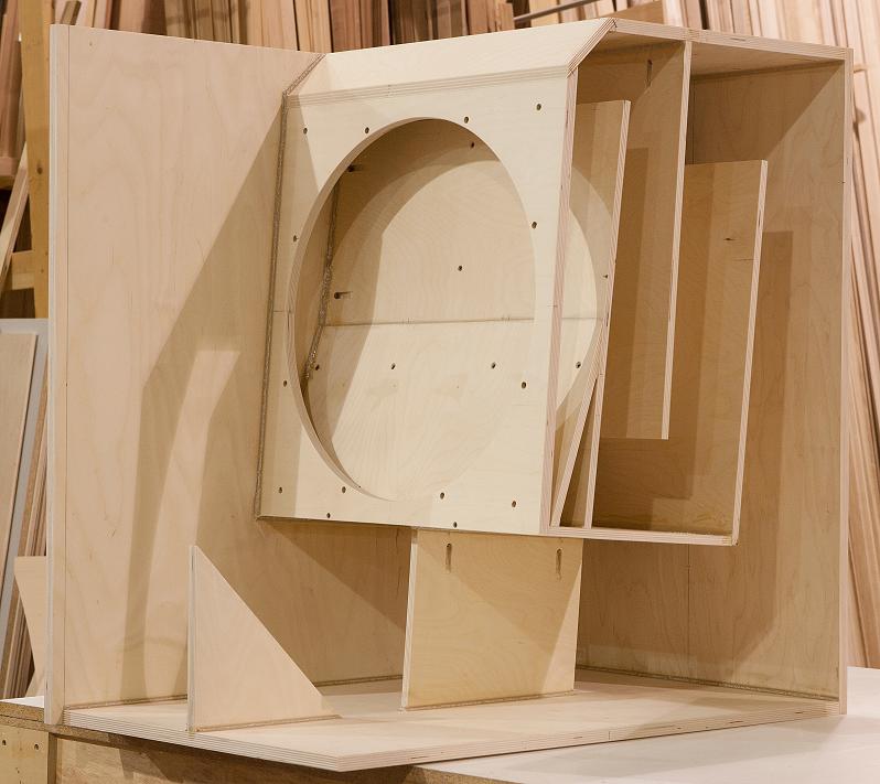

Previous experience with very high power tapped horns and conversation with others with more experience than I has taught me that extensive reinforcement and bracing is an absolute must even with solid construction and the best build materials. Otherwise the cabinet itself will start to make a lot of noise from panel flex at high power.
I'm sure that the guy actually building these is already cursing me as these are a pretty challenging cab design. If I had skeletonized bracing as well he would probably quit on it altogether!
Still in pieces huh? I'm not big on violence but it's about time to go have a "meeting" with the cabinet guy.
Wow looks awesome!

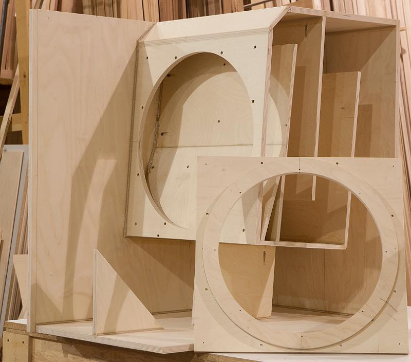

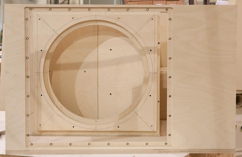

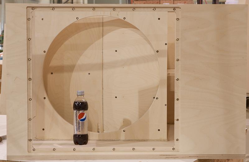

By the way the piece in a couple of photos is the adaptor plate to switch between 21" and 18" drivers. It is a ring that the 18" mounts to that fits down into the 21" driver cutout and the main square piece bolts into the 21" driver's threaded inserts and also has a couple of additional inserts to bolt into at the corners of the original baffle. It will slightly restrict the horn path by one extra thickness of wood but I doubt that it will have major consequences. If I were using 18" drivers from the get go I wouldn't have bothered with it, but I'm using the 21's and also have an 18" Pro5100 I want to try in the cab, hence the adapter plates. I have a short video showing how they mount but I'm not sure how to attach it.
Ahh I was wondering about that I thought it was to add some compression (didn't look like a large reduction, so I was questioning it in my head)
And that makes sense about your design goals. (the maximum output per space requirement) but I, as I'm sure with many others on here, am a cheap bastard!😛
