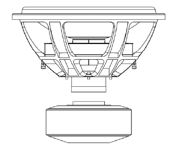

Nice work!
I'm interested by the Sd/S2 compression ratio that you are using. 4.19 : 1 for a 21" driver.
Most designs posted on the forum seem to use a lower compression ratio.
As a rule of thumb I used approx 2.5 : 1 on the Xoc1 TH18.
This seems to be even more compression than the Gjallerhorn 3.88 : 1.
How does the compression ratio effect the performance of the speaker and driver?

In practice these are the compression ratios that seemed to provide realistic clearance for the drivers maximum theoretical excursion and a smooth response. A lower compression ratio in the throat results in larger magnitude variations in response. The cones and motors of the drivers used here are very strong. I had some reservations about whether the aluminum LMS ultra cone would hold up in the Gjallerhorn with its extreme amount of stroke but there have been no problems. If it was going to fold up or fail it would have during testing when it had 130 volts dumped into it with sine sweeps and 1/48th octave stepped sine tests covering 10-200hz. I have been using them with out issue. During the conception of this cab I asked Tom D. through email about his thoughts on whether the 21sw152 would take a 4/1 compression well. He thought that it should be fine. I am confident. I sort of march to my own tune, preffering to think about and try things myself rather than accept others doubts as fact. These are not the cones of yesteryear.

I have been playing with the new toys that have been put in HR. There are some severe pressures developed inside of horns at the throat. At the max 120v input the throat particle velocity reaches 20.7ms at 100hz and the throat pressure reaches 11,122pa at 29hz (174.9db) and at 110hz (>177db). Even less high pressure/power horns easily get up near 170db in the throat theoretically.
While 170db is no joke for our ears, 11,000pa is like 1.5 psi. This is a lot of force over the total cone area, but it doesn't seem high enough to cause point ruptures in materials such as aluminum or quality paper.
I feel like most of the dammage incurred in horns is due to unloading and overexcursion. Horns with compression chambers, and horns with higher bandwidth don't tend to suffer this fate because either the xmax is limmited due to a sealed chamber, or the dammage to the driver becomes plainly audible such as a kick bin with midbass duties.
Does this make sense?

IIRC, at 2 meters, the Gjallerhorn output with 120V is around 130 dB, using the inverse distance law, each time the distance is halved, six dB is gained.
This would put the one meter level around 136 dB.
At the mouth, the level may be around 142 dB (or more, the inverse distance law does not apply in close proximity to the mouth of a large horn) then there is a long horn path within the box that is also subject to the inverse distance law.
Let’s say that horn is 5 meters long.
At 2.5 meters inside, level is 148 dB, at 1.25 meters 154 dB, at .625 meters 160 dB, at .3125 meters, 166 dB, at .15625 meters, 172 dB.
No laws of physics are broken in the above example 😀.
One consideration in high compression, high power horns is air actually becomes non linear at very high SPL, at sound levels of power densities above 1 acoustic watt/sq cm [160 dB] the compression and rarefaction of air becomes progressively non linear.
The maximum SPL that can be achieved in air is 194 dB, increases over 160 dB or so require progressively more power to overcome air non linearity.
I wonder if Hornresp takes air non linearity into account?
