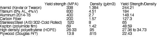

Interesting, stainless steel. I wonder why they chose it - it certainly doesn't have great specific modulus, or thermal conductivity.All of TC's drivers use a stainless former now that is wrapped in a nomex winding with kapton. I had never heard of this either but it seems to work. BTW did you see the pictures of the B&C split wind coil?

Aluminum still seems to be on the top for strength to weight vs. cost.
It would seem the stainless steel has been added to the former for properties other than thermal or strength, it is not much better strength to weight than Kapton.Interesting, stainless steel. I wonder why they chose it - it certainly doesn't have great specific modulus, or thermal conductivity.

IMO where former materials for very high power applications are considered low thermal conductivity is generally the way to go to avoid adhesive breakdown.
Aluminium has the highest heat expansion factor of all and also the adhesive materials that are attached to the aluminium can get in trouble at high temperatures. Even though it has better strength/weight ratio's it isn't the right material so far for using as the piston. Temperatures in VC's of PA drivers can raise above 250 degrees Celsius.It would seem the stainless steel has been added to the former for properties other than thermal or strength, it is not much better strength to weight than Kapton.
