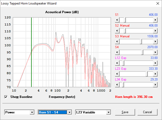

Can I prevail upon you please to do an FR and impedance curve test on your build with the access panel off and the mouth facing into the ground so it's effectively blocked off? Mucking around with the sims suggests that it might be a quick way to boost the efficiency of the cab and sacrifice a little low end - real-world measurements will confirm if that's the case.
What conditions would satisfy your request brother? We're pretty DIY in terms of equipment down here. Could definitely rustle something up for you in January, as time constraints mean I load up the trailer ready for travel and events as soon as the paint drys on the final Othorn, and then straight into a month of work :)
Ideal would be a simple impedance curve (via DATS or something similar), followed by a 28.3V @10M sine sweep FR measurement in an open area down to just below Fb would be ideal, though failing that, an FR measurement done with the mic at least one mouth's width away from the TH's mouth would be fine.
