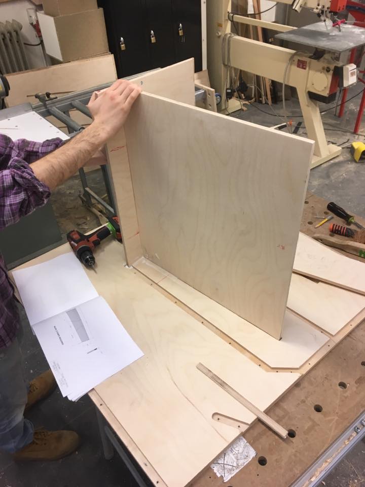

I'm a student and I had the exact same thoughts as yours, the only difference is that my friend had 2 pd1850's laying around, and I was ready to go when I saw simulations.
Dear Josh,

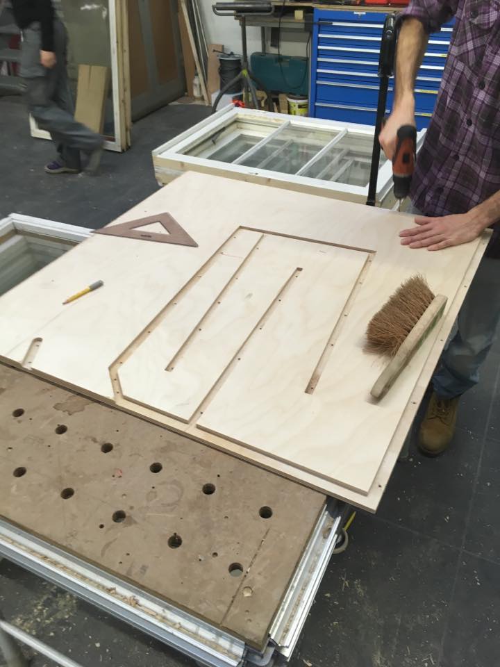

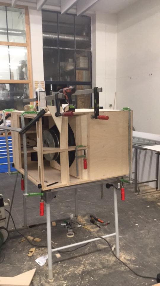

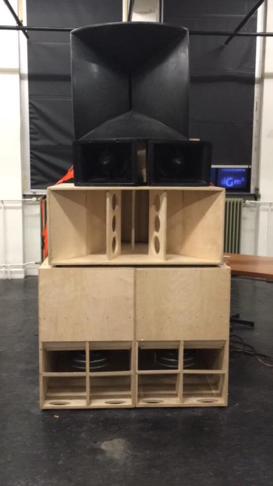

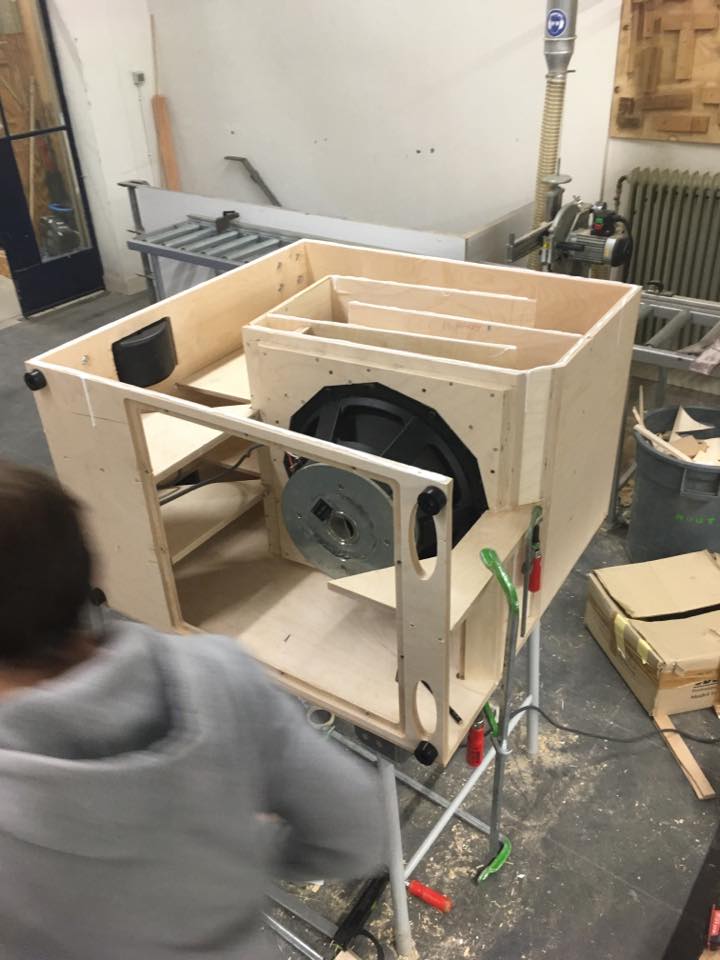

thank you for the plan and this amazing design. It is certainly game changer and beast in it's own league. Here is small report of 2 othorns pd1850 loaded.
I was working 1 and half week on them, most of the time alone.

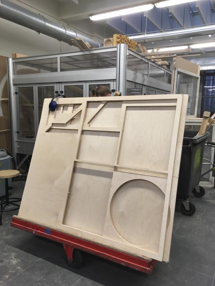

They need a lot of preparation, precision and budget. In my case I was using
CNC in combination with saw for angles, I had to do a lot of adjustments for available CNC machine. For example I draw everything for 2440mm x 1220mm plates, but later changed everything to different format since price was almost 105euros per plate. Later I managed to cut all costs on 50% with smaller plates.
Once when you have everything cutted things start to get smoother. Tricky parts are braces, if you don't have Kreg Pocket-Hole System or simmilar, but there are ways to do them. Also I had some problems with adapter and putting the 20kg driver in, then adjusting it properly and screwing. I had some mistakes because of 1andhalf week thing non stop full power work, but have to say that I'm more than happy with how did it went.

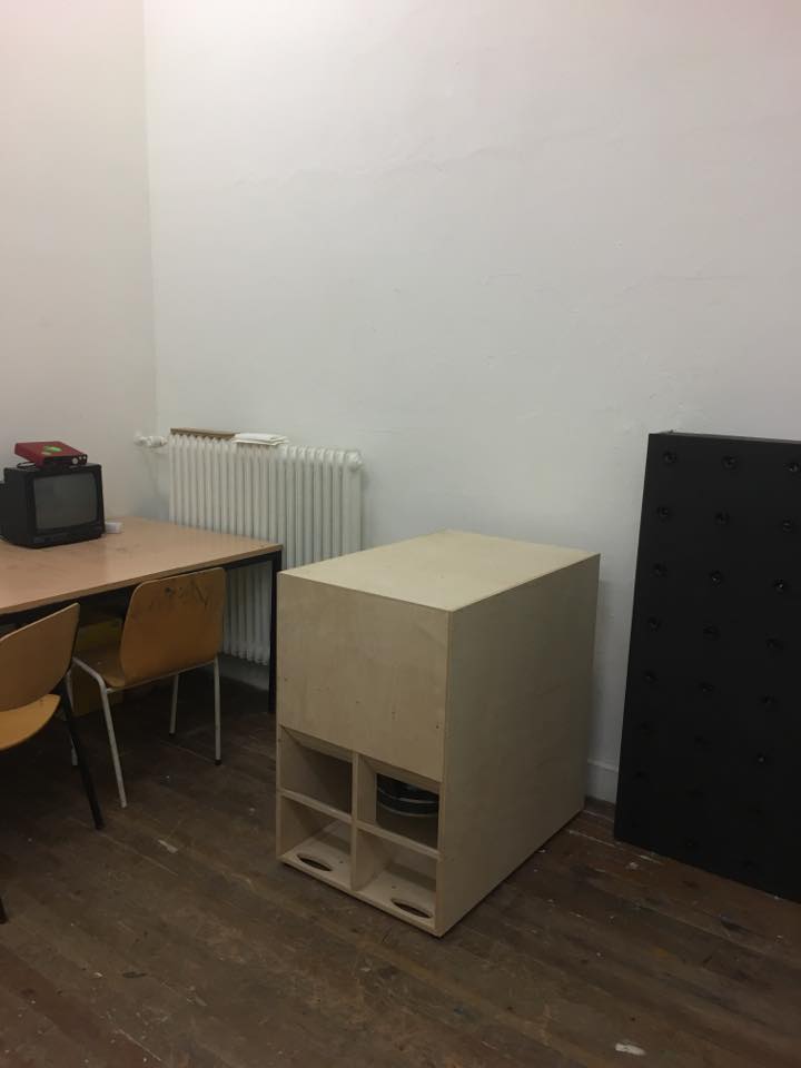

I finished building everything 45 minutes before my academy was closing, I was literally running to do a small soundcheck. I took tannoy studio monitor, hooked it up to xilica processor and crossed them around 80hz over one othorn.
Can't remember exactly what was the first tune ever, but when the first bassline dropped the whole room started to rumble and resonate. They sound deep, smooth and warm, not very physical but again you kinda feel them.
Didn't had any time left and got kicked out.
Next day I was powering a benefit party that we organised on academy, from 10 in the morning until 10 in the evening. Luckily I had some time in the morning to do the setup. I did rawest estimation on delays and gains for my system, without any measurements. Few minutes later my usb cable got unplugged from processor and that was the last time computer to processor connection was working ever gain (haha
Anyway, back to othorns. I was powering them up with Proel HPX4600 each driver on one channel, 850W at 8ohms. I have a plan to put more power with limiters (bridge is 4600 2ohms), but I was considered with 500W Xmax problem from simulations that were published here.
Othorns were really warm and precise, but when I've put the volume up, I noticed that one driver had a problem. I could hear paper cone making strange noise, so immediately I've put it down on amp channel. Trough the day I was listening, putting it up and down, but this strange noise would just appear out of nowhere on louder levels.

There is a problem with driver. This pd's were reconed few times, used on heavy dub sound system, tested in other speakers. Probably when reconed somebody who thought that he is qualified person to do it, he didn't placed it in the middle and reconed driver properly?
Or, on the end pd's are just technically too weak for what we want to hear from this box, comparing to what this box is capable to do when loaded properly.
Once when I will be back in country, I will post some updates and hopefully reliable measurements.
