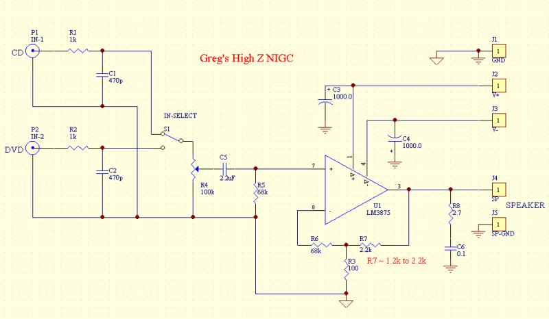

GregGC said:
How about decreasing the gain to around 11-15 instead of 27-30. LM’s have very good frequency response, so a bit more NFB may be a good thing in your case. This way you'll have much lower distortions and you won't have to attenuate the input signal that much (you said you use only 1W). I'm sure the sound will be different and hopefully better. I remember experimenting with the gain and I liked gain of 22 better than gain of 30. It was smoother but not lacking detail.
Now that is something I would be very much interested in knowing about too! Perhaps a switch or even a pot would allow some tests in that area.
I'm very curious to hear what you'd find. I'm looking into building full range speakers with about 94dB/m sensitivity and driving them with GC (no buffers at all).
If you plan on using a NIGC that should be fine. For an IGC that might work if you are feeding a signal that's already buffered and with some output control, like on a Marantz CD player.
If not Joe Rasmussen's explanations on how different pots and different pot positions affect your response on an IGC are in order. A buffer should improve things, tube or solid-state.

Carlos,
I'm planing on NIGC (no buffers, because I believe that they have their own sound, good or bad). A high input impedance NIGC (47-100kOhm Zin) should eliminate the need for a buffer. I have even a PCB that can be used for High Z IGC, NIGC, Parallel or Bridge configuration. Really universal one, using single sided PCB and trough-hole components.
Will see when I'm gonna have time to try it.
/Greg
