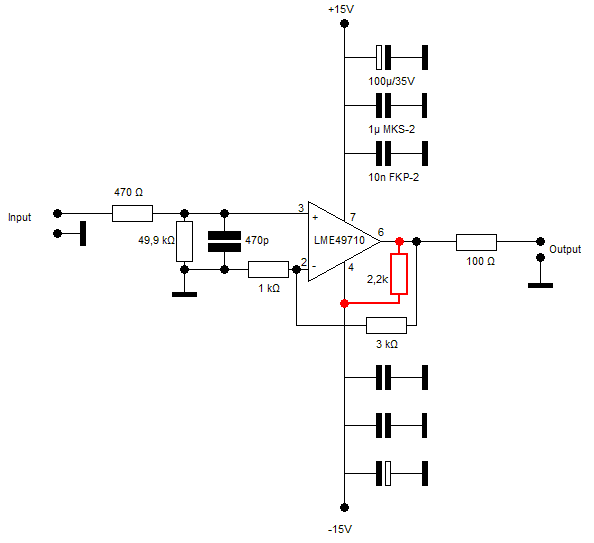

Hello Zei,
Thank you very much for saving the front of my head and face
You were right!!! I measured the correct pins and got 30.1 volts on each op amp! Now I can figure the calculations to know which value resistor!
Any suggestions on which type of resistor or will a Radio Shack cheap one do?
I'll probably be back asking how to check to see if it is operating at what Carlosfm suggested, 5 to 10 ma.

Any cheap metalfilm resistor will proberly do just fine.
When you know that it works you can experiment with different types and see if you get different results.. 🙂
Oh.. i am pretty shure you should calculate the value of that resistor based on the Voltage 15V and not 30V.

Thanks again Zei, can' wait to play!
Looks like a 1.8K will do the trick! I will report back!
Regards//Keith
Regards//Keith
PS does the wattage or tolerance matter on this application?
No.. 🙂
Mmm.. come to think of it,, the tolerence matters. However you could go with a 1% or even a 5% resistor and just messure it to make shure you got the correct value..
You know 0,1% resistors are (Or can be..) up to 0,1% "Wrong"
So, just go with a normal 1% metalfilm and messure it 😉
/Z

Hi Kstr,
forcing an opamp into ClassA is only used due to the inside of the ClassAB output stage being inaccessible to tweaking.
The output stage can be converted to single ended by shutting down either the upper half or the lower half of the ClassAB push pull pair. Often the output stage is a quasi stage and designed for optimum IC characteristics.
When one converts the stage to single ended we end up with a very inefficient ClassA stage that has heat directly proportional to ClassA bias current.
Assume the opamp normally sends a maximum of 2Vac (2.8Vpk) into a 5k load. This equates to 0.56mApk output current. A single ended stage must have bias set to exceed the output current for all normal signals. If you want some headroom then bias must be set to some factor over the normal maximum.
Lets adopt Ib=2mA giving 11db of headroom.
The dissipation inside the IC is now +-Vsupply * 2mA ~=30*0.002=60mW on top of what is dissipated in the earlier stages. We have probably got close to doubling the dissipation in the IC for a Class A output of 7Vac into 5k and no capacitance on the load.

Class A chip
I have run an LM3875 class A with a power JFET on a low volt supply +/- 16VDC and had good outcomes, surprisingly 1st harmonic distortion increased, 3rd decreased and 2nd harmonics increased, but the overall sound quality was somewhat more laid back with good control, I dare say more "tube like"taking the edge off. The LM3875 liked 1.0 to 1.2A bias, I slide from as low as the chips internal to as high as 1.5A output is low around 10W.
My overall thought on biasing a chip into A was not worth it, measurements are worse, dissipation is "HOT" and power output low. The LM overture series all use a well designed internal Quasi output, and pushing them into one side operation is just not worth the drawbacks, IMHO.
