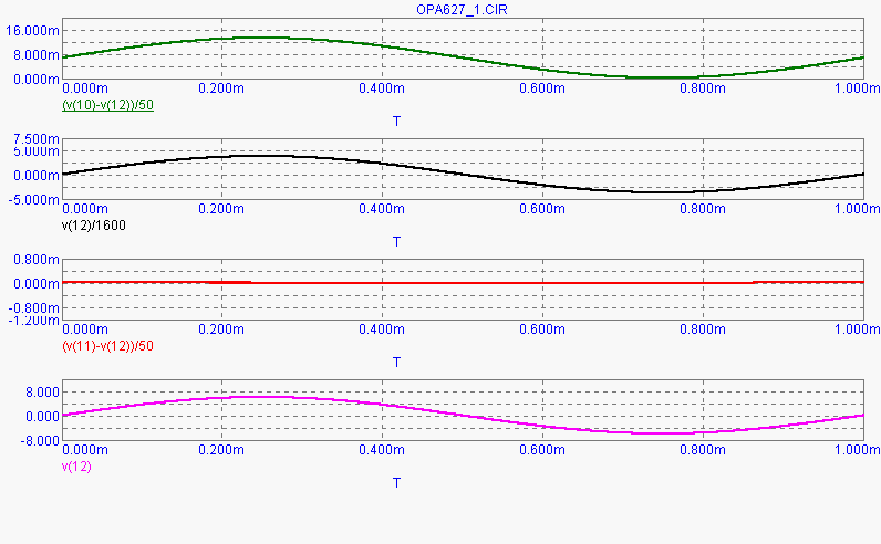

And here are currents through upper and lower output transistor, and output voltage and output current. You can see that only the upper transistor conducts. Increasing input voltage for this load (1.6k) the lower transistor will start to conduct as well. for higher load resistance it will be true class A for all output voltages.

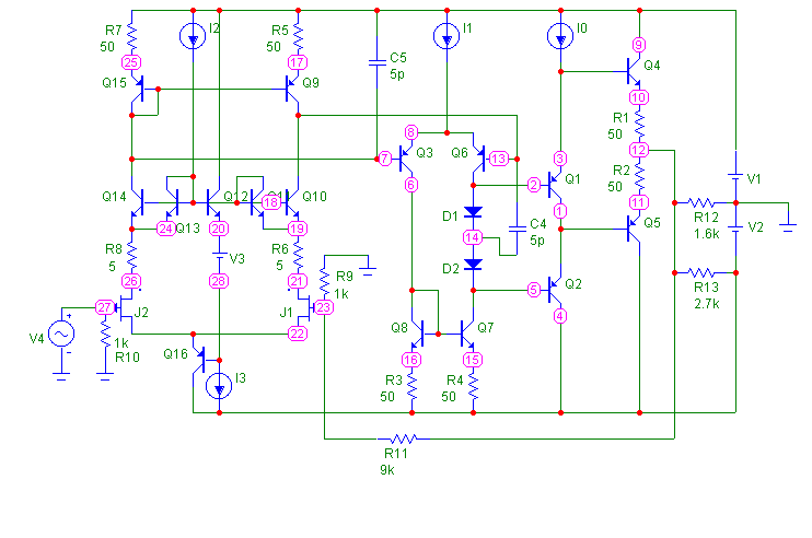

Here is the PSU schematics:
The testamp looks like this:
It is important to say: this amp sounds different than the buffered version. I am sure, bass is better.
But I can not tell you up to now, wich amp I prefer. Give me one or two weeks of comparing them.
Carlos: please dont forget we use different speakers: I drive fullrange speakers in backloaded horns. I NEVER use more than 1W output!
Franz
