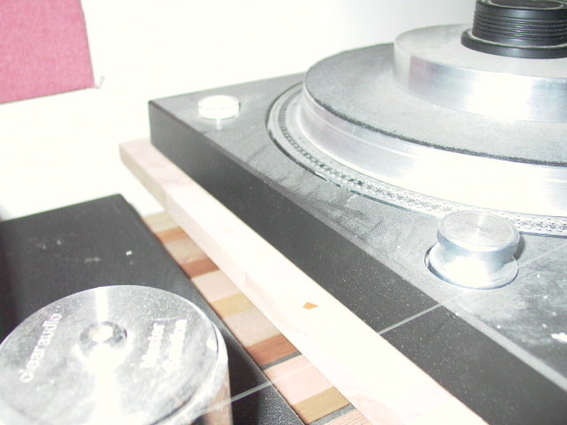

In my case, I use Technics SL110 first model in this kind of product got a most powerful motor, I did modification of it's speed control, separated all the electric part away and changed speed adjuster to a better quality parts, extendsion wires to the motor coil a bit of work 15 wires, after the mods, it stable like a rock. but the platter not a really 90 degree sharp, I use elastic thread as the belt ( elastic material sound really wonderful vs non elastic things with lively), so I cut a really small grove to hold the thread ( no need send to machine shop for cutting just hold a sharp bite firm and hand turn can cut ) weight balance between two platters also will change the sound quality, you can adjust to your own favor.
In this picture, I put a Technics SL-1400Mk2

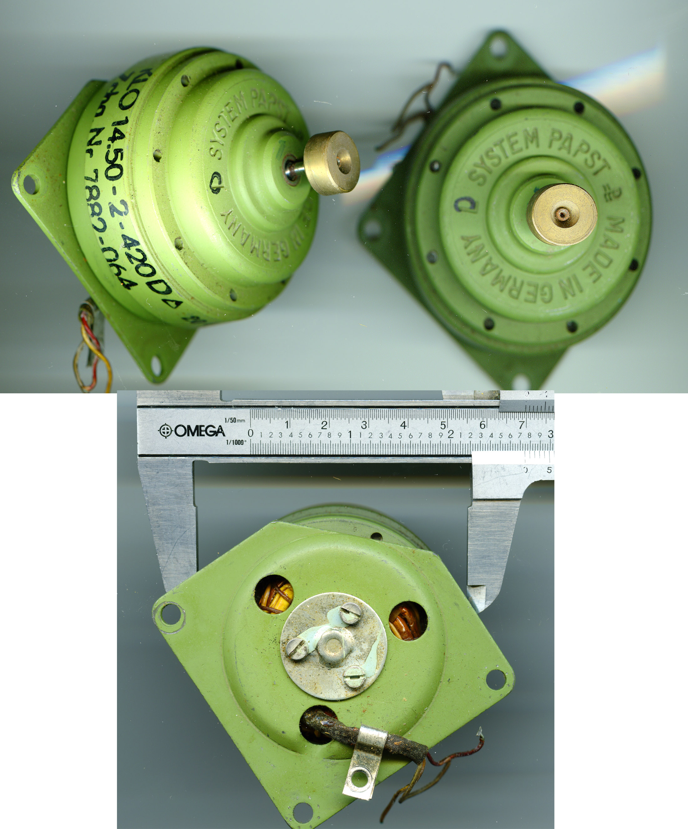

I purchased two green flywheel papst motors from ebay for possible use in a diy turntable project. I know nothing of them and got little info from the seller but the price was right...highest bidder at 16.50 cdn...I am looking to get a power supply/speed control for them...I will try to attach pics for these (original from ebay)...Motor numbers are as follows: KLO 14.50-2-420D followed by a triangle symbol...second line reads as follows: 7cha Nr 7882-064...what type of motor is this AC or DC?..could these possibly be 3 phase?...no indicaton of voltage, frequency etc...any info or help would be appreciated.
3 wire, looks like an AC, 2 phase synchronous. Fire them up with 2x 20v AC with one phase running through 0.22uf of capacitor and see if they turn. Older motors are very unlikely to be low voltage, especially when as heavily built as they are. Looks like they have two matched and one odd colour wire, one would assume the matched pair are the input for each phase and the other the return.

...in Canada we have either single phase or three phase...I am an Electrician but only know some things about electronics...two phase as you say would mean ac voltage applied from two circuits 90 degrees out of phase with one wire for return...house service is nearly always 240v three wire circuit (two hots one neutral)...one hot to neutral is 120v witch is a regular plug in a house...to get 20v two phase sounds a bit tricky from that...maybe a special transformer I have not yet seen??...Any suggestions? I'll also mention the three wires coming from these motors are all different colors...was also wondering if there is a simple test to identify motor type with a ohm meter?
Stuart, it's the same in the UK, single phase and 3-phase. Referring to the motor as two phase just means the two inputs are separated by 90 degrees by adding a small capacitor to one of the inputs.
Just find a 20v transformer, split the output into two wires and pass one of them through a capacitor of 0.22uf. (.22uf is just a nominal value you might find you need anything upto a couple of uf to get the correct lag)
You can't really identify the motor with a multi-meter, measurement of winding resistance doesn't tell you much. You could of course connect the outputs to your multimeter and spin the drive shaft quickly to see what comes out AC/DC?
Thanks sq...if you don't mind me picking your brain a bit more with a few more questions...how will I know when I get the correct lag without the use of an oscilloscope...also was wondering if you know anything about speed control for this type of motor?

Stuart, if you hold the spinning motor in your hand you will easily be able to feel the difference between different lag amounts between the two phases. I can feel the difference between 0.22 and 0.2uf on my LP12 motor quite easily.
Let's find out what voltage your motor needs first, then we can talk power supplies. Different versions are better for different requirements, you also need to consider the tolerance/drag of your turntable bearing and platter load.
If you motor need under 60v then I can wholeheartedly recommend this Roehren-und-Hoeren :: Thema anzeigen - Luxusnetzteil für Synchronmotoren mal anders It was no use for my needs, 120v but it genuinely is the most accurate and adjustable AC controller you can DIY.

I just happened to have two identical ones but I have also used several turntables with speed adjustment such as the PL-570. Basically, any turntable with flat rim platter and speed adjustment will work. Models to recommend are Technics SL-M3, JVC QL-F6, Pioneer PL-570 & PL-550, etc... Or you can always add a plate on top of another turntable acting as a pulley, in this case the ubiquitous Technics SL-1200Mk2 will work great as a turntable "motor-pod." Get one at second hand price and it will beat most fancy motor-pods costing an arm and a leg. And it will make you pay attention to motor quality and realize all this attention to fancy shiny blig bling thick platters is misguided. Get the source of rotation, the motor, right and with quality, the sound will benefit. The two turntable approach saves me the trouble and money to find a high speed motor with proper speed control electronics - too much hassle for me. I am quite satisfied with the result.
In this picture, I put a Technics SL-1400Mk2 with a broken tonearm to goo use. I added flat rim platter, a salvaged part, on top of the Technics platter acting as a pulley. You can even add an idler wheel in between the two turntables. The passive platter is from an Empire 208 belt-drive turntable.
