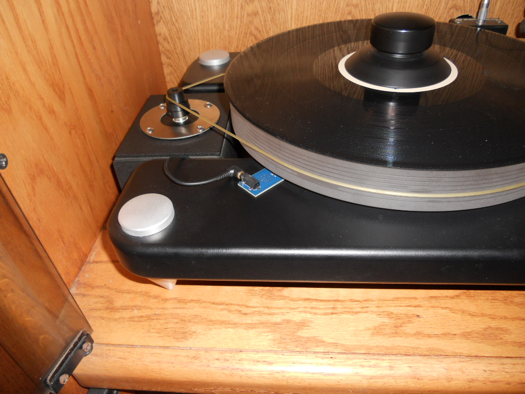

FYI, I'm using a mirrored surface on the outside edge of the platter with an LED emitter/detector pair as the sensor.

Thanks for the comment. I thought about using hall effect transistors and a small rare earth magnet on the platter. It would probably be easier than the emitter/detector pair and a little less obnoxious looking than a ¼" x ½" piece of mirror on the platter. I never tried it, I was concerned about the trigger point being too ambiguous; with the strobe output on my device, I could certainly look at it to see how consistent the trigger point is. As in one of my previous posts, the trigger has to be within ~0.5MILs to maintain the desired resolution. I'll have to give that a try.....
I'm also looking at optical imaging chips, VD5377 from ST Micro and ADNS-3050 from Pixart Industries. Both mfrs provide lens assemblies to go with the device, but they are built on the premise they will be used in mice and have a very limited depth of field, ~2.4mm max although the surface to lens spacing is closer to 6mm. I would have to construct my own lens assembly to handle the greater depth. The imaging chips would also provide more real time data.

I spun some new sensor PCBs with a Hall Effect device that fits rather nicely under the platter and the performance is as good if not better than the optical sensor. Another nice benefit, I can leave the sensor powered up and detect when the platter begins to spin, so now the tach goes to sleep after 5 min of inactivity and automatically comes back to life when the platter moves.
