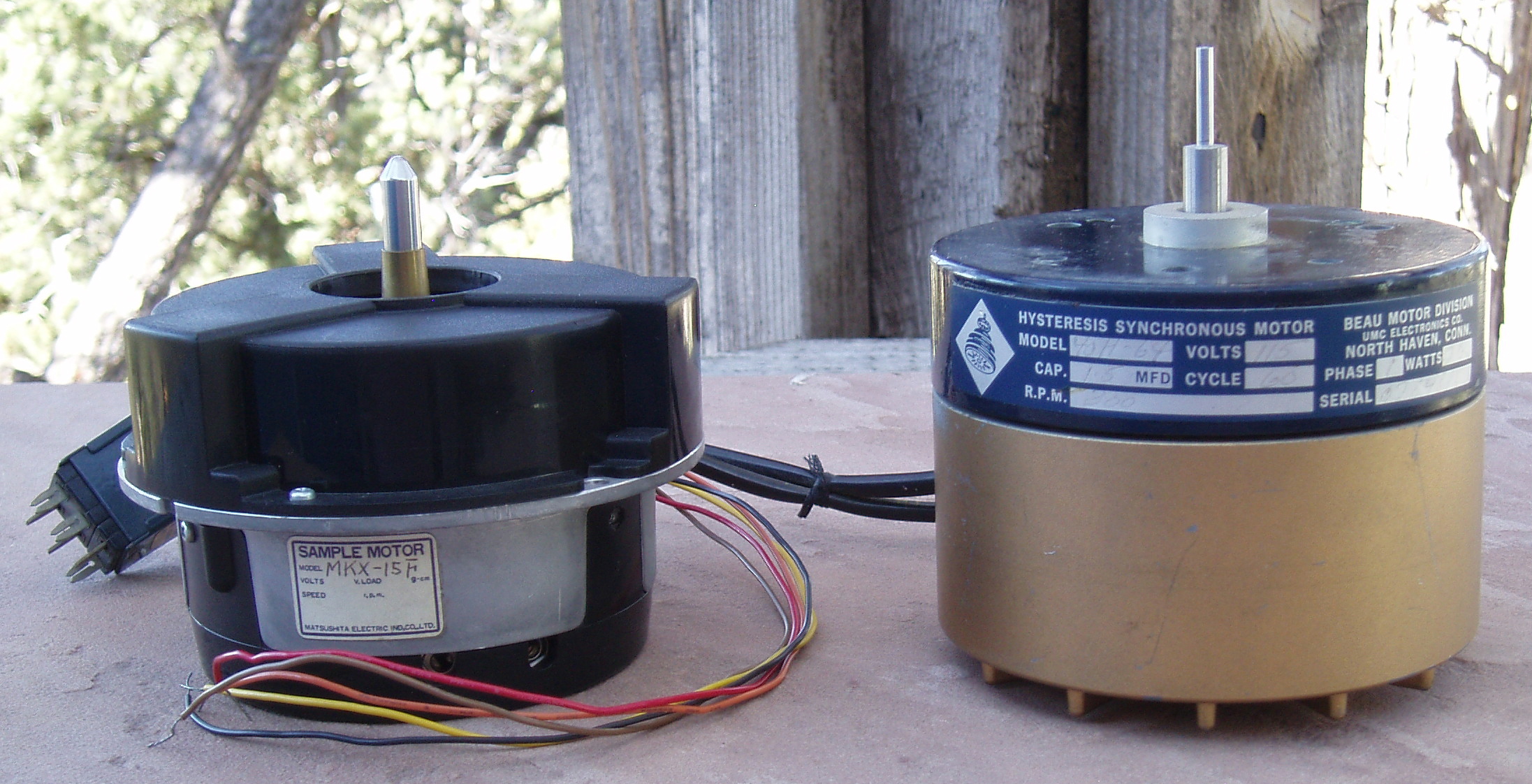

Hello everyone,
In addition to the direct drive motor, a capstan motor from a junked
professional studio tape recorder could be used. The attached picture
shows a Matsushita direct drive motor and a Beau capstan motor.
The direct drive motor woul need a support bearing near the top in my
opinion. The capstan motor would be ok as is because it was designed to take a side load. The capstan motor is "stubby" which would help to keep
a low profile in the overall appearance. Most of the capstan motors in
professional studio tape decks are much taller. That would be ok if one
were to design one of those tall turntables.
Ralf
