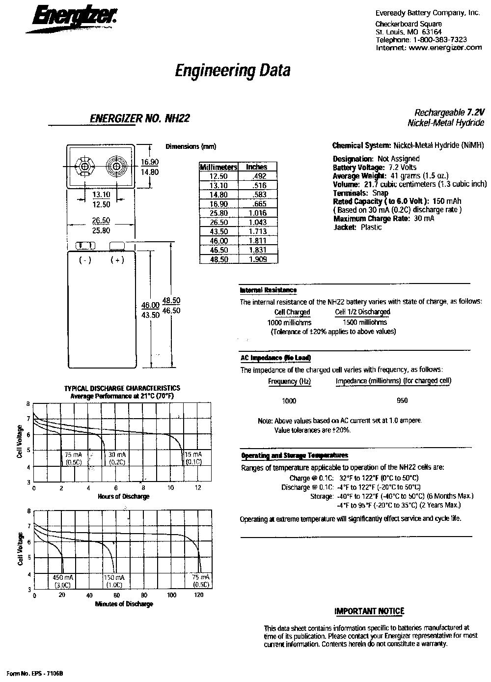

Left the amp charging the batteries all night and measured them with a dmm. BT1 is giving 9.77v and BT2 is giving 9.31v. I don't have a clue if this is normal.
Anyway, they are Philips Rechargeable accu 8.4V NiMH, 170mAh. They seem within spec regarding the BOM.
Any thoughts on this?
Thx for the explanation Turbon.
NwAvGuy does include a brief on recommended batteries in the O2 details, though I might have imagined 7.2V types were more common.
raspunsen, I'm currently using the type shown below. With my Grado SR80s they'll run for only a few hours at most before needing a recharge.
I have a mod in the works that addresses run time no matter what PP3 is used.
7.2V pack is more common than 8.4V... but not at all for 9V/PP3 battery layouts.
I think everyone knew that.
Anyway, so what's killing off the batteries in the O2 faster than expected? What would the effect be of having added resistence in the battery circuit, in theory AND in practice?
