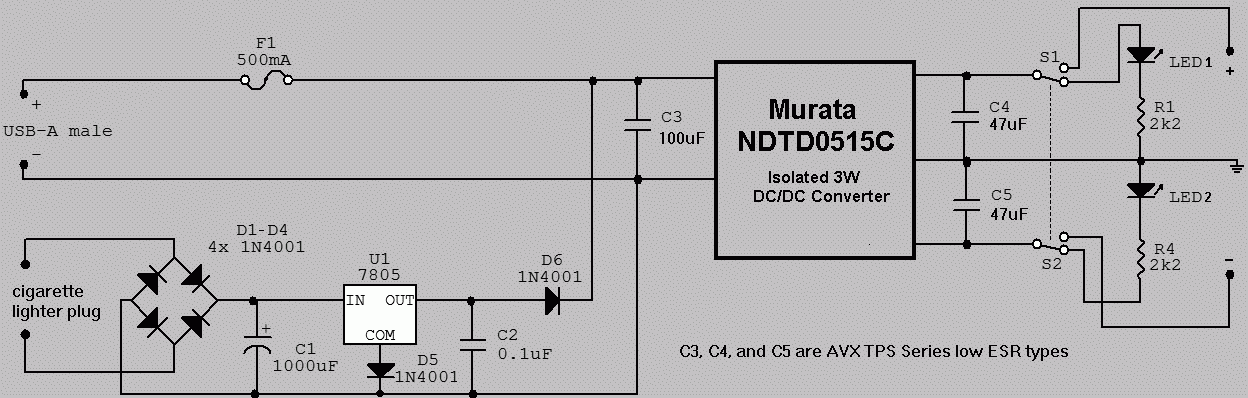

My (untested) version of aux O2 power
This is the parts values and schematic for implementing auxiliary power for the O2 using a USB port or a 12VDC lighter socket. I'm deciding on a suitable case still and the circuit hasn't been built. Its main purpose is to recharge the O2's batteries, but the converter can output about +/-100mA. It could power some headphones.
It's nothing spectacular or out of the ordinary. I just want it to work, and I think it will. Corrections will be most appreciated.
The switched LEDs are to keep a load on the converter, and provide a visual indication to plug-unplug without a live TRS plug. TRS seems the most practical connection. The socket is on the back panel (there's plenty of room in the B2 case above R1 & R2) using a grommet insulator.

The main purpose of the bridge rectifier is to make that input polarity insensitive. + will be + and - will be - no matter how the DC is connected. I put a large value cap across it, so the lighter plug input is quite versatile. It can accept AC also, up to about 24VAC peak (higher voltages are possible even, but then the reverse voltage seen by the diodes and the power dissipated by the regulator has to be considered).
D5 raises the output of the 7805 by a diode drop. That offsets the D6 drop (D6 blocks DC from entering the regulator output). In practical use, D6 will likely have a higher voltage drop than D5, so perhaps two diodes at the D5 position would be an improvement. Or it may not matter much; the DC-DC converter is rated at 4.5 to 9V input.
It should be mentioned also that the +15VDC output connects to the cathode of D3 on the O2 schematic. The -15VDC connects to the anode of D4 on the O2 schematic.
