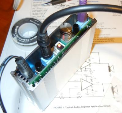

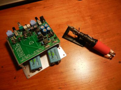

Finished my O2 (minus faceplate)
Just assembled my O2, and the results are nothing less than spectacular... an awesome holiday present to myself without breaking the bank. Thanks, NwAvGuy!!!
