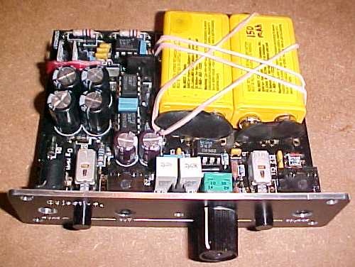

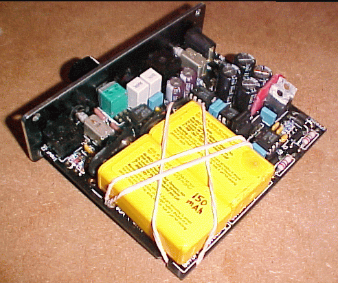

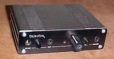

Here's my O2
a) Gain set at 2.5x and 5.5x. With the sources & cans I've used so far, that's turned out well. The volume for most listening is about one-third to two-thirds. Need to find the aluminum insert for that volume knob. It's around here somewhere.
b) Working with this photo, I noticed the 2068 wasn't fully seated. Fixed that. You'll also see I used plain ol' 9V battery connectors. That's probably better shown in the third photo. I had also, at one point, fashioned a pair of regulator heatsinks that extended horizontally toward the rear of the enclosure. When I received the enclosure, I found I would have to replace the hardware to make it fit. I just jetted the heatsinks instead. I did place a piece of thermal insulation between the regs and the caps. That's the red piece you see.
c) I don't have the permanent batteries yet. The ones in the photos are some 7.2V 150mAh that I had laying around. I made small hooks from clipped off diode leads and soldered them into the B2 battery terminal hole near C9 and the two mounting holes at either side of the batteries. I also made 2 small notches at the corner of the PCB to hold the rubber band and allow easy in-out of the board. Works great; I can shake the case and there's no rattle at all. I used the battery connectors because it should make it easier to install my planned mods.

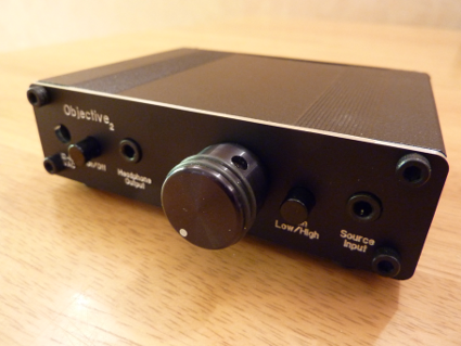

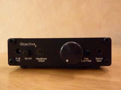

Great new amp. My front panel arrived today so posting some piccies to share the love.
I've gone for the blacked out ninja version rather than the black and blue 😀
Sweet, but are we going to see any pics of this ninja version? 😉
Looks good. Seeing yours makes me think I do need to round up some black panel screws. Is something attached to the bottom or is that just for the camera pose?
