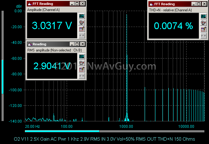

The new files are posted in the O2 Resources section, I've revised the THD vs Output plots in the first O2 article, and I've also added some input overload plots also shown below.
The first plot is running on batteries with about 80% charge showing 2.0V input, the second is on AC showing a very "hot" 2.9V input. In both cases the total distortion from both stages combined is still negligible (see the captions for more details):
