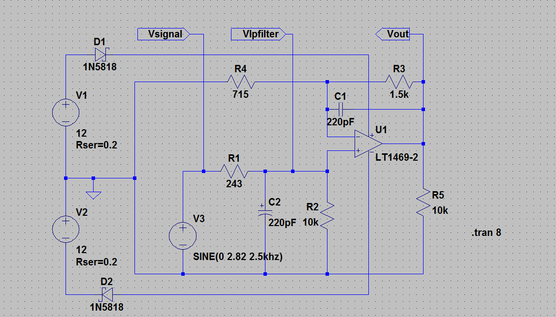

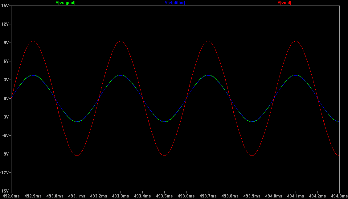

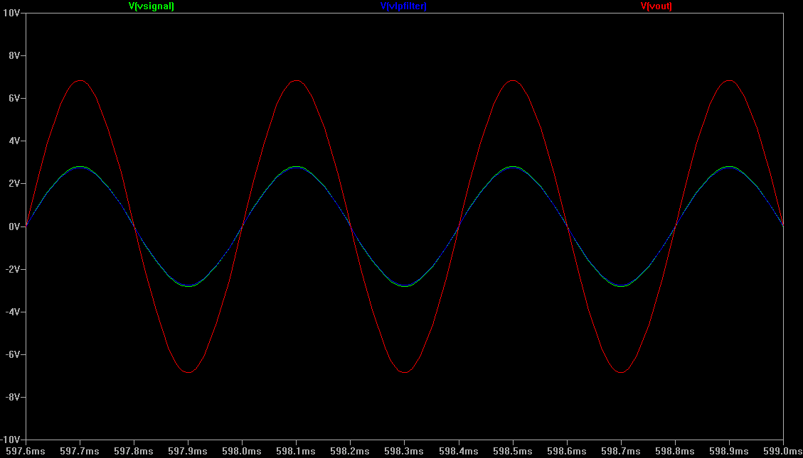

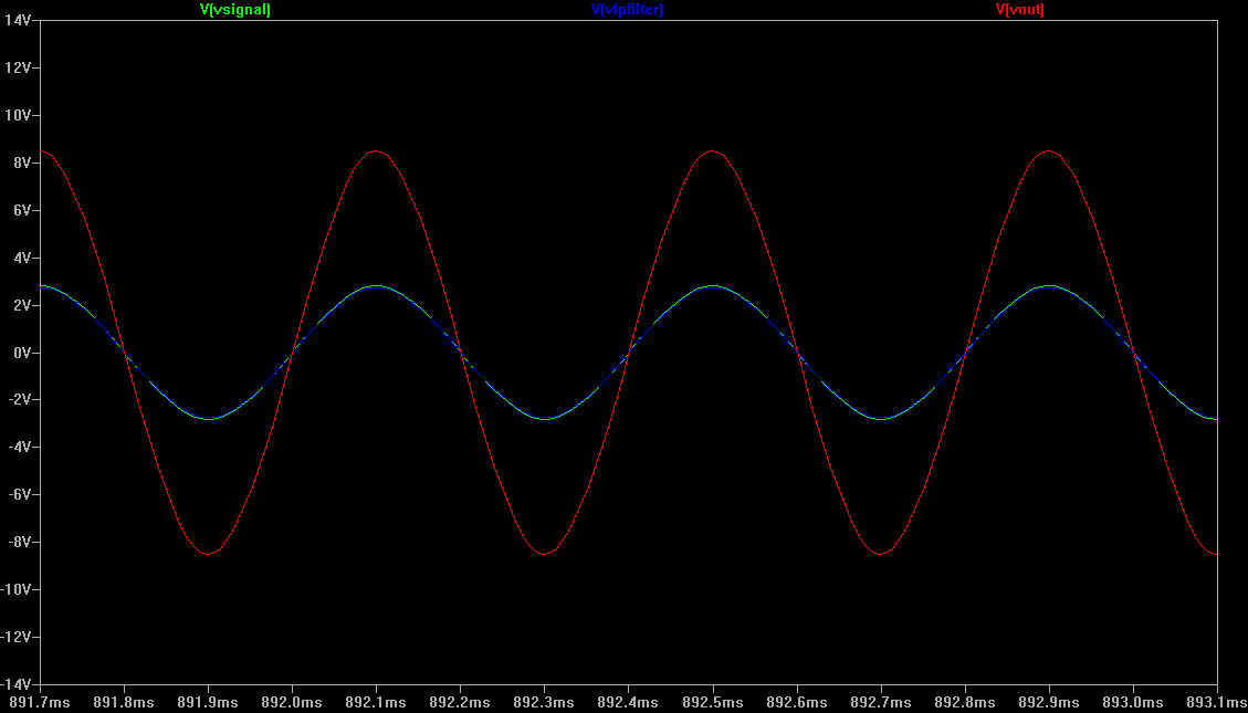

gain and graphs
Here is the gain issue graphically.
The LT Spice library doesn't have the njm2068 of course. I've substituted in the LT1469-2 which is one of Groner's suggested upgrades for an NE5532. The LT1469-2 is good for up to +/-18v also, so it works just fine to show the clipping issue at 12v vs. gain and input signal level.
All plots are with +/-12V rails, assuming the "home" ac-powered case. The circuit is just for one channel since both are identical, of course. The legend for the plots are at the top of each and the file names (hover the mouse over each) shows the specifics.

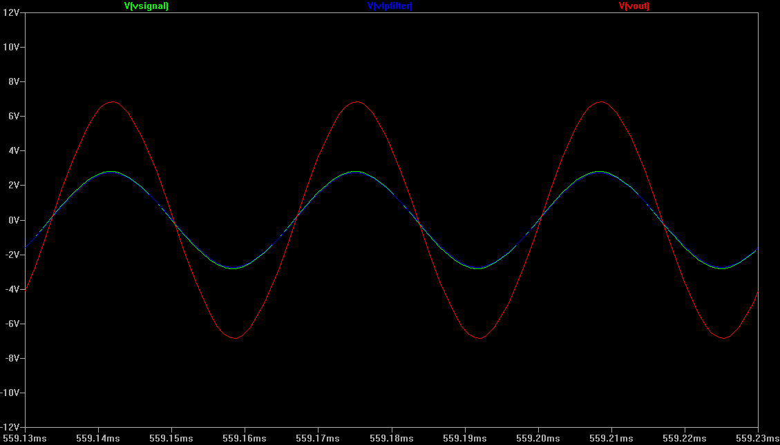

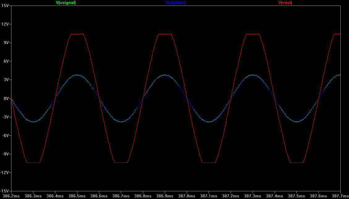

The first set of plots are with the original 3.1x gain setting with the 715R resistor. The first plot is with Vin = 2Vrms = 2.82Vpeak input at 2Khz. No clipping (the output is red). The second plot then is for Vin = 2.7Vrms = 3.82Vpeak input at 2Khz. The clipping on the output is apparent.

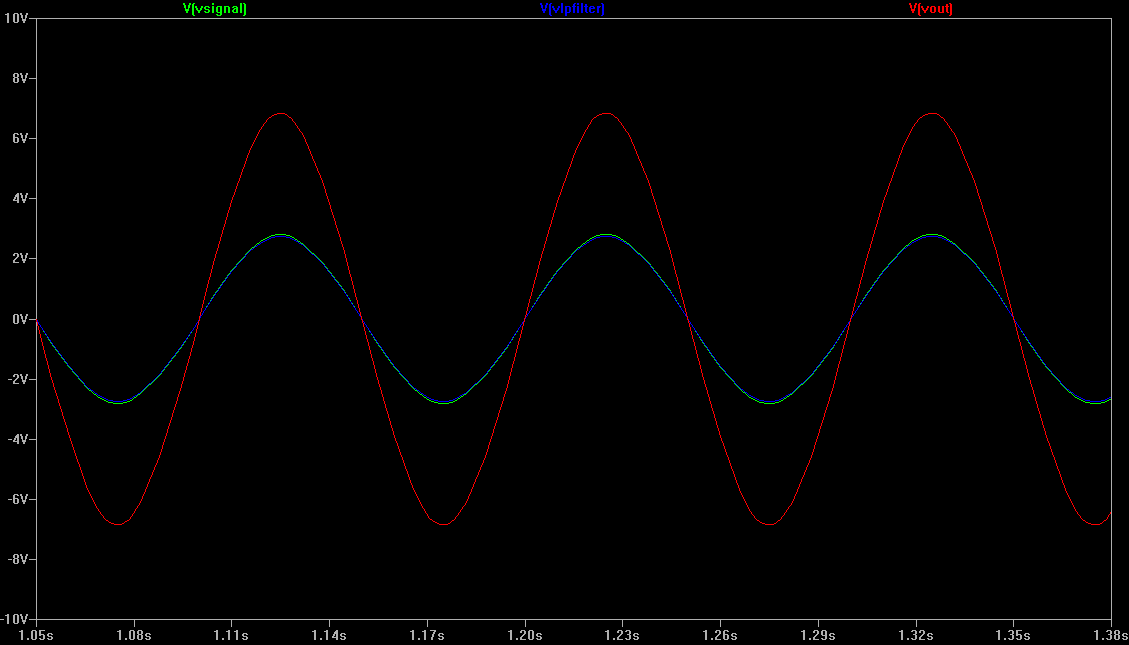

The second set of plots are with the new 2.5x gain setting with a 1k resistor. The first plot is with Vin = 2Vrms = 2.82Vpeak input at 2Khz. No clipping. The second plot then is for Vin = 2.7Vrms = 3.82Vpeak input at 2Khz. No clipping this time.
The final two plots are the new 2.5x gain with 2Vrms in at 10hz and 30Khz.
O2 signal path 1st stage 2.5x gain 2.5khz 2.7Vrms in.png21.3 KB · Views: 221

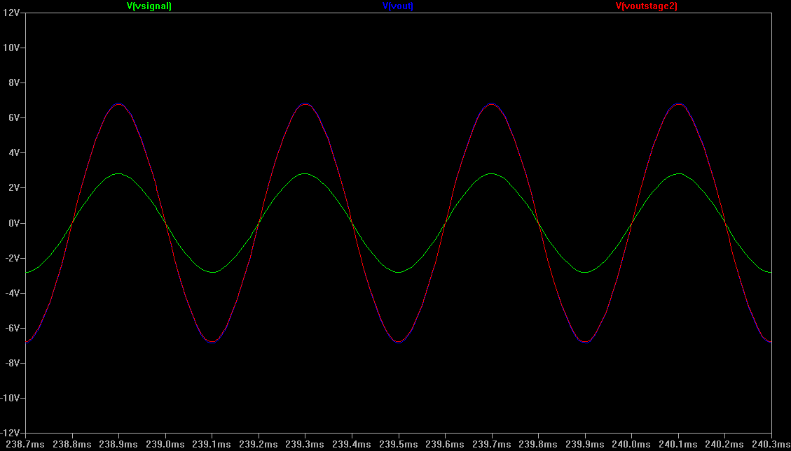

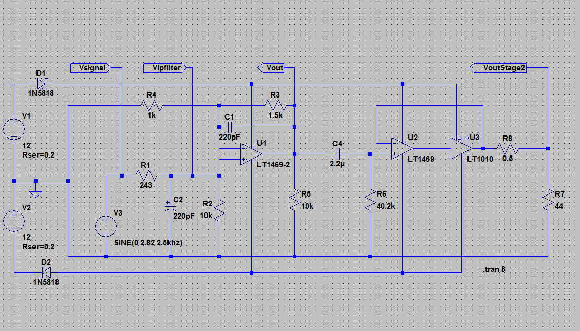

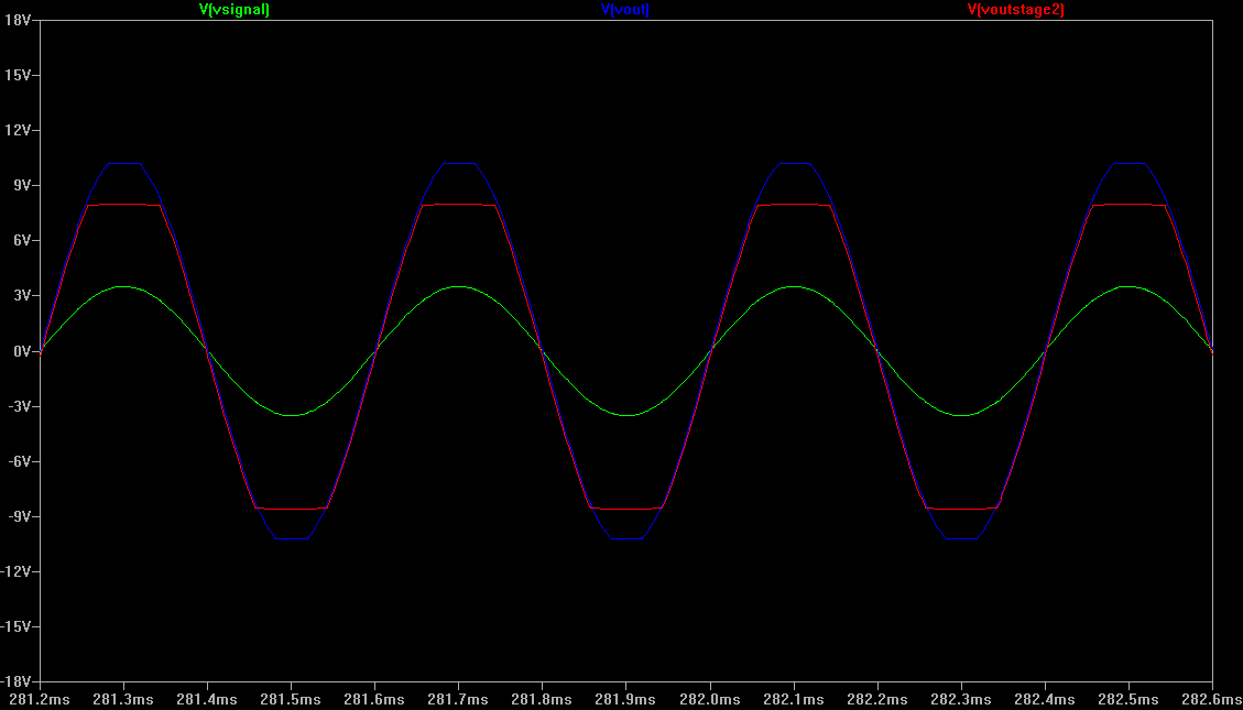

added 2nd stage
...and here is an approximation of the O2 second stage tacked on to take a look at clipping behavior end to end. I've had to use Linear Technology substitutes again, due to lack of njr models, from the LT Spice library.
The LT1469 (single, without the -2) is used since it is unity gain stable (-2 needs minimum gain of 2), driving a LT1010 150mA current buffer. The single LT1469 + LT1010 150mA pair "replaces" the two parallel njm4556 in one channel for simulation purposes, which are 70mA x 2 = 140mA.
The volume pot is on "full" in both plots for maximum signal transfer. The load is a resistive approximation of my 44R pair of Shure SRH-940s. 😀
The first plot is of the original 3.1x gain is used with the 2.7Vrms input to plot clipping behavior end to end. The red is now the output of the second stage and blue is the output of the first stage.
The second plot is with the new 2.5x gain and a 2Vrms signal, showing no clipping end to end. Notice here the red output plot is sitting pretty much right on top of the first stage plot, a very good thing in current-buffer land. 🙂 Note on the second plot that 7V peak is 5Vrms, which would be 5^2 / 44 = 550mW per channel, something my ears would never forget. 🙂 Plenty of output at 44R with 2Vrms in and the first stage gain of 2.5x.

First, thanks agdr for the sims! I based my numbers off real measurements. On AC power it's pretty easy. On battery power, however, the clipping point is battery voltage dependent. But we seem to be pretty close to being in agreement.
