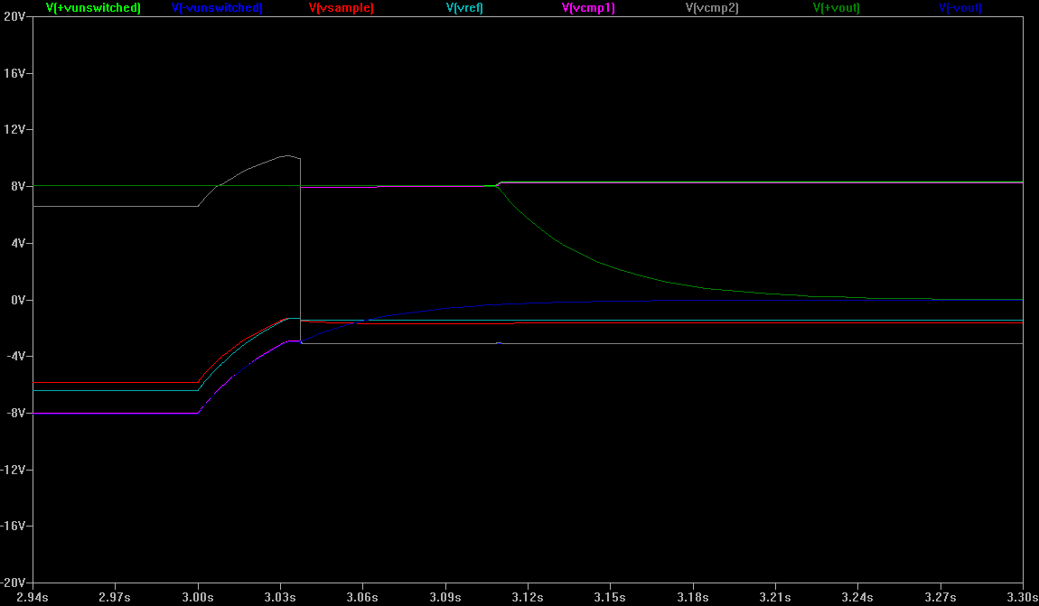

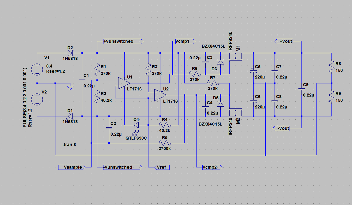

Here is a suggestion. I'm kind of a reliability freak and I just know what is eventually going to happen to the Vgsmax = 25V mosfets over time operating at Vgs=24 +/-10%. I see some of the Sanyo datasheets actually putting it in writing these days, to the effect of "operating the device near max parameters, even if not exceeding, can result in shortened life. Contact your representative".
I would suggest adding 15V zener clamps between gate and source. That would allow the use of more standard - and available - Vgsmax=20V parts, plus would keep the Vgs a good 5V under the max. Still works, as the plot shows.
True some current would now flow through the zener, adding to battery drain, but it is only around 11uA for batteries or 33uA for the 12V rails. I'm not certain how much of an issue zener noise injection into the rails would be in this configuration - something to consider.
Another interesting way to handle the Vgsmax issue is make the mosfets double as cap multipliers when operating. Swap the two mosfets (n channel for p), flip them around to be source-follower, then swap the positions of r6/c3 r7/c4, swap the comparator outputs going to the gates, then adjust up the capacitor and down the resistor to maintain the same rc constant. A gate-source zener would still be needed since when the comparators toggle the output caps would still be charged up to the rail, with the other rail now on the gate. May also be an issue if the amp output is shorted with exceeding Vgsmax.
Whoops - brain hiccup in the above about the cap multiplier option. That isn't going to work with the mosfet Vgs threshold dropping the output voltage down significantly. They would have to be BJTs and that would introduce significant base current draw. Nevermind...
So the sole suggestion then is the addition of the 15V gate-source zeners in the existing design.
Yeah, that's bothered me a bit as well. But, technically, the MOSFETs I've specified are within spec. The diodes drop the 12 volt rails a bit which further helps. And there's nothing to cause transients much above the rail voltage.
The other good news is I've run MOSFETs rated at 20 Vgs(max) with zero problems--both P and N channel. For the first prototype that's all I had in my parts collection so that's what I used and they worked flawlessly. That might be just luck, but it's at least encouraging the Vgs(max) spec doesn't seem super critical.
The reality is the PCB layout is really tight. The PCB drawing doesn't show the routing, but when you consider all the traces, there's just isn't much room without making other compromises. Besides zeners, a resistor divider will also work and part of the dividers are already in place.
I'll look at the layout again and see if I can find some room. But, at least based on everything I know so far, it's not likely to be a real world problem even if it's not ideal. With the diode drops, and regulator tolerances, the design is still within spec.
I was wondering if there would be enough space for 2 more diodes. I'm sure the circuit will work fine in the short term - maybe even go years without a problem - it is just a long term reliability thing. Hopefully you can find a way to wedge in the diodes, or resistive divider. The divider is a good idea. Hadn't thought of that.
I have a suspicion because the gate current is limited to 88 microamps worst case by the large 270K resistors the gates might be protected from damage even if the junction does start to break down. Power MOSFETs, except for ESD, are rather beefy and robust devices. That gate area is relatively large. But I don't know enough about the semiconductor properties to know for certain if 88 microamps is too low to damage the gate. But that would help explain why the circuit worked flawlessly even with 20V parts.
It's also worth noting C16 and C21, in combination with the 270K resistors, form a low pass filter that will tend to isolate the gates from any spikes or brief transients.
Good question. Seems that even just static voltage near or above max will eventually do semiconductor parts in. But the gate filtering is bound to help.

Thanks agdr. I'll try to figure out if there's room. If so I'll add them as an option. I'm not sure if you read my paragraph on dissipation in the Circuit Description section of last article? I did the math and made several measurements of power-in vs power-out. I also measured case temps. For anything but sinewave testing it's a non-issue unless perhaps the amp was operated in an extremely hot ambient environment, on AC power, into a worst case load at clipping, etc.

On the zeners/resistor g-s clamps, I know it looks kind of cheesy and ads some lead inductance, but maybe they could fit if put vertically, on end? Just a thought.

@agdr - I did think about vertical, and it can be a useful last resort in some cases. But, in this case, I'm sure others would complain or criticize the O2 for having vertical components. Vertical axial parts are also a bit less robust and DIY friendly (they can short out against each other or other parts if not properly bent/installed, the polarity is less obvious for diodes, etc.). If you're really bothered by the Vgs issue and plan to build your own O2 you can certainly add your own gate protection.
At this point I'm trying to avoid significant changes to the PCB unless there's a *really* good reason. Otherwise I'm going to have to do yet another prototype spin of the board before releasing it, build another amp, all the testing, etc. And that's going to add a lot of work, more expense, and a few weeks of delay. To try and make room for the gate protection means pushing several other components around, including some fairly critical power supply and grounds tracks.
