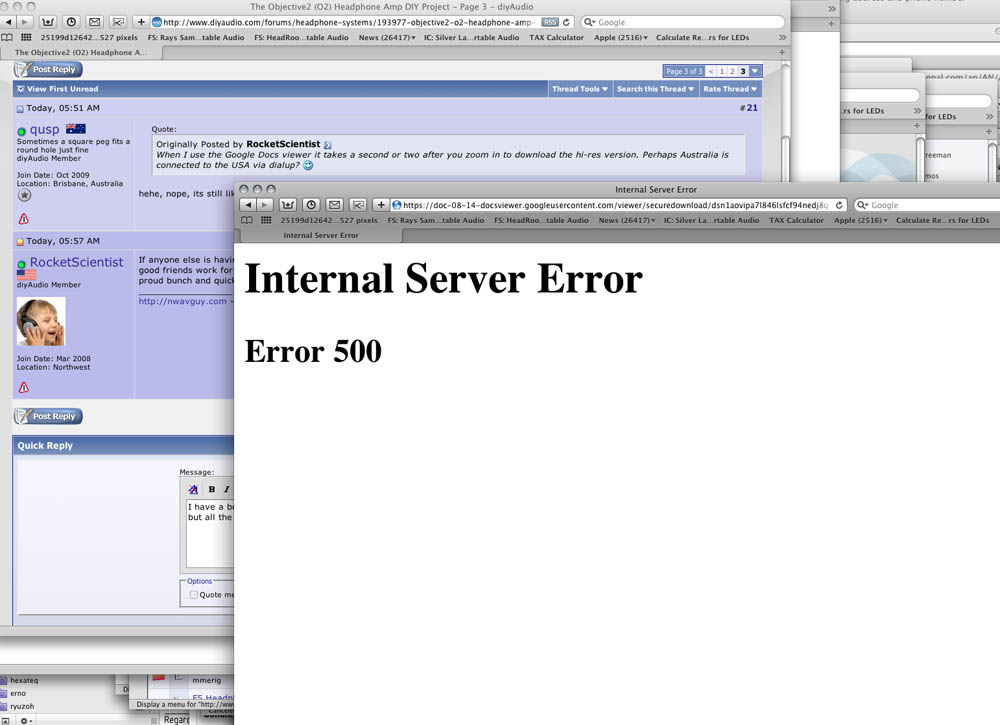

I have a boatload of windows open in safari which does tend to bog it down memory wise, but all the same there does seem to be something a miss.
just went to download it and couldnt (see below), looks like theyve got some honorable defending to do

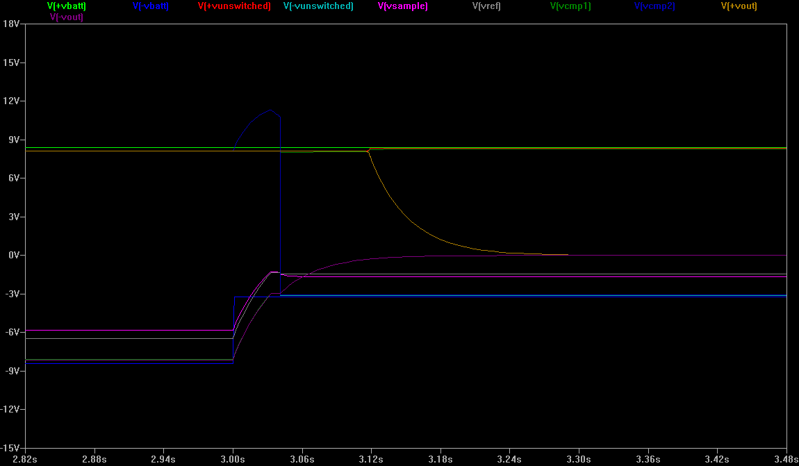

Here is a failure voltage drop spice sim on the negative rail with 8.4V constant on the positive rail. Negative rail goes from -8.4V to -3.2V at 3 seconds in. The converse parameters with the drop moved to the positive rail with the negative rail held constant produce similar results.
I've subbed in an LT 1716 for the comparators from the LT spice model base. It is rail to rail, over the top, and good from 2.7 to 44v. Yours is better suited with the 2V min supply but this does the job for sim. IRFP240/IRFP9240 subbed in for the mosfets - so in real life they would gate-source overvoltage short when operating. 😀
The legend is on the top. Blue -vbatt is the negative rail drop at 3 seconds in. Orange +vout is the positive rail shutting down, while light magenta -vout is the remainder of the negative rail shutting down.The green trace for the output of comparator 1 is kind of hard to see, but the other blue trace is the output of comparator 2 toggling from high to low. You can see the bright magenta voltage divider sample voltage crossing over the grey LED reference voltage at about 3.05 seconds, with the comparator(s) toggle happening just a hair after it.

@agdr Thanks for the sim! If I'm reading your graph correctly, you show about a 60 mS lag between when each crosses 3 volts? I don't think that's true in real life but I'd have to double check. It turns out that's the critical parameter. Below that is where the audio op amps can become unstable. As long as each rail is above |3| volts the entire audio circuit doesn't care how unbalanced the rails are.
You are right about the lag, but I've subbed so many parts in here just to fit the LT Spice model base that the real thing will likely be different.
Pretty impressive design, though! It does work for a fault in either rail. I haven't tried a combined rail fault, but just logically since its all between the rails that is just a change in point of reference. Should also work just fine.
