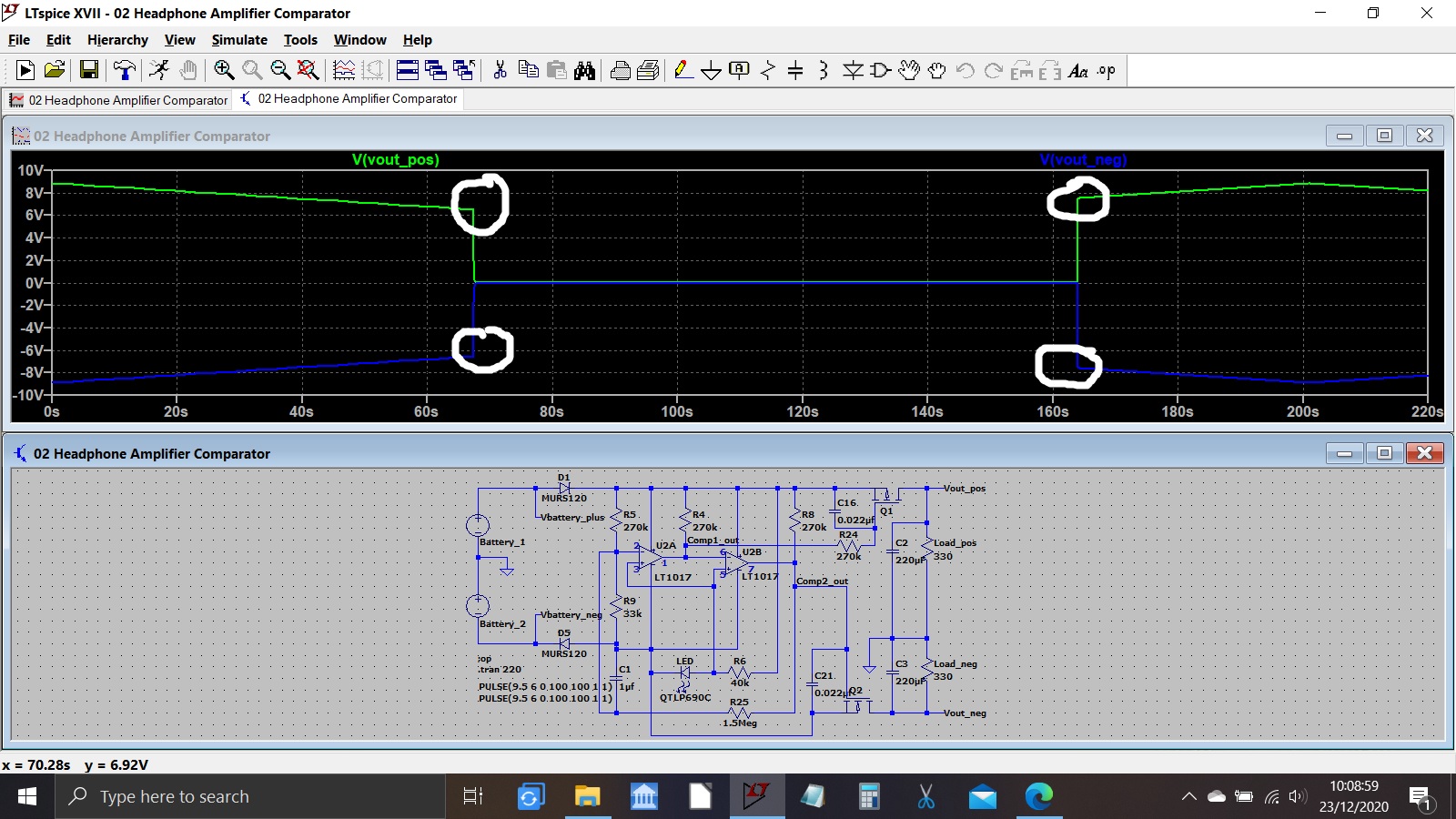

The hysteresis looks about right as it is tbh. You can see here the difference in cut-off and turn on voltages here.
