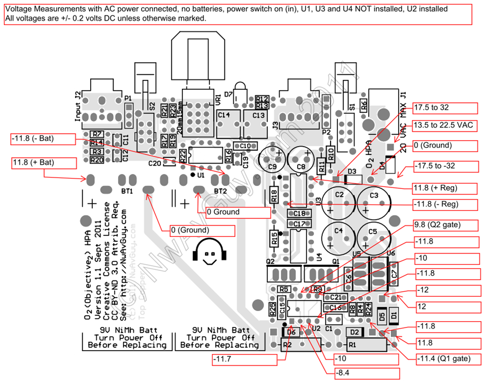

Just getting back into audio DIY, but struggling to get my O2 going, I'm working through the checklist, so far everything up to the regulators checks out, however checking the pins for U2 with U2 installed I'm not seeing the expected values.
The LED does not light up:
+ve 11.83V on the positive rail.
-ve -11.79V on the negative rail.
U2 voltage referenced from ground:
Pin 1 = +11.52V
Pin 2 = -0.9V
Pin 3 = +11.78V
Pin 4 = -11.79V
Pin 5 = 11.79V
Pin 6 = +11.52V
Pin 7 = -11.78V
Pin 8 = 11.84V
The voltage drop between pin 3 and (pin 4/pin 5) being almost 20V doesn't seem good and is probably why the LED is not working, puzzled what could be wrong, are the mosfets not installed properly/damaged?
Any help appreciated.
Pins 1 and 7 are in the wrong state to turn on the FET's but that is because the LED reference voltage on pins 3 and 5 is totally incorrect.
It looks for all the world like the LED is either open or there is a break in the print or possibly it is fitted wrong way around.
Pins 3 and 5 should be a couple of volts (the LED's forward volt drop) above the negative rail. So if you have -12 on pin 4 you should see -10 on pins 3 and 5.

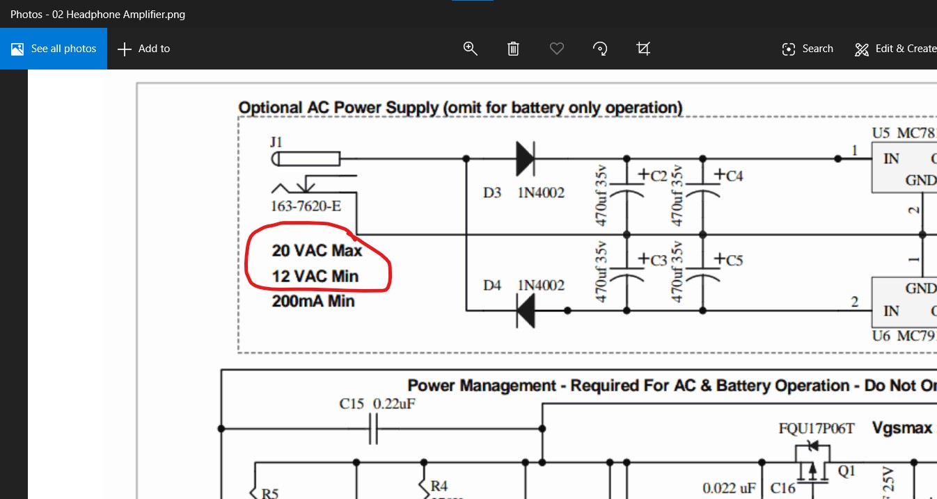

Peeeew I finally finished the "upgrade" to the desktop version. While the portable one did work during testing, the desktop version doesn't do a thing. Not even the LED is lighting up.
While measuring I discovered some weird things:
  • R20 shows 9.98 while R7, R14, R3 show 0.27 (DMM set to 20k)
  • R25 shows 1.3 (DMM set to 200M) OR 0.39 if set to 20M
The rest of the resistors seems to be OK. Please keep in mind that I haven't changed anything and the amp was working exactly like this, I just did the conversion to the desktop version.
I've included two pictures...maybe you notice someting?
Plus a stupid question to show that I indeed have no idea what I'm doing - Is it dangerous to plug it in just like that i.e. without the case?
It is all low voltage and so safe from a users point of view... the circuit might think otherwise if you rest it on anything metallic though. But safe, yes.
You can not measure resistors in circuit... it just doesn't work for several reasons.
Firstly your meter is an unknown with regard to test voltage it applies when measuring resistance. That voltage will bias various semiconductor junctions into conduction (discrete and in chips) and they totally skew the result. Your reading may be different depending on lead polarity. Even changing the range on the meter might give totally different results.
Also any slight residual voltage in the circuit can totally confuse a DVM on resistance ranges.
If it is not working at all then check the basics of supply voltage from the input through to all the opamp supply pins.
Thank you for the information. I thought this is the first step of testing as described by NwAvGuy himself.
EDIT: I think I found the error - If I put in the battery, it's working completly 🙂...so something wrong with the power input probably. Is there enough lead in your opinion?
I hadn't actually seen that before but he is saying the same as myself really, that resistance checks in circuit can be unreliable unless you are sure of the conditions in the circuit. So he says to remove all opamps etc and so on.
So it looks like you are looking the right area for your fault. Work through the guide I posted which should hopefully narrow things down.
There is enough lead as long as you can fit it all in the case properly... if that is what you mean 🙂
Remember I've never seen these for real... I can only work off the circuit diagrams 🙂
And the O2 has an AC input (DC won't work) and so being AC the polarity doesn't matter.

1) With your meter set to DC volts and with the BLACK meter lead firmly connected to ground (that is the common junction of C2, C3, C4 and C5 etc) measure the voltage on the striped end of D3. It should be higher than PLUS 15 volts and lower than PLUS 28 volts.
Striped end on D3 gets me 90 (DMM set to 200m, black lead is on C3- and the read lead on the striped end of D3)
2) Keeping the BLACK lead on ground measure the DC voltage on the NON striped end of D4. It should be higher than MINUS 15 volts and lower than MINUS 28 volts.
Gets me -90 (DMM set to 200m) - Also I have to switch black lead from the C3- to C3+, is this normal?
It seems that it is not so easy to measure it with my "AstroAI AM33D" DMM 🙄
Just looking at a picture of your meter and 200m is 200 millivolts DC F.S.D. (full scale deflection in old money😉).
So you need first to check that you have the required AC voltage coming from the adapter by using the '200 AC' range which are the positions clockwise on the dial. There is 500 and 200. Those AC ranges are in volts.
See if you have any AC coming out of the adapter.
For all the DC voltages you put the black lead on C3 positive which is the common junction of those four caps.

Start from NwAvGuy's advice on the site and Mooly's on post #3775.
And as Mooly said before, remove the opamps and leave the comparator in.
Then give us the breakdown of all voltage levels from these points. The more information you give, the better someone can help you. Whatever you do, don't short anything with the probe tip.
