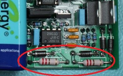

I need help with finding a fault. I've bought a brand new O2 amp. It works fine when connected to a power source. But the batteries are not charging and therefore I can't use it without a power source. However the 9v batteries do work when I remove them and charge them in a separate battery charger unit I own - which is not convenient!
Rather than sending it back to Switzerland for repairs, which will cost me money and incur a two week or more long wait. I've decided to take out my test probs and soldering kit. Does anyone where exactly I should be looking on the circuit to troubleshoot for a solution the fault?

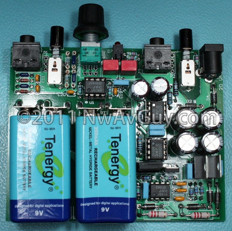

Mooly's fault-finding guide in the post #4652 above is a great place to start, then post the results. A high resolution picture (or any picture!) of the front and back would be extremely helpful too. In fact, for this particular thing, I wouldn't be surprised if the picture does it.
The two large resistors in the red circle in the photo below are the entire battery charging circuit. 🙂 They supply a trickle charge from the AC supply to the batteries. Those two diodes in the circle allow power to flow from the batteries, so make sure your similar two diodes have the band in the same direction as those in the picture.
So since yours isn't working... the other thing I've seen folks do is get the polarity of the battery terminals that are soldered into the PC board reversed. In the bigger picture you can barely see the correct way. The large battery terminal on the left battery PC board terminal goes next to the left edge of thc PC board. That mates up with the positive (+) marking on the battery and the smaller terminal on the battery. Same for the other set of battery terminals. If your battery has negative (-) closest to the else of the PC board your terminals are swapped. If the battery polarity is reversed like that they won't charge. If you have done this some solder wick will easily remove the solder on those PC battery terminals - the holes are large - and they will just drop right out onto the floor if you have the board upside down.
It is also entirely possible for those Tenergy 9V batteries to short internally (I've had two do it so far) or be open (I've had one of those). But since you say the batteries work in other devices that probably isn't the problem. When they short the battery case puffs up a bit in the middle.
And yet another thing that can happen is the battery terminals not making contact once the battery is snapped in. I've had this happen before. If you can wiggle the battery back and forth easily when it is intsalled that might be the issue. To correct that gently squeze two of the clip "petals" (the larger 9V terminal) to move them in a bit and try it again with the battery.
