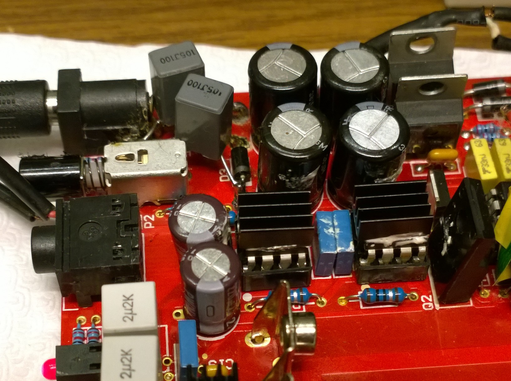

- 1) Changed the gain resistors from infinite/1Kohm (corresponding to 1X/2.5X) to 2.5Kohm/516ohms (corresponding to 1.6X/3.78X). I did some "custom resistors" of about 516ohms by serializing 274ohms + 242ohms resistors that I had in stock; this corresponds to a real gain of about 3.78X and an output voltage of about 7.3V RMS when connected to ODAC. Looks like my ODAC can output 1.921V RMS when 0dB sinewaves are applied and connected to O2 with 7.3V RMS on outputs I have tried 20Hz, 32Hz, 1KHz, 16KHz, 20KHz and I get no clipping on O2 output, no roll-offs, no oscillations, no strange FFT harmonics, no THD >0.1% (checked with my PicoScope 2204A).

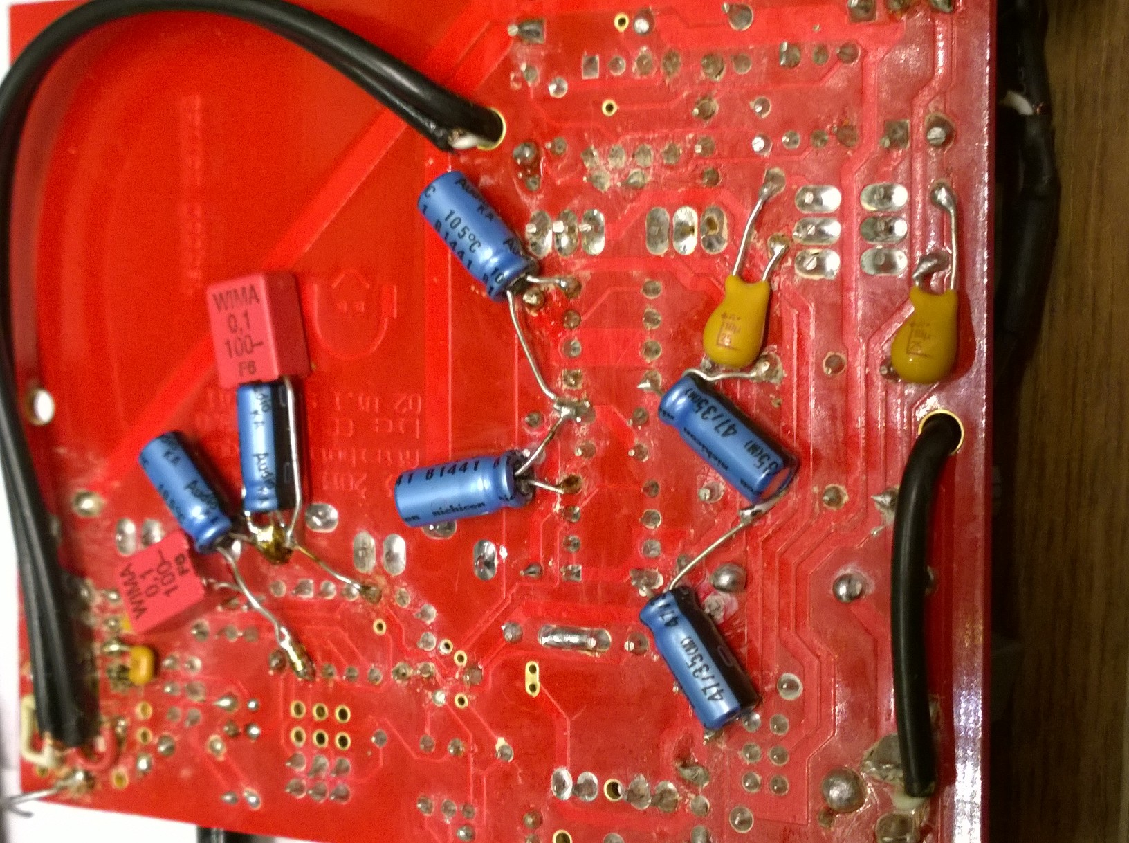

- 2) Added 2 x 1uF film capacitors immediately after the 2 regulating diodes from power input plug. These 2 caps should decrease any possible noise coming from the mains.
- 3) Added 2 x 10uF/25V AVX tantalums on output regulators, to further decrease the already low ripple.
- 4) Added 2 x 47uF/35V Nichicon KA and 2 x WIMA 0.1uF/100V for decoupling the input stage OPAMP (LME49720).
- 5) Added 2 x 47uF/35V Nichicon KA for each of the 2 output buffers for decoupling purposes (NJM4556A).
Did I gained anything?

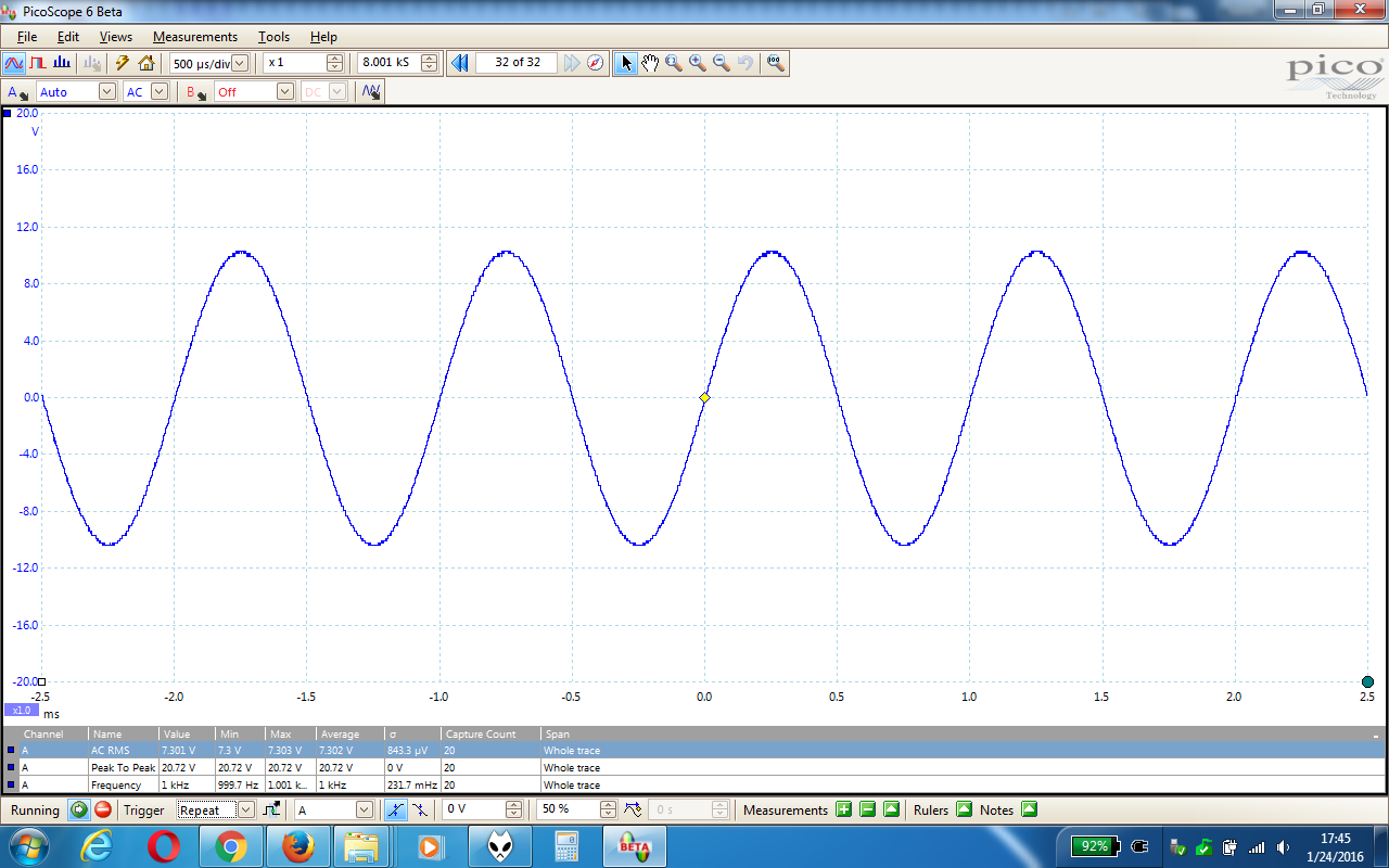

- Besides a lot of fun, I was able to decrease ripple & noise from 2.3mV p-p to 0.747mV p-p, measured directly on each regulator output and also from OPAMPs +/-V rails to GND. That's a good ripple decrease, though it will probably not be noticed on headphones out, because O2's OPAMPs already have a good ripple reduction inside (PSRR & CMRR of about 90-100dB).
- I feel like soundstage increased a little bit, though this is a subjective impression, but I hope I'm going to test it sometime by A/B'ing, when I'll find another O2 to borrow.
- OPAMPs rolling should be easier now with additional decoupling caps used.
Note: The tested O2 has LME49720 on input stage and 2 x NJM4556A as buffers. All 3 OPAMPs have heatsinks on top, glued with Arctic Alumina compound. There are 2 power plugs in front and back, 2 headphone jack: 3.5mm and 6.3mm on front and RCA outputs on the back. I'm also using original 9V/300mAh batteries and original 15V/500mAh power adapter.

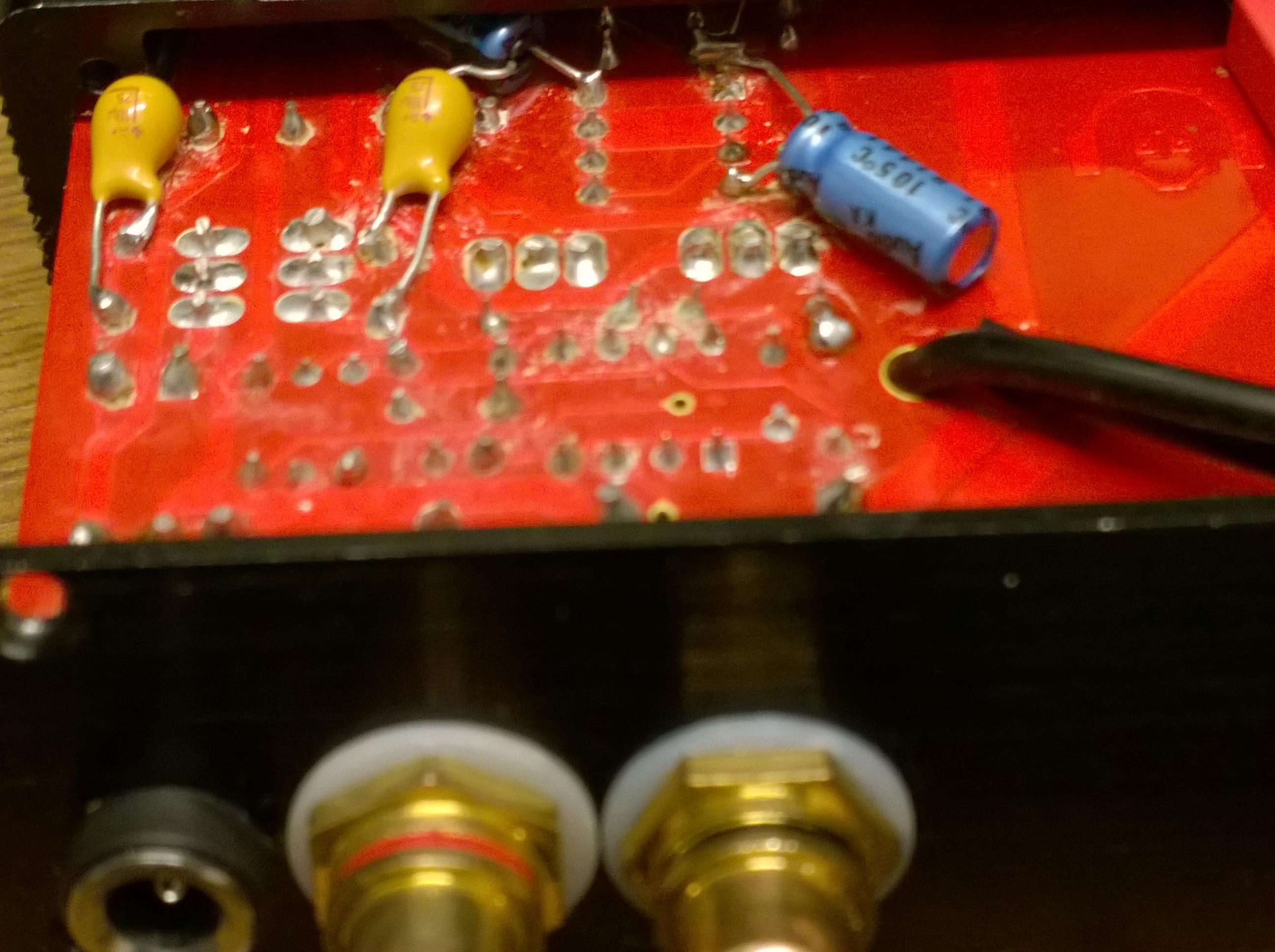

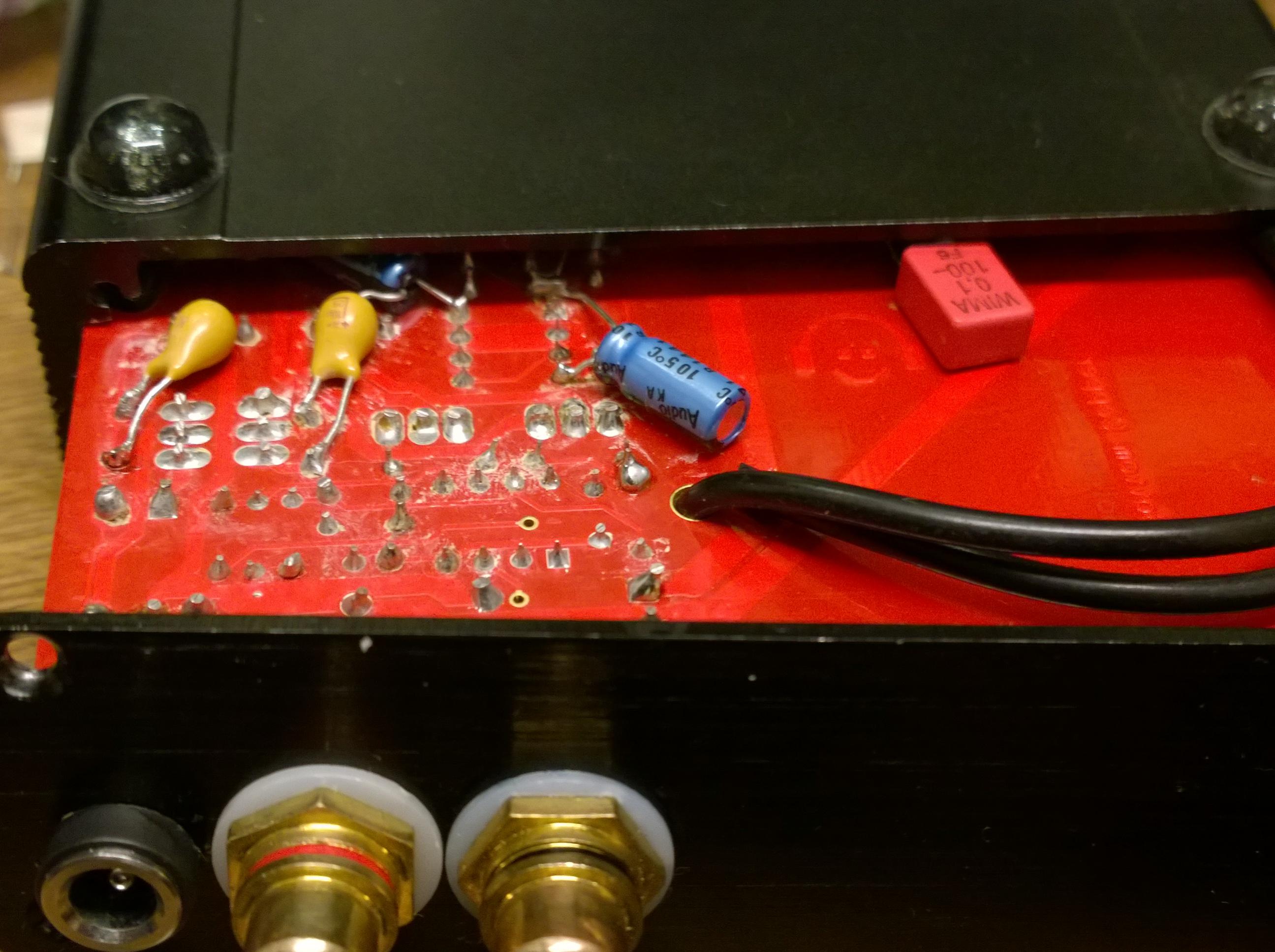

P.S.: Looks like the way I arranged one of tantalums was not good (4'th attach.), because I couldn't close the case, so I need to move it a few mm away from the edge of the PCB (last attach.).
