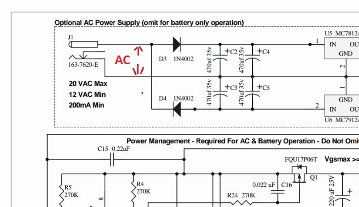

Hello, I have just completed the assembly of my o2 amplifier.
After checking everything, i tried powering it on with test headphones. When i did, it just output a loud static noise. I havn't been able to find other people with this issue. so I'm a bit at a loss. I noticed the U6 mosfet get a lot warmer than the U5 mosfet. So I'm thinking that one is the problem. Has anyone here encountered this problem before, and maybe found a fix?
Thanks for the reply. I had some time now so i tried it.
I have an issue at the first step already. When i set my multimeter to DC Volts and measure at the places you mentioned i get 0.449[V].
I checked all the diode polarity, and no faults there. I checked the 7812 and 7912 mosfets and they are also correctly places with no bridges.
When i go to step 2 and measure the non striped end of d3 i get 0.1 milli volts.
This sounds as though something is amiss with either the AC adapter or its connections to the board.
Can you measure AC voltage between these two points. You should see between 12 and 20 volts AC. Make sure you have it on AC for this one measurement.
Also are you sure your meter is OK. Check it by reading the voltage of a battery. Your meter should then be set to DC for this.

I can't tell from the picture simply because I've never actually seen an O2 board... we work from the circuit 🙂
You are measuring between the striped end of D4 and the main ground on the board which is the junction of all those four capacitors in the diagram I posted above.
Meter on AC volts and you should see between 12 and 20 volts AC.
That looks OK. The LED fading out is normal and due to the large capacitors holding charge.
So next step is to check the DC voltage (so meter now on DC volts) coming out of the regulators U5 and U6. You should see plus 12 volts from U5 and minus 12 from U6. Keep the meters black lead on ground for all these measurements. Be careful not to short anything out with the meter probes. You can pick these voltage up on D1 and D5.
