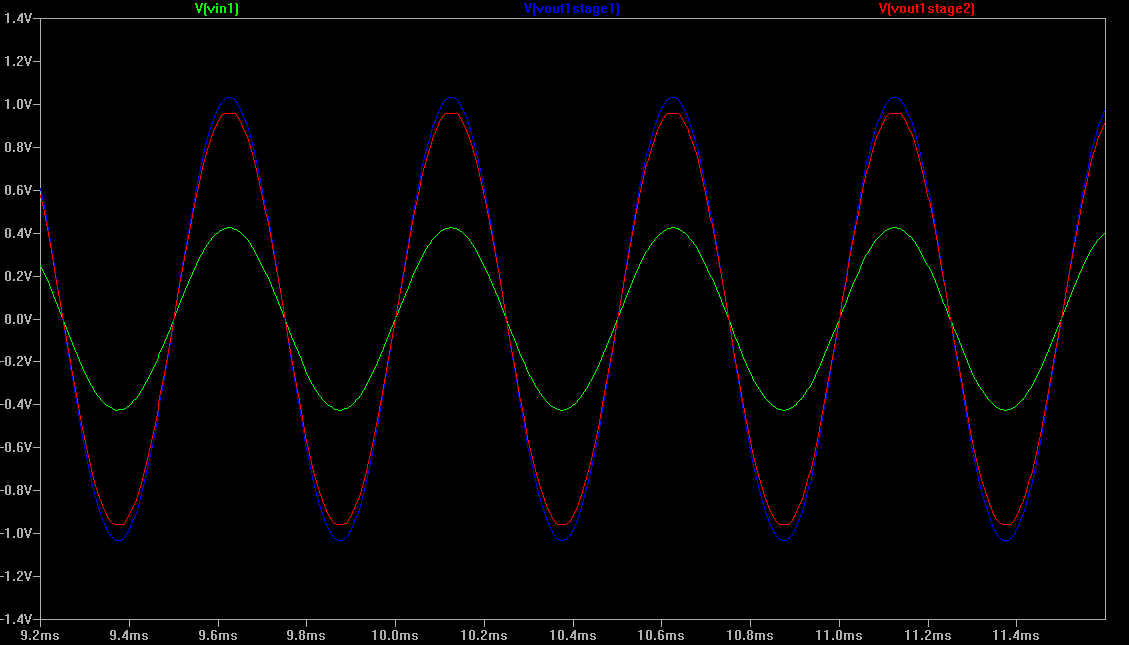

Interesting to note though that if someone stuffed in +/-5V or +/-6V regulators to produce roughly 4.5V or 5.5V rails who would do something like that then with an 8R speaker it looks like you could get to the point of clipping the output NJM4556s without frying them.
With +/-5v regs, the sim output clips at around 0.95Vpeak (0.67Vrms) for a 2.5x gain and an input of around 4.2V peak (0.3V rms). At that point the 8R speaker power is around 56mW, still insignificant but nearly 2x from the 12V version, and the chip power is (4.5V)(84mA) - 56mW = 322mW = a happy NJM4556 chip!
This doesn't have much applicability to 8 ohm speakers since 56mW is still to low to be useful, but it does to low(er) impedance headphones.

Much appreciated. I can roll with this. agdr, your sim values are helpful also. Any modding I do is going to target the power supply, just for sake of personal convenience.The DC power consumption is about 22 mA idle and typically under 80 mA playing music even at high levels into low impedance loads. The AC power consumption is typically under 200 mA but full power worst case sine wave testing with both channels driven it's 480 mA (including battery charging current).

@agdr you did your sims with sine waves I think? If so, those don't reflect dissipation with music so your numbers are significantly off. But it's really pointless. A sports car can't tow a 30 foot boat either. The O2 will drive 16 ohms playing real music to clipping all day long if you don't jack up the supply rails beyond 12 volts.
