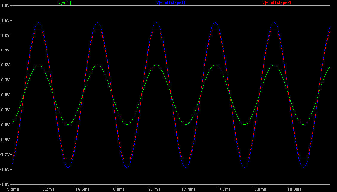

I was thinking, and reasoned that the amplifier can drive small 8 ohm speakers, but for how long, I am curious. Many high end DIY amplifier designers advertise that their amplifier can drive speakers too.
@Spacehead, claims aside, it's best to use a tractor for plowing fields and keep the Porsche on the roads. I can't recommend the O2 for driving speakers. There are plenty of chip amps, class-D modules, etc. for that. The O2 will only produce about 1.2 volts RMS into 8 ohms and get rather hot in the process.

If user plugs speakers, will the amplifier survive? I have read that op amps can work at quite wide temperature range. There is no thermal protection in NJM4556 I think.

It might survive for a little while, but I suspect the 4556s will fry pretty quickly. RS has designed the O2 to handle down to 16 Ohm headphones, halving it again to 8 will probably be ill advised..
I really don't get the point.. use the amp for the use it is designed, or get another amp..
There are enough amp modules of various sorts around that you could build something decent for only slightly more, and do a much better job for speakers..

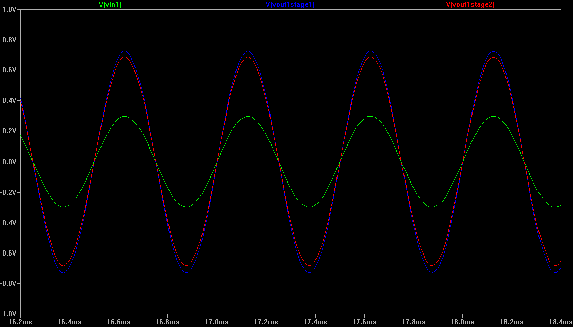

Never being one to shirk from abusing the O2 in sims, it looks like the NJM4556 chips would fry at right around 0.21Vrms input (0.3V peak) at x2.5 gain with 8R speaker loads, if I've done my math right. 😀
That results in about 0.7 peak or 0.49Vrms out (61mA rms), which would only be 30mW into the speaker. Over on the NJM4556 side of things though that wold be (12v)(61mA) - 30mW = 700mW = max chip dissipation.
The NJM4556's don't actually start clipping in the sim until about 1.3Vpeak output (0.92Vrms), but by then smoke is probably issuing out of the 4556 chips. 😎
