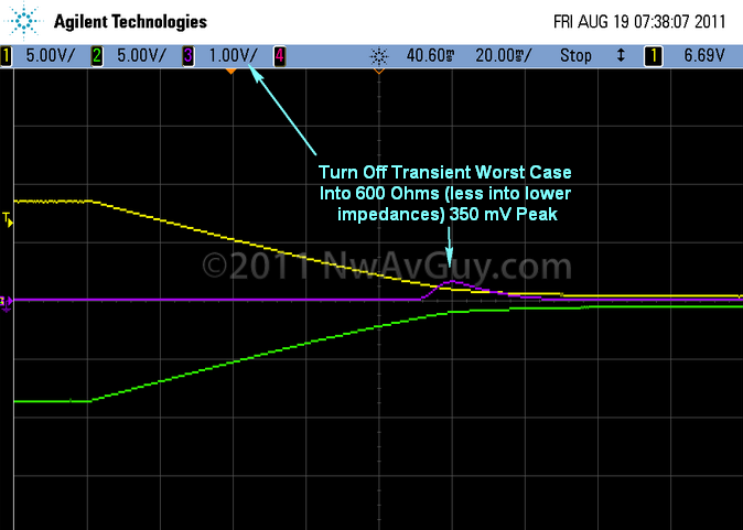

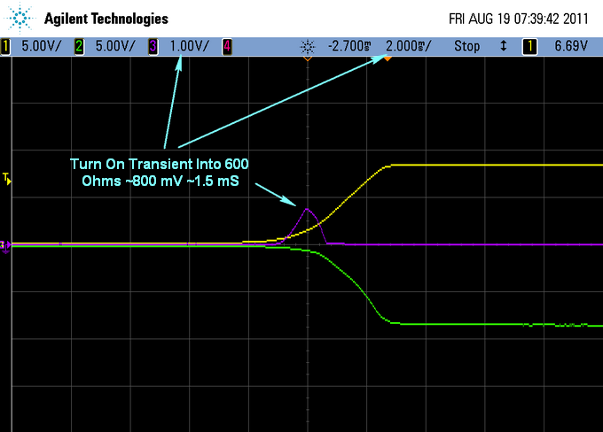

Hi all,
I am a bit late to this party but I have a question. If the O2 is built for desk top use without the protection circuit and without batteries, and if you leave the AC on all the time (like a wall wart) but switch the DC to the amp will you still get a big thump on turning on-off? I know that is not a plan suggested by the designer, but it would make for a much simpler build.
If the DC is switched and a snubber is placed across the switch will that soften the turn on-off thumps? Any thoughts?
Thanks.
Thanks.
Yes you can bypass the Power Management. You can connect h/p after the amp is powered up & disconnect h/p before turning OFF, so need to keep them ON 24X7.
If your switch is of good quality, the amp will have minimal ON/OFF thump. My personal observation is "toggle" switches are better than "push" switches. As for snubbers theoretically they should help.
...If the DC is switched and a snubber is placed across the switch will that soften the turn on-off thumps? Any thoughts?...
Thanks for your reply, but what I want to know is whether keeping the power supply on 24/7 and switching (on or off) the DC supply to the amps at board level will minimize the thumps.
Yes it will itwill minimize the thump.
Case I
You keep PS AC adapter ON 24/7 & use FP switch to turn amp ON/OFF-minimal thump.
Case II
You turn AC adapter ON & use FP switch to turn amp ON/OFF-minimal thump (same as above)
Case III
FP switch is in ON position & you turn ON AC adapter- Loud thump, worst case is AC half cycle.Even if you plan to keep AC power supply ON 24/7 there may be situation of momentarily supply failure (lasting just under a second) or brown outs resulting in large thumps.
The batteries in O2 also act like "online UPS" to eliminate Case III type situation.C1(1uF) is also useful in reducing power ON thumps
The "minimal thump" will still be more than O2 using standard BOM.
BTW High impedance, low sensitivity h/p are more immune to power ON/OFF transients than low impedance, high sensitivity h/p e.g. IEMs.Other well designed desktop amps usually employ some sort of relay mechanism to connect h/p after the PS has stabilized & disconnect the h/p in case of supply failure/turn OFF/ DC at o/p type situation.
