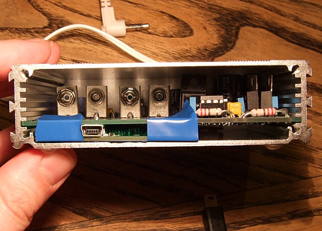

I was able to get my ODAC fitted into the case in a similar manner, lots of grinding/filing on the case, I used a thin sheet of acetate(look for blank stencil material at hobby store) glued to the case and double sided tape found at a hobby store. The acetate isolates the usb and inductor from contacting the metal in the case.

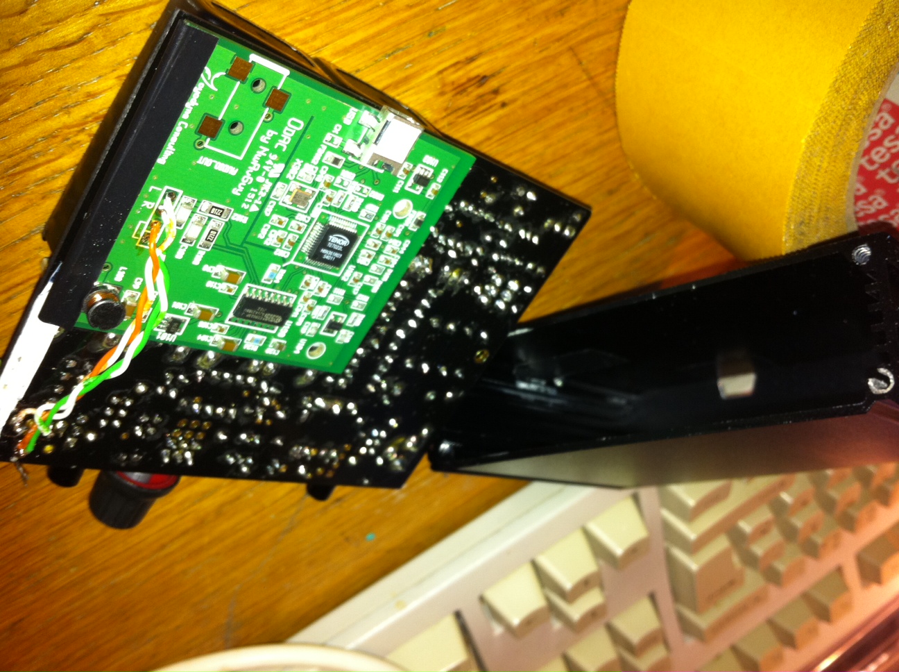

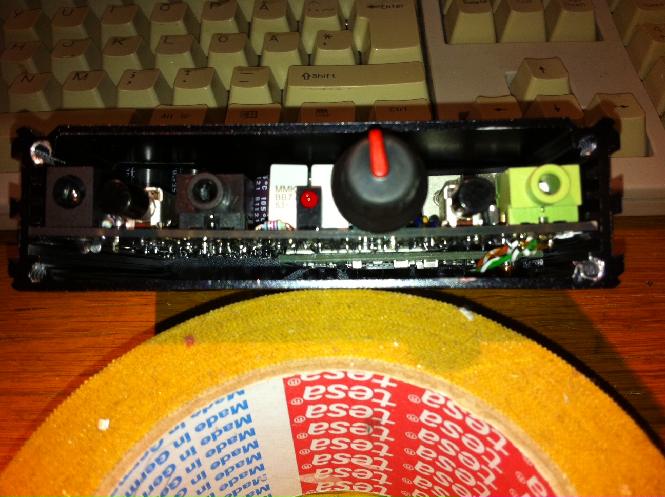

OK, here they are... I'm shure others will share better ones.
Brgds

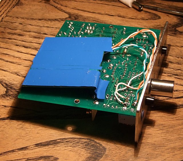

Making a new front panel, for an upside down O2 with slotted ODAC, didn't take my fancy so I've gone for the ODAC under the O2 PCB with simple electrical tape to keep things in place. I intend to find some firmer method, perhaps using a hot-glue gun (suggestions welcome) to keep it all in place and together.
For the time-being I will simply find a bit of wood to jam against the back of the ODAC to keep it from sliding back when attempting to plug in a USB cable. The whole of the underside of the ODAC board I covered with electrical tape to avoiding shorts against the case.

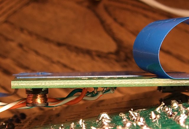

I purchased some needle files to make the USB connector hole in the backplate (which I haven't done yet) which came in handy to file down the solder on the under side of the ODAC as otherwise it doesn't fit: the joints are too high even when snipped very close to the board. I filed very carefully balancing the file with my thumb and making short, slow movements. It took a surprisingly short time.
Pics included with scratch marks where I scraped the board. I left a little bit of height to the solder, to avoid scratching up the board, but possibly as thin as the electrical tape which you can see in one of the pics. I ended up soldering the last three joints on the top side of the board to make certain there would be enough solder.

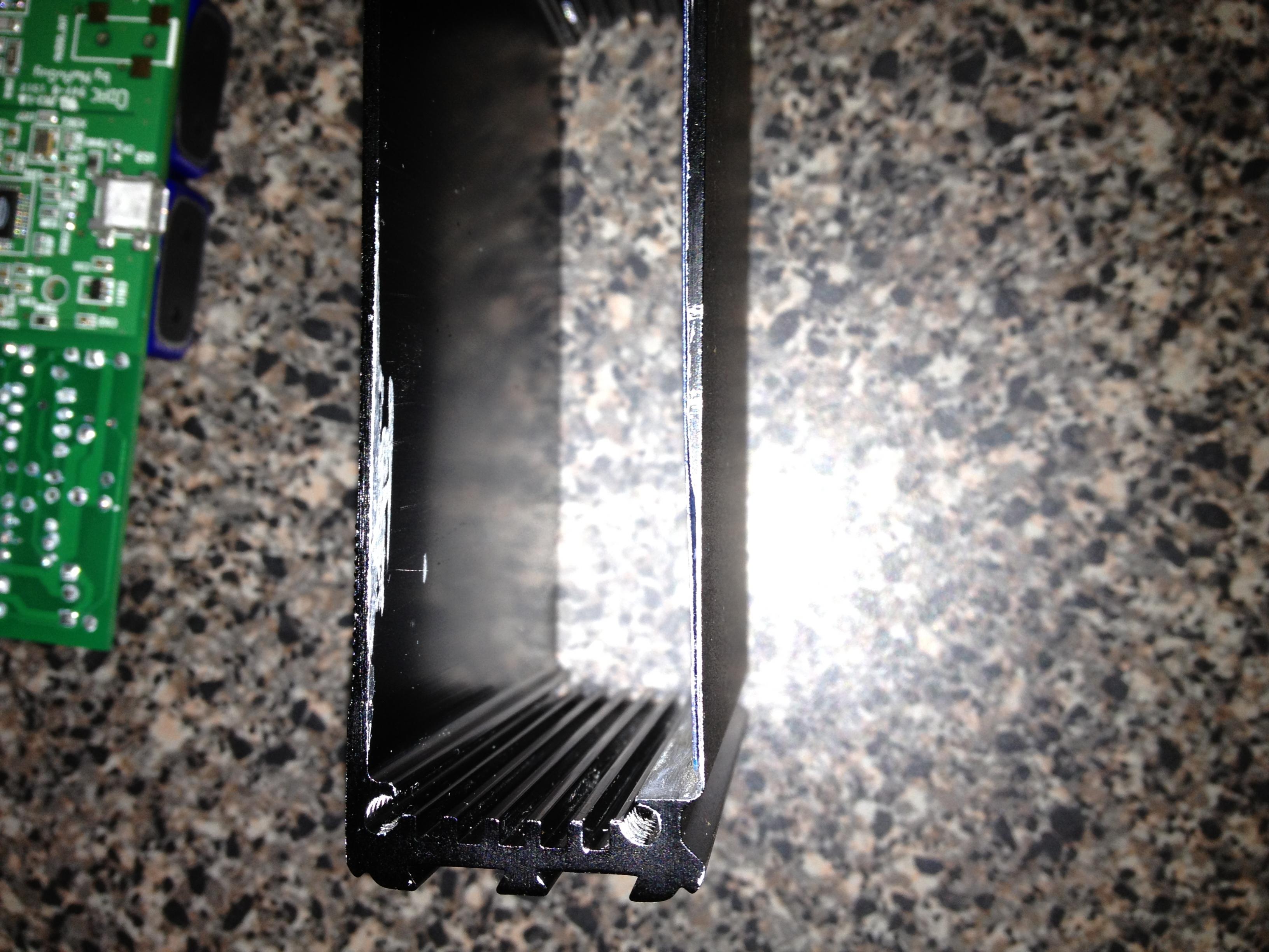

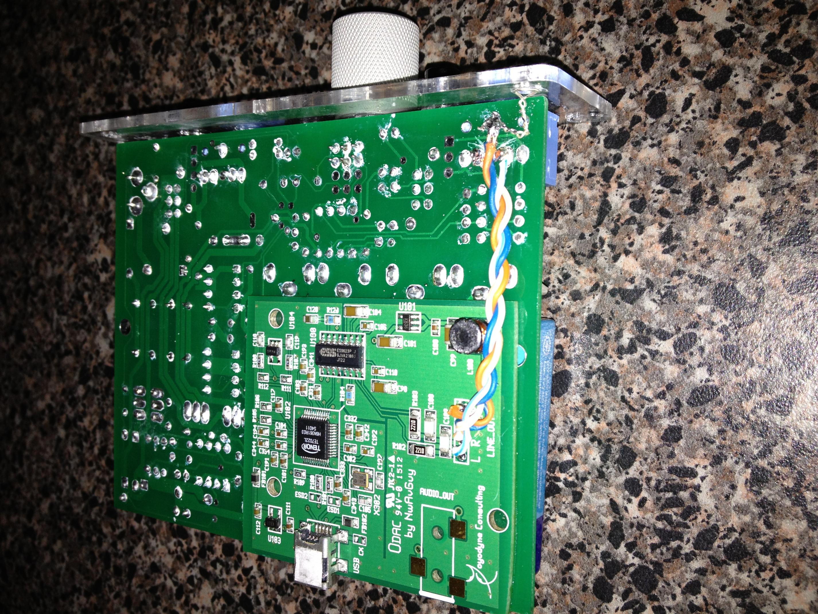

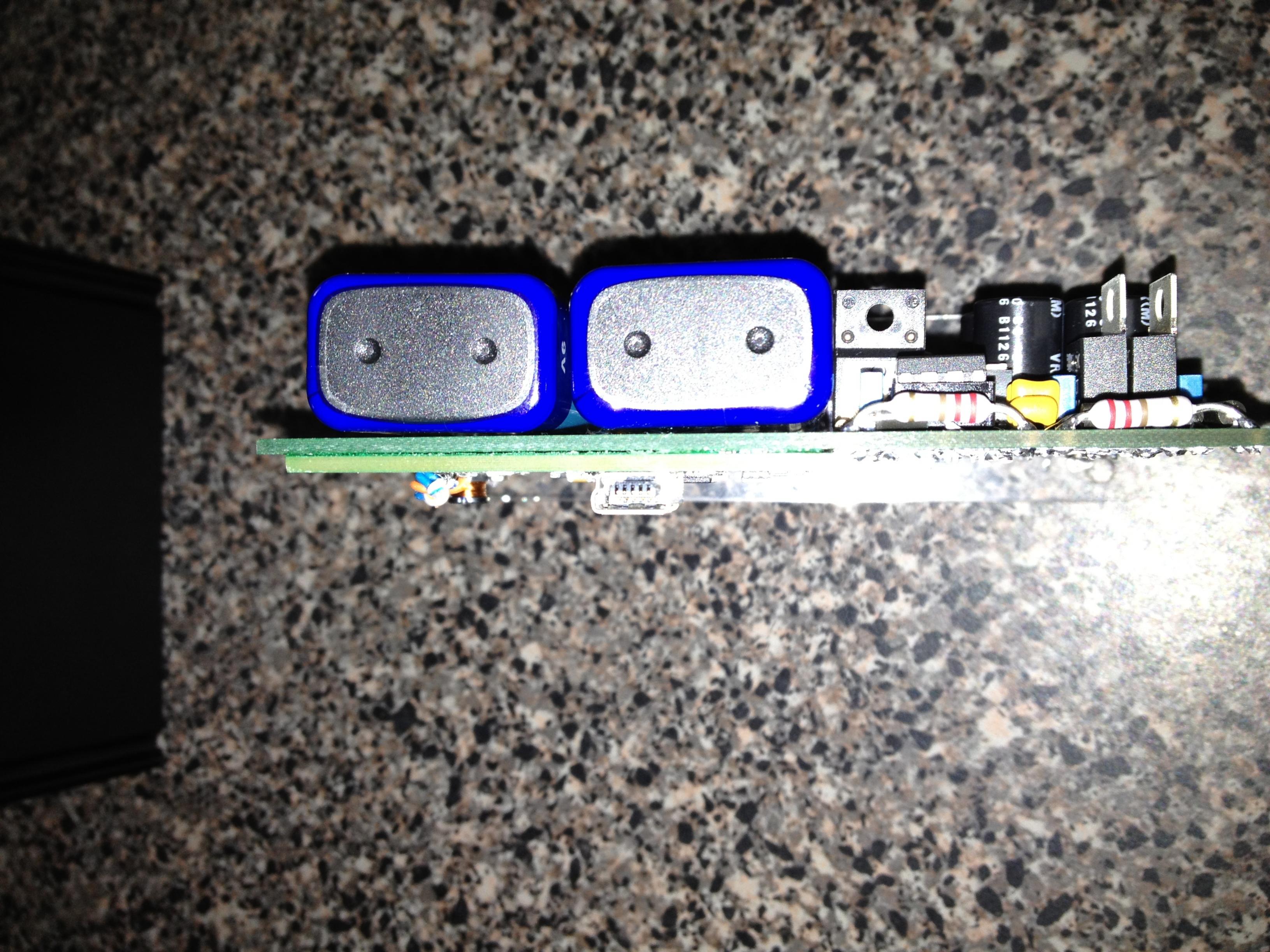

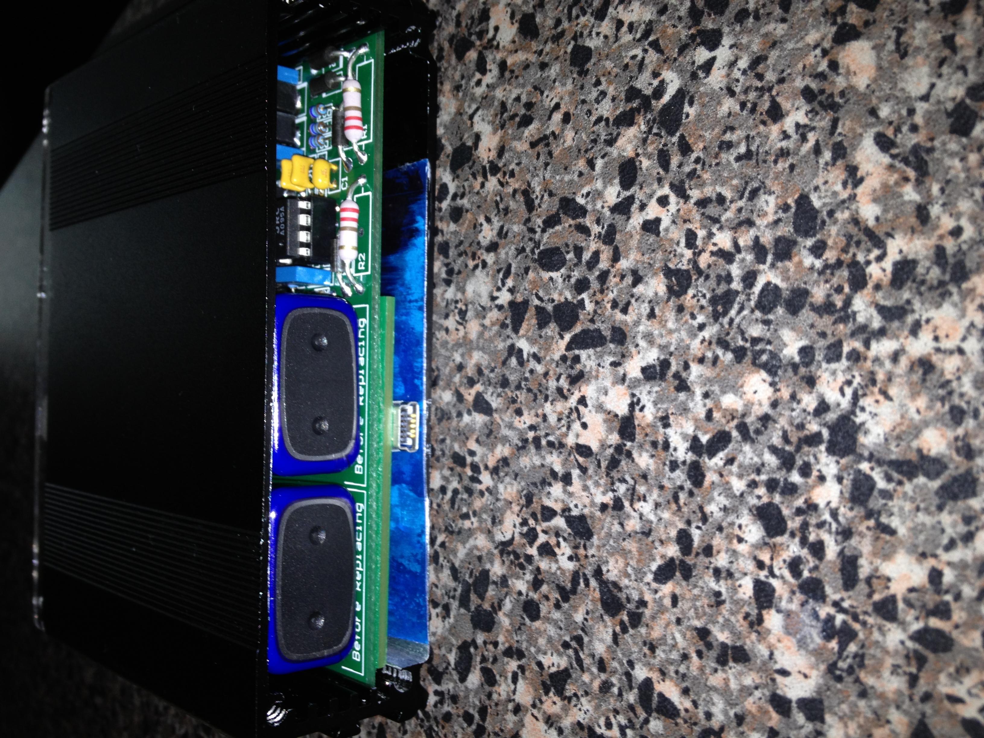

Okay, here are some pics of my O2 and ODAC batteries still in tact. I was able to keep mine mounted in the same location in the case and retain the faceplate. I filed off inside bottom of the case where the inductor is to a bout half the original thickness, I hope is does not crack. I also glued a thin sheet of Acetate to the inside bottom of the case to keep the ODAC inductor and USB port from contacting the metal on the inside of the case.
I have been listening to it on My sony laptop with JRiver Media Center 17 using WASAPI-EVENT SYLE through my Shure SRH940 Headphones and it sounds fantastic.

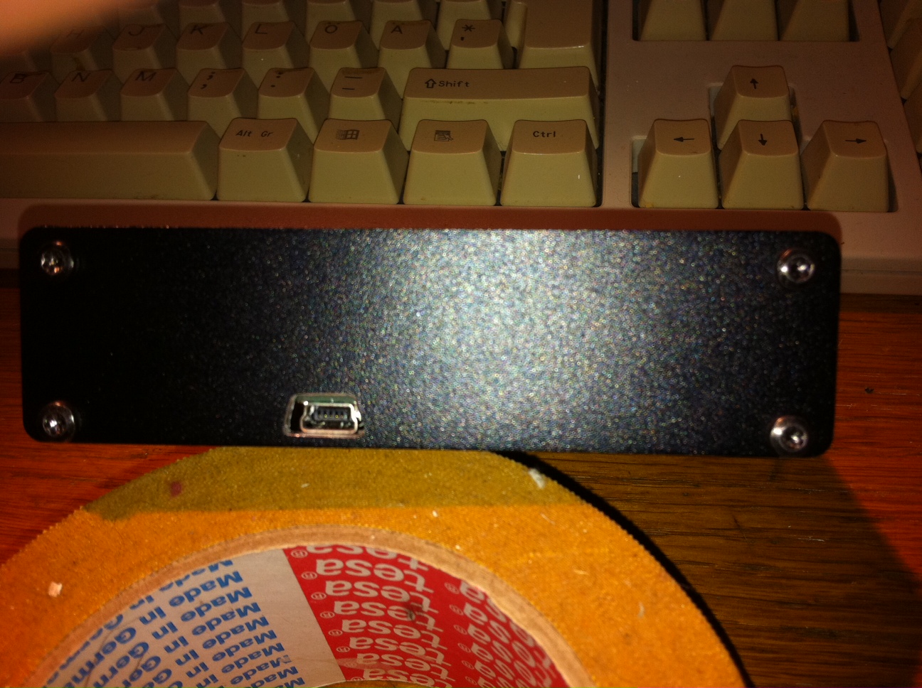

I ended up using a piece of stiff, curved cardboard, from an empty cocoa powder container to jam the ODAC, as mentioned in my previous post. I didn't want swelling wood - my initial idea - in damper times to cause issues.
Right now all works but I get quiet cracklings with movement. I haven't insulated the USB jack from the aluminium hole: they are in contact. I suspect this is the cause and may widen it a little and put electrical tape around the jack. I'm concerned to have the jack tightly fitted to reduce strain issues from abuse.
Widening the USB port hole in the back-plate to stop contact with the USB jack seems to have solved my crackling issues. I didn't use electrical tape to have a tight fit, in the end, as the jack is wedged tightly between the O2's PCB and the ODAC's PCB. There's still left and right sides to think about to avoid lateral stresses.
