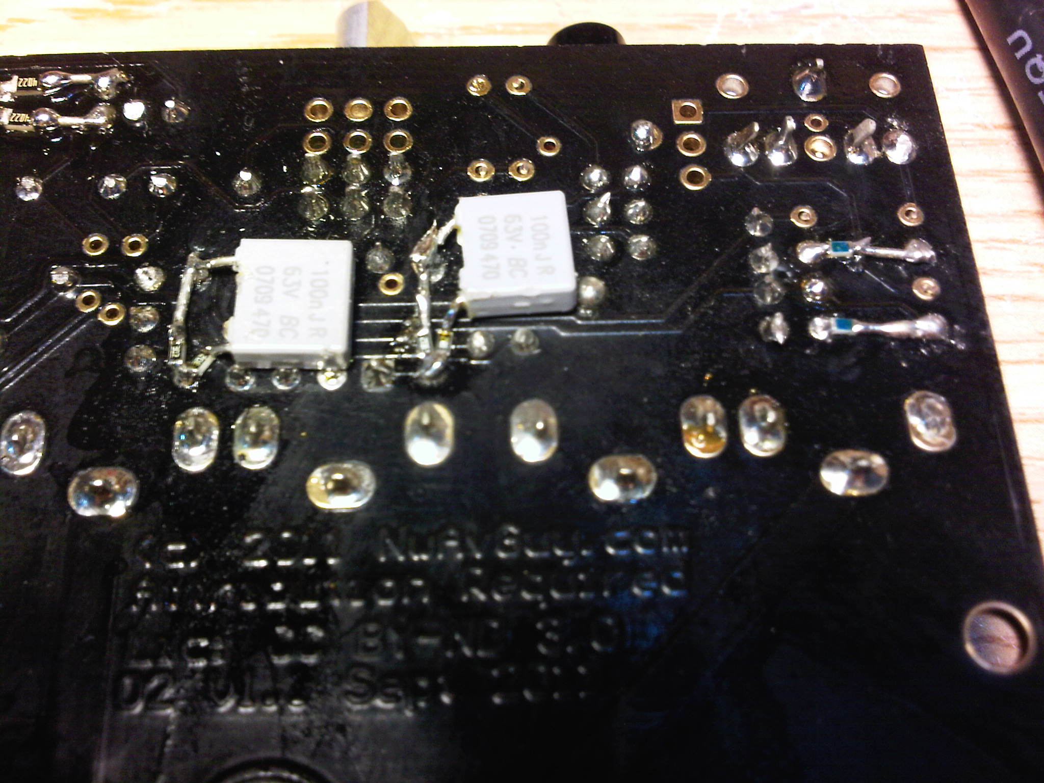

Found some low ppm (<50ppm) 0603 surface mount resistors in drawer. Decided to replace R14, 20, 16, 22, 12, 13. Also add bass boast R16 and 22 with 0.1uF film cap as agdr suggested in the other post.
After done, hock it up to my BII DAC, I listen to it for 3hr. All i can say is, It is very nice to my ear, I like it a lot.

Here is the picture, the picture is not so good as I am using mobile phone to capture it. All old resistors are removed and new SMD resistors are mount underside of the board as it is easier to work with. IMG-20120519-00191.jpg
Here is the picture
Hey that is pretty slick! 🙂 You found a way to use the (bigger than ceramic) film caps for the boost mod by sticking them on the bottom. I like the contrast there, the tiny SMD resistors and the huge 0.1uF film cap. 😀 That is what is needed electrically though. Looks like you are not going to use a switch on the boost mod (on all the time)? Another fellow has tried the boost mod and discovered the switch really doesn't fit anywhere in a B2-080 chasis. Have to go to B3. I just wired it all up to make sure it worked electrically, but hadn't tried to mount the switch in the box and got caught flat footed on that one.
Yup, it is on all the tim,. I need more bass all the time😀 . and I also don't know where to mount the switch 😕 in my B2 case.

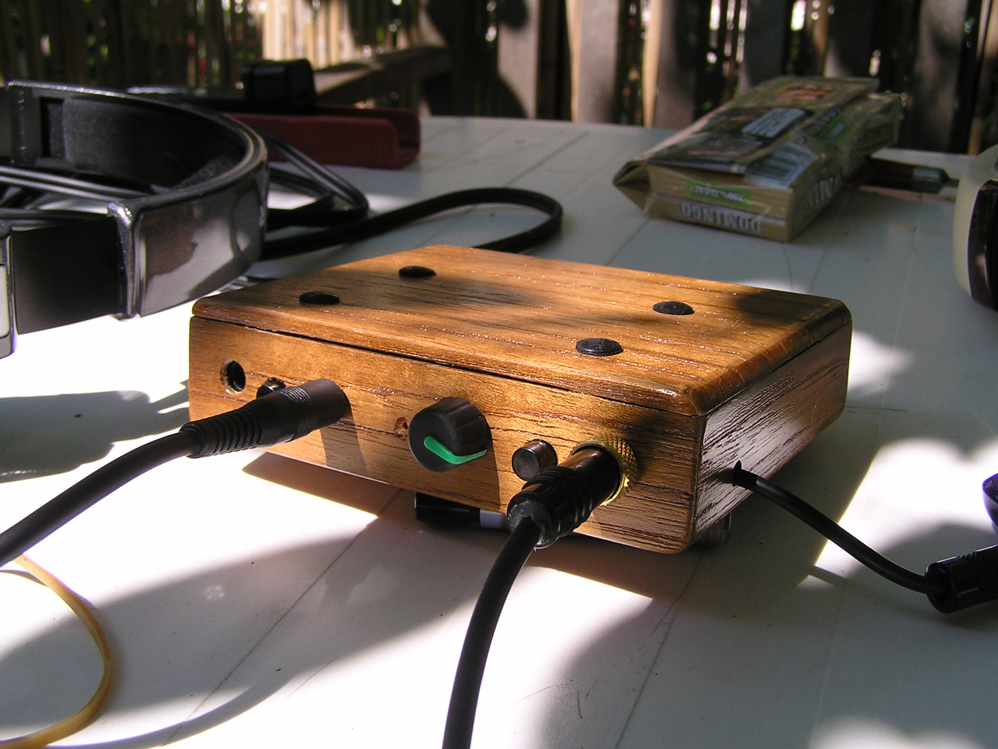

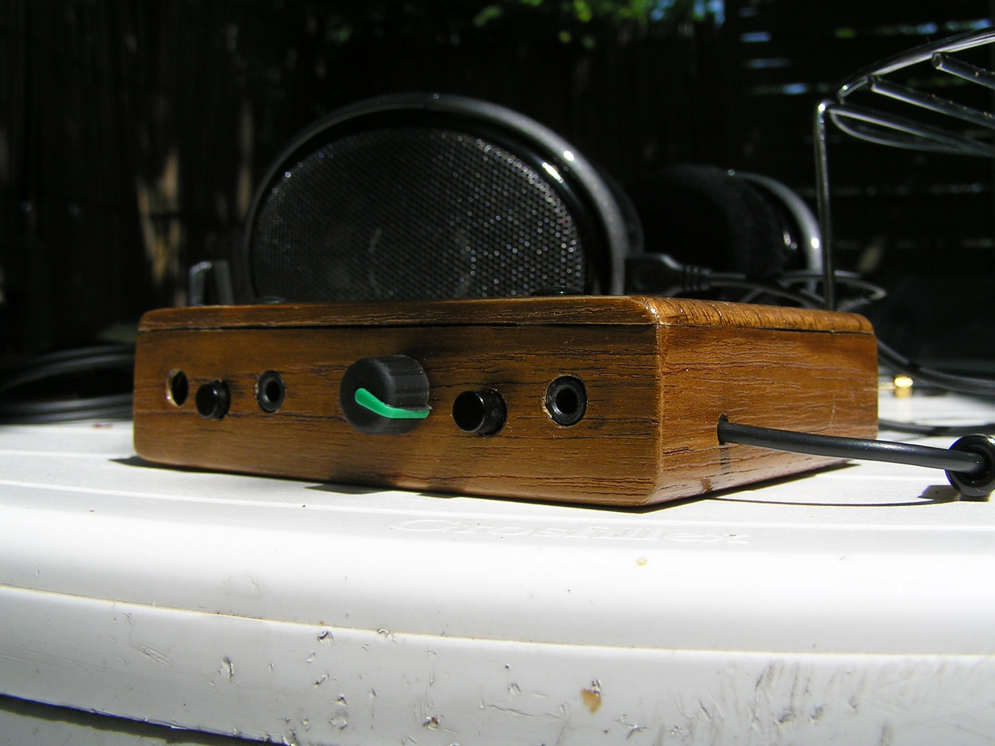

I'll post asap a photo of my box in... walnut

Here is the picture, the picture is not so good as I am using mobile phone to capture it. All old resistors are removed and new SMD resistors are mount underside of the board as it is easier to work with. View attachment 283268
Nice work, coolhead! Inspired by your work, I make bass boost too, few days ago. With ordinary resistors. Now in my O2 gain switch work as bass boost switch too. Since I use gain 2 and unity, Gain 2 is with bass boost and in unity gain position bass boost practically does not work.
I have 3K in feedback and 3K+100nf in parallel.
b.t.w., coolhead, since you use SMD resistors, you can make physically shortest possible feedback loop. Just solder feedback resistor direct between opamp's pin 1 and 2, and between 6 and 7. Leave in old place only bass boost RC.

and voila!

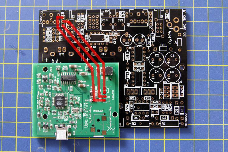

ODAC wiring...
Hi everyone, two quick reference pic's for those looking to wire their ODAC to the O2.
1. Odac lineout connects to P1 on the O2 board. P1.1 [square] = left, P1.2 = Gnd, P1.3 = right.
2. IIRC, with the input jack fitted you need to cut two traces on the reverse of the board.
Paul.
If you wire to P1 holes, the ODAC will always be connected to the amp input.
If you want the jack switch to function to select between external source (jack in),
or internal ODAC (no jack in), you cut the traces and then ODAC L & R connection
are pins 3 & 4 of the input jack socket on the underside of the O2 PCB.
In order to route the wires for L & R, I squeezed some 24g teflon insulated wire through
the PCB lead holes at P1 and under the board to solder to pins 3 & 4.
