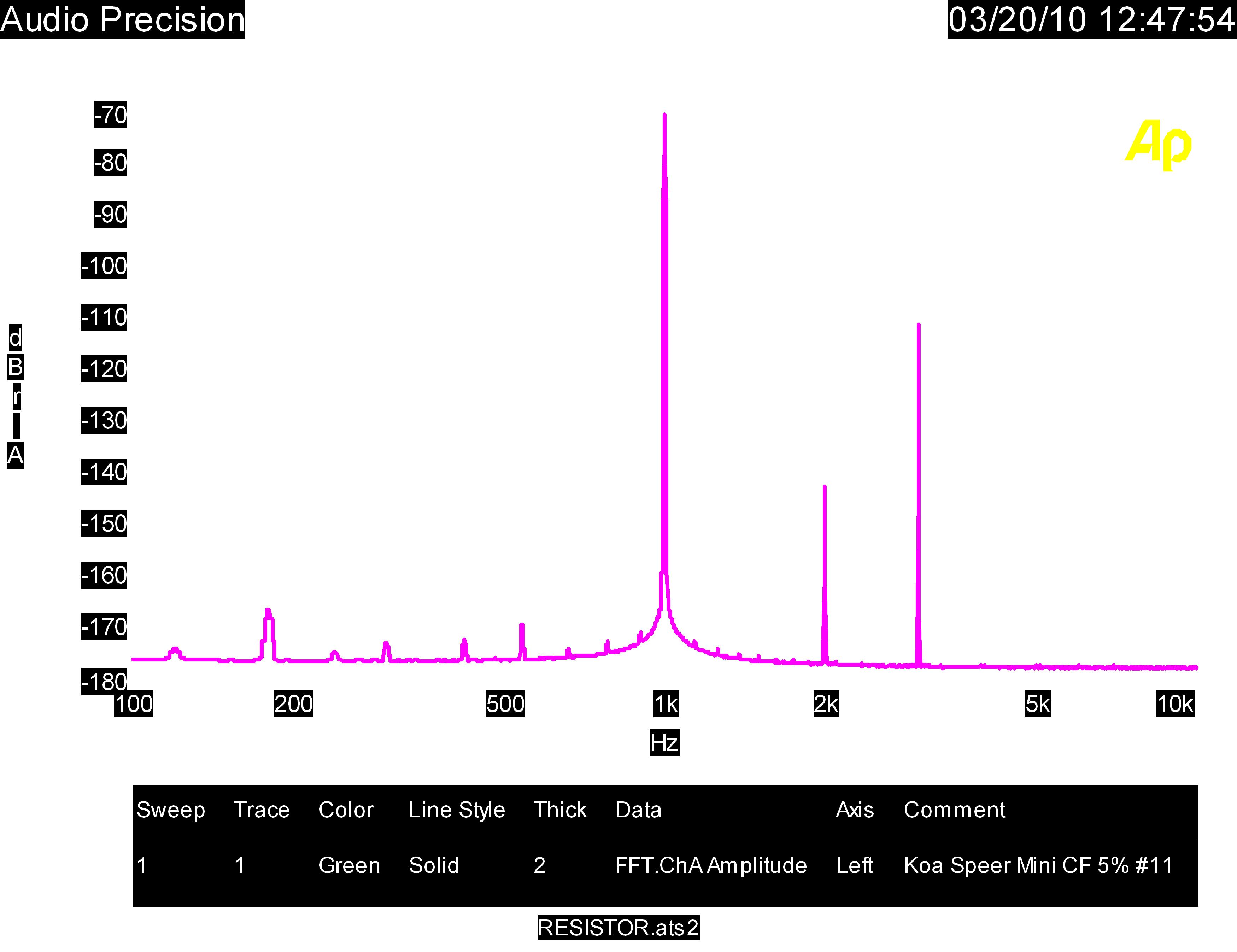

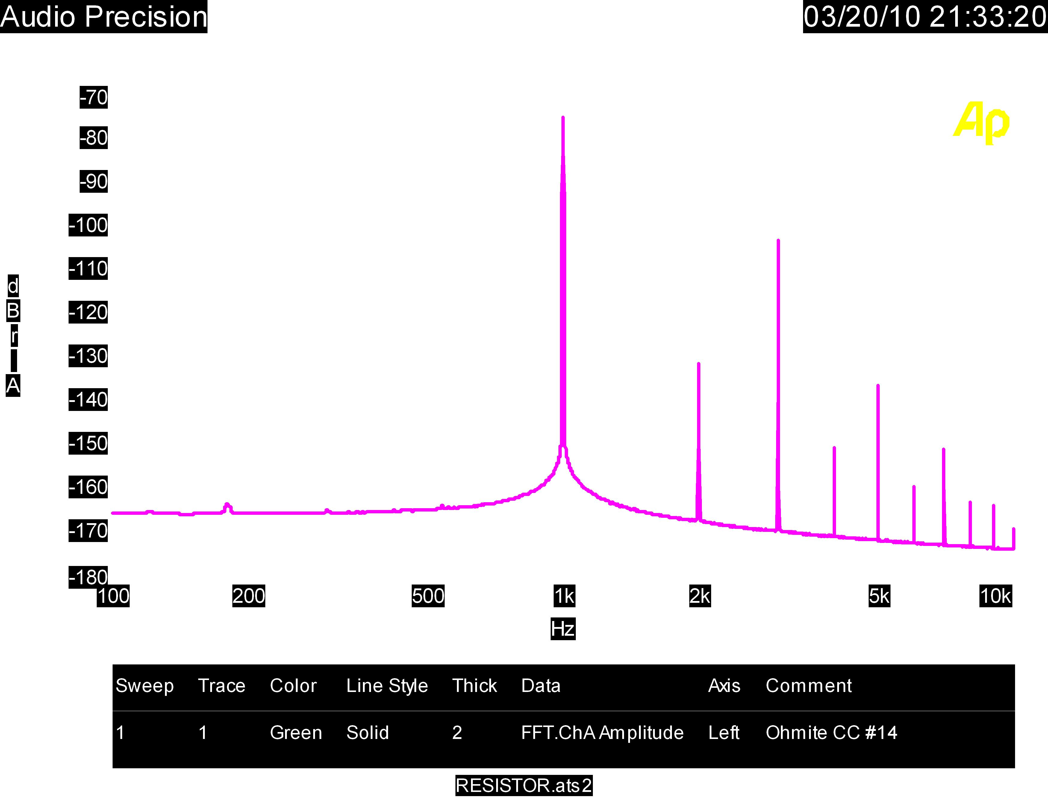

I assume KOA bought Speer a resistor manufacturer in Bradford PA. Oil country but enough coal mines to get the right carbon for carbon comp resistors.
Attached are the distortion curves for a carbon comp and a KOA Speer unit.
