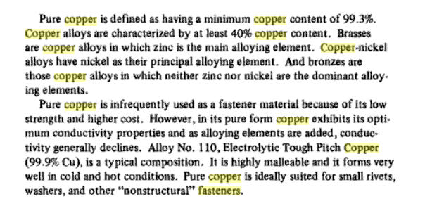

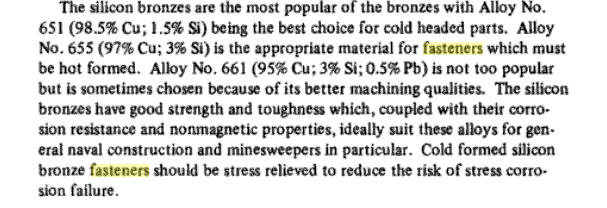

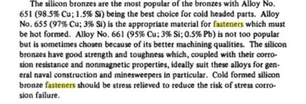

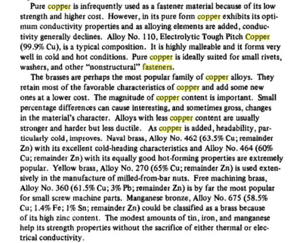

Anyone know of a place that stocks and sells single boxes at a time of of copper screws, nuts and washers, ie, transistor mounting hardware and chassis screws? If you do it right..you can use the same transistor mounting screws for chassis crews.
You can buy plastic bolts, nuts and washers from the bigger electronics people, like Farnell and RS.
For the chassis, you can get titanium bolts in single unit quantities. They're usually quite expensive obviously. Get Grade 2 (Pure Ti) if you have the choice, you don't need Grade 5 (6al4v) or anything that ends in Eli - they're the super expensive alloys and entire unnecessary unless you know what really know what you're doing with metal at a molecular level (and making something other than a Hi-Fi chassis).
Or, use brass woodscrews/bolts or threaded rod.
silly me. I made an assumption. I 'thought' that the Cardas RCA's where always made of copper. Now I see that they are brass. Non magnetic, yes. But brass.
No wonder I always pulled them out of every piece of gear I've ever owned that had them.
