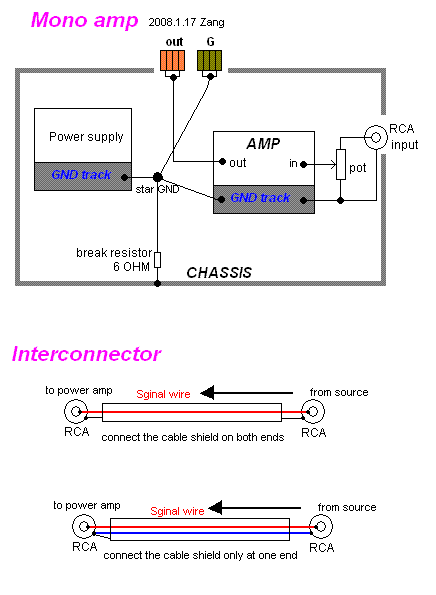

Can you post a wiring diagram of all the grounds and Zero volts and signal returns and how they all interconnect?
DO NOT put in that 6r "break" resistor.
That audio ground to chassis connection must be capable of passing Fault Current until the fuse ruptures and arc extinguishes or the Distribution board MCB opens and arc extinguishes.
That Fault Current can be many thousands of amperes. 6ohms in that route may prevent the fuse from rupturing for many minutes or even hours and in the meantime the exposed conductive components could be at or near mains voltage,

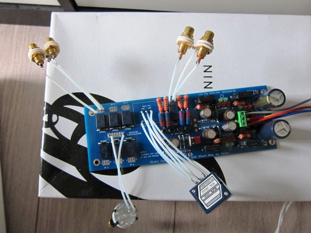

Vaguely (un)related: in the pic of the preamp (?) board shown in post #1147, I see unshielded teflon-insulated runs between the input RCA and the board, as well as the board and output RCA. They're short runs, but they're still going have pickup and radiation. Using dual-core shielded cables or dual single-shielded cables is nevertheless the better option for both input and output, even if it isn't Teflon insulated.
I'm guessing that the output return is isolated from the input signal ground, probably with a lift resistor for the input signal ground. Otherwise, there's still a possibility of a large ground loop through the (non-isolated) chassis grounds and the earth leads of the power amp (downstream) and the source (upstream).
I can confirm that there is no "loop breaker" between the signal ground and the output ground.
Similarly the two ground runs to the volume pot are also on this same common grounding trace.
Thanks for conforming that you would still use close coupled coax for all the short runs.
That's a practice I gave up more than two decades ago, maybe time to revisit. Strip the outer insulation and wrap a copper binding wire around the two shields? food for thought?
