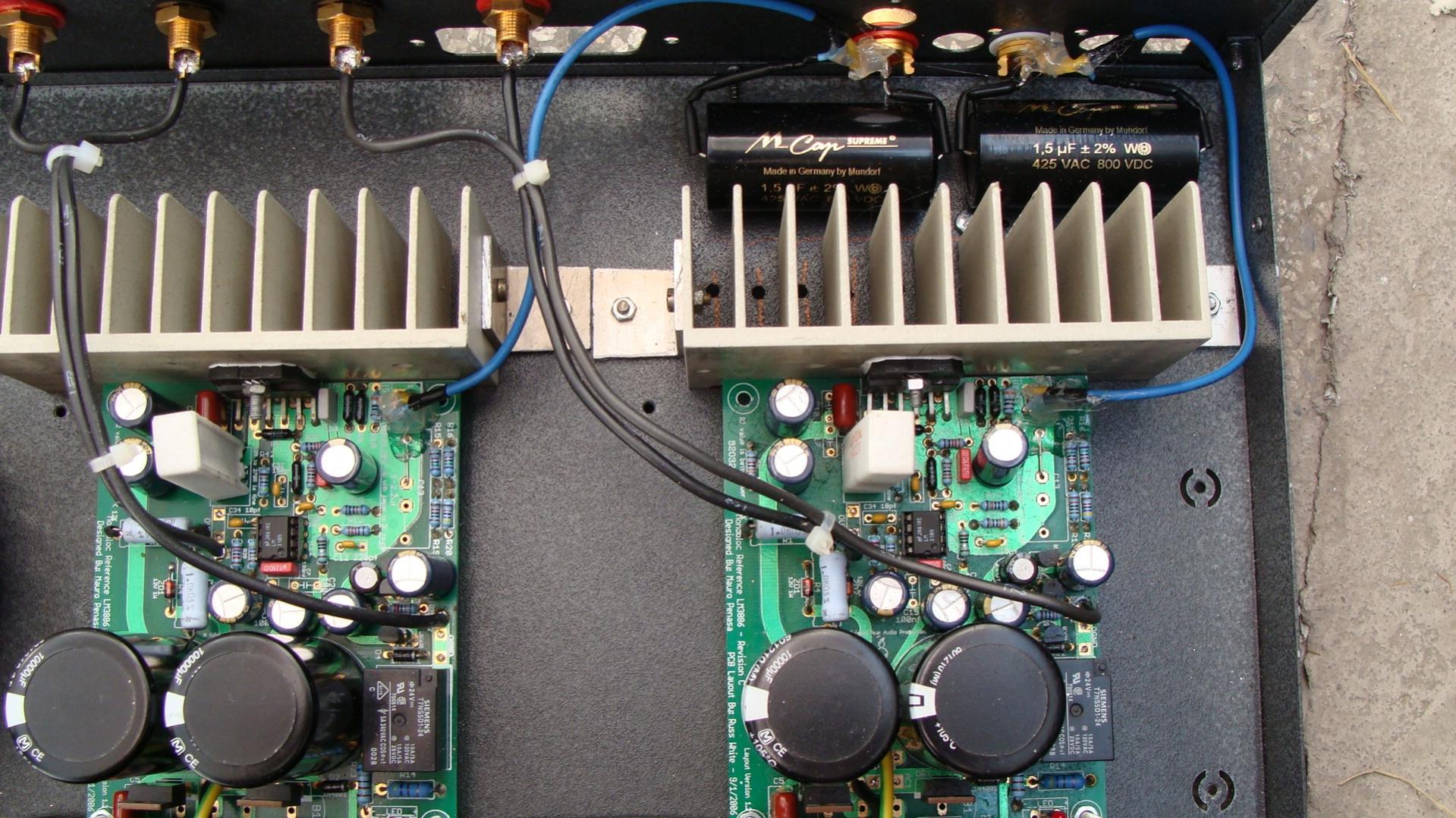

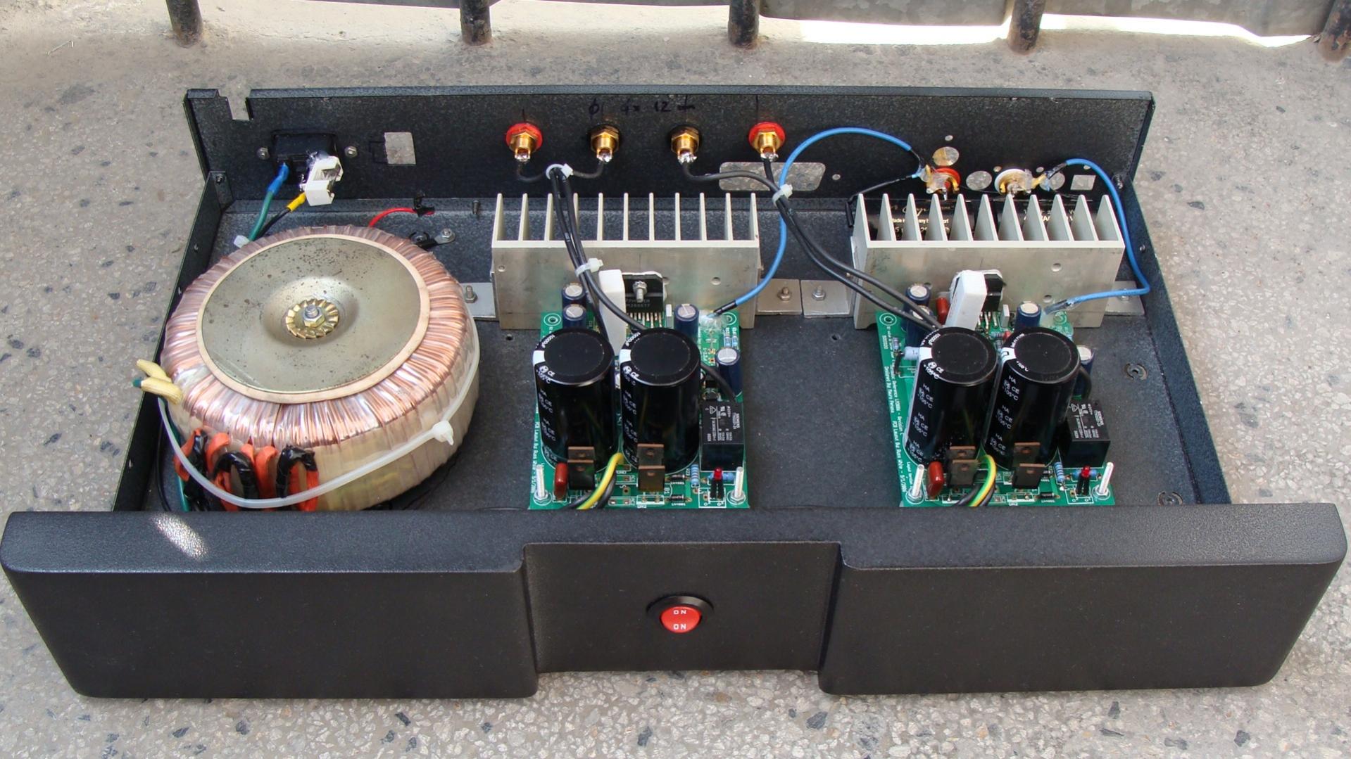

Another Myref finished
Hey guys here is mine Myref Twisted Pear kit with Mundorf input caps,500VA 4x22V trafo mounted in Diy chassis.
So far very solid deep bass but i feel the mid's need more time to open up. Maybe it's the Mundorf cap that needs break in?
Thank you Dario and all others for the suggestions! [ /B]
My bet goes for refurbished gear. have a look at the non-used holes in the back.My Gawd man! Where did you get that chassis!!! Looks great.
Whatever, a great looking chassis
Thanks guys! Too bad there's no more place for the Lightspeed attenuator....My Gawd man! Where did you get that chassis!!! Looks great.
Well i would have to make another bigger case
1) If it's a NatSemi LM318N, try rolling with TI LM318P.
2) Remove all the rail-to-ground bypass caps around the chipamp and LM318. From memory, I think they're C17, C18, C19, C20.
3) Try a Black Gate or Nichicon Muse KZ at C9.
4) Try a 10 or 22nF Wima FKP2 at C7.
Very nice chassis - nearly perfect, simple and uncluttered layout.
Thanks but where can i find the Black Gate for c9?
Would the black Gate sound superior compared to Nichicon Muse?
They're already removed
I agree for the BG but a Silmic II is better than a KZ
Also remove Wima MKS2 from C21 in case of the BG or swap it with a 22nF FKP2 if you use a Silmic or a Panny FM
It's not easy...
Yes, definitively.
Also consider swapping all Panny FCs with Panny FM for C1, C2 and Silmic II for C6, C11.
BTW It's a very nice build! 🙂
