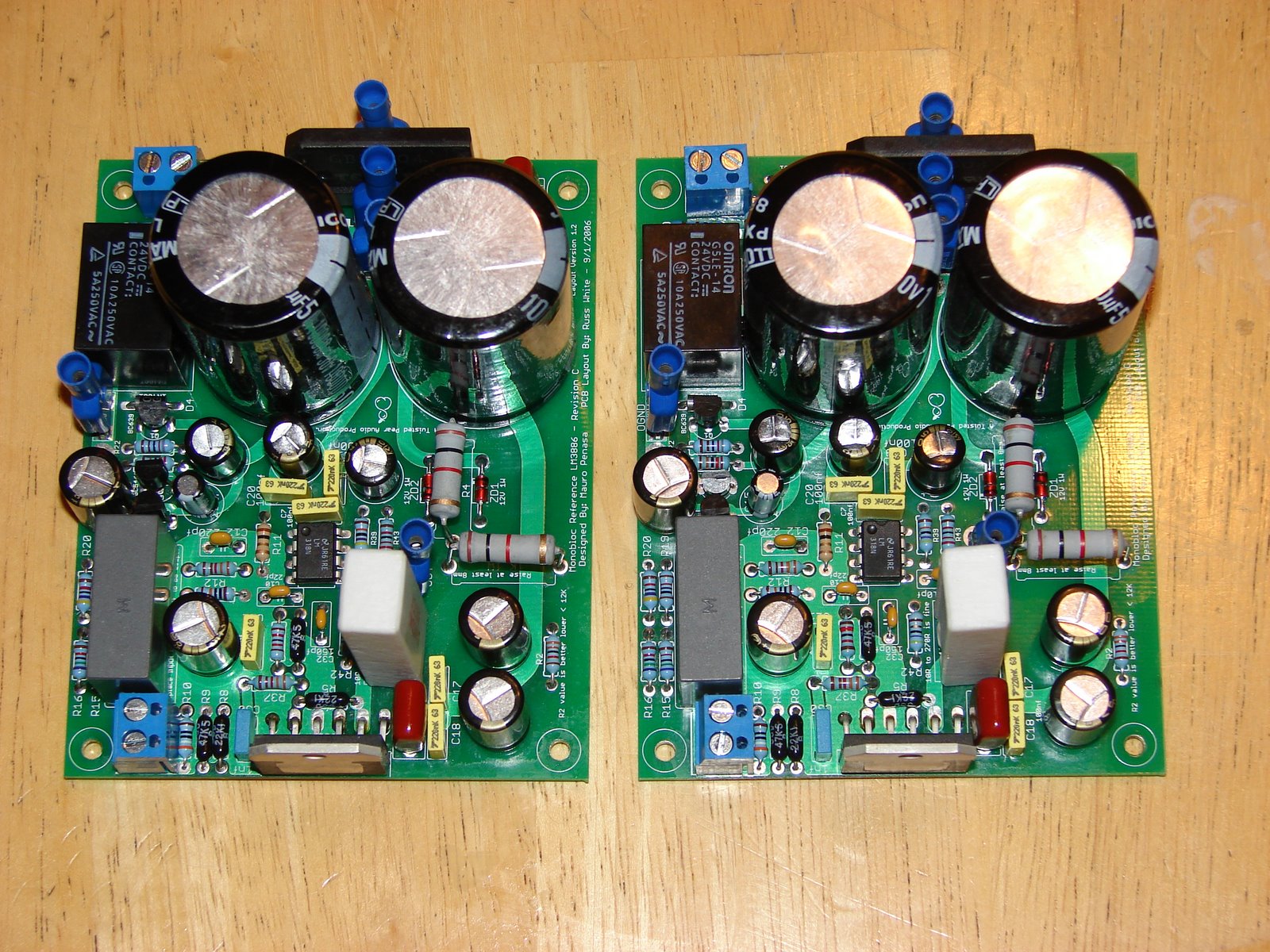

Hi everyone,
I've just completed my first two My_ref RevC boards and they both passed good audio first try, however I have a couple of questions.
Firstly, I'm using kits supplied by Peter (aka schro20), which have the 1.2 revision layout and his 'standard' components. The attached photo is the same as mine, though this one wasn't constructed by me.
While my amps produced great results straight away, and even better since they broke in a little, there is a noticable amount of noise at the speakers, with or without a source connected. My speakers are Audioline AL-600, an 8ohm vented 3-way that claim 94dB @ 1 watt - 1 metre sensitivity (though I'm suspect of this). In a quiet room I can clearly hear them hissing from a metre or two away from the speakers.
As each channel is the same I don't think I have made a mistake during construction (unless I've made the same one twice of course). Is the My_Ref RevC known to be a little noisy? This really doesn't bother me too much, I just want to know if there could be something wrong. I should also note that the amps are not enclosed and the leads are not shielded yet, which surely wont help.
Secondly, is anyone able to tell me the input sensitivity of the RevC? I have searched somewhat with no result. This will help in deciding what to put in front of the amps.
Thanks to everyone who has contributed to this great project. I love the sound of this amp so far and am looking forward to improving my system in general.

I assembled those units.
Your speakers are more sensitive than the norm of 87db.
Try shorting the inputs of the amp and see if the noise persists.
The MyRef is the most quiet amp I've ever had in my system, and that includes some very expensive SS amps. If you hear hiss, it's probably coming from somewhere else, but I can't tell you where. Hum would mean poor grounding or some other basic problem. I've never heard ANY hiss from this amp. Has anyone else? This amp is so quiet, it might be passing hiss from other components that you've never been able to hear before!
As others have already stated, this is one of the quietest amps ever. There should be no hiss at all, and any hum is likely to be as a result of grounding/shielding/pickup issues.
However, there are a few things that you can check/modify on your board:
1) Verify that the opamp is authentic NatSemi or TI.
2) Verify that the chipamp is authentic NatSemi.
3) If you're using an integrated bridge rectifier at BR1, replace it with discrete fast/soft rectifiers like the MUR8xx series at D1 to D4.
4) Use a high-quality snubber cap C7. Polyester film is OK, e.g. Wima MKS3.
5) Remove the polyester bypass caps at C17, C18, C19, C20. They aren't responsible for the hiss, but they certainly hurt the sonics and interfere with the 'floating rails' topology of the MyRef.
6) R1, R4 should preferably be CFRs, not metal-oxide as shown in the picture. Leads must be non-magnetic - the cheap metal-oxides are invariably magnetic.
7) Verify that all the resistors in the small-signal (ground-plane) area have non-magnetic leads to reduce EMI pickup. In particular, R10 and R13 shunt resistors should preferably be CFRs with non-magnetic leads. R7 should also be non-magnetic.
8) Use shielded wire from the source to the input connector - the input can easily pick up hiss from switching power supplies, PCs, CRTs, etc.
9) If ceramics are used at C10, C12, C32 and C34, they should be C0G with non-magnetic leads.
