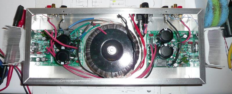

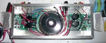

Hi Guys,
Thanks Uriah and Peter for the my ref C pcb's.
I've built up a stereo version with a 20V 200VA antek.
I'm using 1uF k42y PIO's.
First power up, no smoke 🙂 I get about 1.2mV and
around .50mV on the outputs.
They are hooked up to a pair of Maggie MMG's.
Pre amp is aikido 6SN7. Originally I'm using a mini-Aleph.
The Aikido and Mini-Aleph is a wonderful combination
to my taste.
okay, the my ref C, initial thoughts, the high's a very tinny,
women's voices have that sharp raspy sound. for movies,
it's not as bad but does not seems balanced overall.
I'll let it break in for while and listen later. Sorry, I'm
not trying to stir up anything, just my perception of
how it sounds compared to the mini-A.
it's definately a step up from the standard gainclone I've
built.

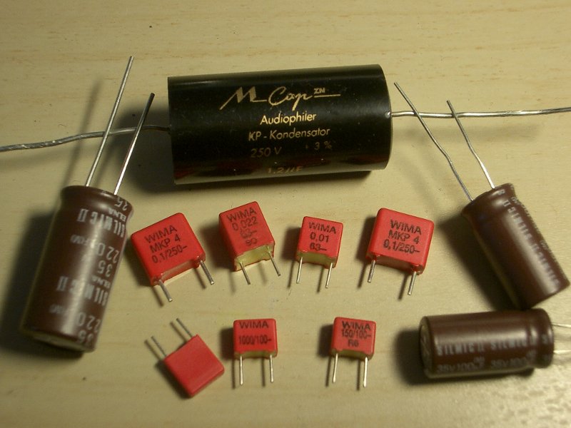

Bengali said:okay, the my ref C, initial thoughts, the high's a very tinny,
Bengali, I think you're right.
Thanks to my socketed MyRef I've just restored it to the initial state (FMs, BQs, bypasses and so on) and bass is bloating, sound is thick but highs are tin, harsh and too much, soundstage is wide but deepness is flat.
I've then started reapplying all my mods starting from the last: C32
Wow on the vanilla MyRef this single mod has a big effect on bass!
All others mods made also their magic but C32 already fixed some things previously fixed by others mods (mainly bass ones).
With all mods and FMs as elcos it sounds good but with the Silmics is much better.
I've then reverted to vanilla and after to totally modded:
they're two different beasts, for sure!
Little or no harshness, a granitic bass, more harmonics and reverb, deeper sounstage.

So changing the C32 150pF feedback cap from an AVX
to WIMA really made a difference?
I could give that a try on my next mouser/digikey order.

Yes Wimas FKP2 in C32, at least for bass, make a clear difference and add some harmonics too, particularly with FMs.

ClaveFremen said:C30 Wima FKP2 1nF 63V
C21 Wima FKP2 22nF 63V (to be mounted in the bottom side of PCB)
C4, C5 Wima MKP4 100nF 250V 7.5 mm lead spacing
C7 Wima MKP2/MKS2 100nF-220nF 63V
C32 Wima FKP2 150 pF 100V
C13 Mundorf MCap 1.0uF 250V (low cost, perfect fit)
C13 Mundorf MCap Zn 1.2uF 250V (best but outboard)
C13 has to be bypassed by a 10 nF Wima FKP2
C30 must be read as FKP2 1nF 100V (mines are 100V)
For those that want to try the baseline mod here it is the Mouser BOM for the Import Tool:
505-MKS2.22/100/10|2
505-MKP4.1/250/10|4
505-FKP21000/100/5|2
505-FKP20.022/63/2.5|2
505-FKP2150/100/2.5|2
505-FKP20.01/63/5|2
In Europe alternate sources are Banzai Effects and RS Components.

I did some search, and it seems that these have 6 Ohm impedance, and are not very effecient. Wonder if the transformer is not big enough.
Hi soongsc,
actually MMG's are 4 ohm impedance. that's why I chose 20V 200VA transformer instead of higher one.
aside from that, I don't need to turn it up very loud.
I use a mini-Aleph with the MMG's. the mini-A is only about 10W per channel. Sound is incredible, very smooth and wide sound stage. I can listen for hours and use it for movies as well.
I was hoping my ref C can produce similiar sound so I can build 5 channel version. It could very well be MMG's just not a match for the my ref C.

I pulled C13 and did DC Couple. Sounds much better. I still get the sharp 'zzzz'. What did you do to get rid of this sharp highs?
I watched Phantom of the Opera in HD and turned the volume up. Sounds pretty good for a little chip amp. 2 Channel music is good
but with movies, this amp does better.
