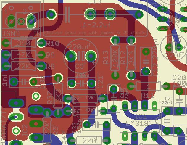

Here is a technical question for those of you so inclined.
The schematic shows a 1 ohm resistor, R11, connecting the junction of C12, R10, and R13 to GND. I am far from being an expert at reading schematics and translating that to what is on a PCB, but the My Ref Twisted Pear board looks different from how I am reading the schematic. On the board, R11 connects only C21 to GND and is nowhere near R10, R13, or C12. Well, the dang thing works, so everything must be okay. I am not sophisticated enough to understand the function of R11. Can someone explain it, and why it's placed where it is on the PCB compared to what the schematic shows?

madisonears said:The schematic shows a 1 ohm resistor, R11, connecting the junction of C12, R10, and R13 to GND. I am far from being an expert at reading schematics and translating that to what is on a PCB, but the My Ref Twisted Pear board looks different from how I am reading the schematic. On the board, R11 connects only C21 to GND and is nowhere near R10, R13, or C12. Well, the dang thing works, so everything must be okay. I am not sophisticated enough to understand the function of R11. Can someone explain it, and why it's placed where it is on the PCB compared to what the schematic shows?
As you can see in the attached board schematic R11 is connected to the entire signal ground plane.
To this signal ground plane are also connected R10, R9, R13, C12 and input ground.
C21 is not directly connected to this signal ground.
Hey Dario, nice to hear from you. Cool graphics.
Oops, I meant to write that, on the PCB, R11 connects C20 to GND, not C21. In the schematic, C20 goes directly to GND and is nowhere near R11. In the schematic, R11 appears to separate the 0 volt area from GND, but it doesn't do that on the PCB.
Looking at it again, it does serve to separate the input signal from the power ground area. Pretty clever layout, actually. I think I understand it now.

That 1 Ohm resistor slightly isolates "clean ground" from "dirty ground" but gives the input signal a ground reference.
I am kind of wondering, looking at the circuit, it seems the design if current source design. Has anyone any experience how this would effect sound when used in multi-way systems where there are impedance peaks in the mid range? Intuition tells me that this will effect the overall frequency response of the system. I also recall that Nelson Pass did some research on this.

As Uriah stated it's just two post upper but no problem... 😉
Get rid of all AVX BQs, use Wimas instead:
C30 Wima FKP2 1nF 63V
C21 Wima FKP2 22nF 63V (to be mounted in the bottom side of PCB)
C4, C5 Wima MKP4 100nF 250V 7.5 mm lead spacing
C7 Wima MKP2/MKS2 100nF-220nF 63V
C32 Wima FKP2 150 pF 100V
C13 Mundorf MCap 1.0uF 250V (low cost, perfect fit)
C13 Mundorf MCap Zn 1.2uF 250V (best but outboard)
C13 has to be bypassed by a 10 nF Wima FKP2
C17, C18, C19, and C20 are not used (leave positions void)
And finally the controversials:
C9 Elna Silmic II 220 uF 35V (tight fit)
C6,C11 Elna Silmic II 100 uF 35V

Unfortunately yeah. Mine broke during my move to Texas. I was not careful with the heatsinks and they are light so they were only held in place by the fact that the LM3886 chip was bolted to it. So in the move of course they bounced around and broke the chip off of the board. It can be fixed but I am selling it to a friend and building an F5. Of course now there is a BA1 to build 🙂 When will it end. I am also thinking that it might be easy to do a DAC since many manufacturers have eval boards I could use as a starting point. In the meantime I bought a TAmp from PartsExpress and run it from the computer. Its awesome for $40. Sound is nowhere near the MyRef but the soundstage is very large. I opened it up to see if I could mod it. That will be a hopeless endeavor except that I could replace the pot which I am sure would be a good improvement but I think I will just be happy with it and build the F5 then be ecstatic with that 🙂
To me if anyone is going to mod this MyRef you HAVE to remove C13 and put a wire in place of it then measure for DC. If it is still acceptable this is probably the best change you can make as it is very dramatic increase in quality. Then from that point get some LDRs and build a Lightspeed to drive them. After that I have not tried anything but removing a few 220nf caps from around the LM318 that I have mixed feelings about. Its different but the enhancements were offset by the negatives I guess. I suppose I was as happy with it as before I removed those caps, it just sounded different and the mid-soundstage was a bit pinched.
Uriah
Uriah
udailey said:Unfortunately yeah. Mine broke during my move to Texas.
What a pity!
Well, I think that with the Aleph you'll have some good time too 😀
I agree that DC couple is better than any cap but MCAP Zns bypassed are quite as good and all my tests were done with DC coupled MyRef...
and differences were HUGE 😉
ClaveFremen said:....and differences were HUGE 😉
you mean the differences between DC coupled and using a Mundorf?
