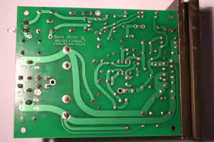

Hi All,
Well, I wired the amp to-gether with care and hooked it up to a cd player using the bulb dimmer and .... nothing from neither left nor right.
Can anybody suggest a series of checks?
I don't know where to start.
Thanks in anticipation

Pictures... That is the starting place.
Test AC voltage at the BR to see if it is getting ~24VAC...

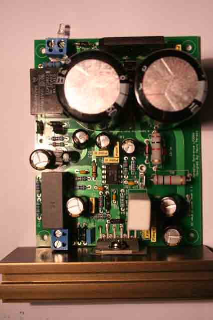

The first thing I would do is carefully (painstakingly...) check that all the parts are where they are supposed to be and that all the electrolytic caps are connected with the correct polarity (as well as diodes and transistors). Then the more painful check: that the values or the components are correct relative to what they should be. In other words read off the rings of the resistors to make sure the right one is in the right slot. Though that's very painful. Likely checking that you have the correct supply voltages in the right places is a good thing to do before then. What about the LM318? Is it in there correctly?
Yes. Pictures would help with some of these questions.

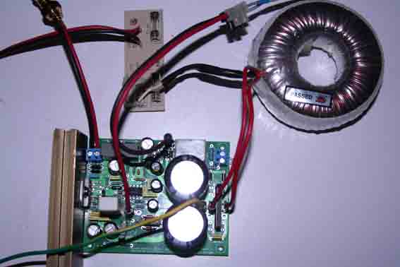

I took a lot of care when inserting the components so as not to make mistakes. I am colour-blind so resistors were handled with special care. The dimmer (20 W) does flash for a fraction of a second - I suppose as the caps are charging. I also put in an LED which just lights up - but only just.
What I suspect the most is that there has been a short between the heatsink and the printed circuit on the underside of the board, altough it must be really bad luck for this to happen on the two boards at once.
I put a heatsink on the transistors while soldering.
The toroidals are rated at 24.5V, 230W.
I hope the attached photos are clear

Looks like the transformer is a single secondary.. Won't work.. (unless you use 2 per channel)
Need dual secondaries or center tap..
If that transformer is >200VA and you have another you could used them both together and make a stereo unit. You would need 4 of those trafo's for mono-blocs.

Looks like the transformer is a single secondary.. Won't work.. (unless you use 2 per channel) Need dual secondaries or center tap..
O Sh---ttt. If that's the case I'll have to go looking for transformers again.
Just to try it out I can take the two I have bought (one for each board) and try them on just the one board. How should I wire them together then??
Tony,
The problem is the toroid
It need 4 leads coming out of it. Right now you have 0V and 24V rather than 24/0/24.
So Troys suggestion will most likely be your solution. Use two of those transformers and twist together two of their leads so that you can make two measurements with the other leads. Take lead ABCandD. Twist BandC together. Measure from A to BC and measure from D to BC. You will want to see voltages of +24 and -24. Then take BC and take that to the ground on your boards. The wire BC should be equal to 0V.
