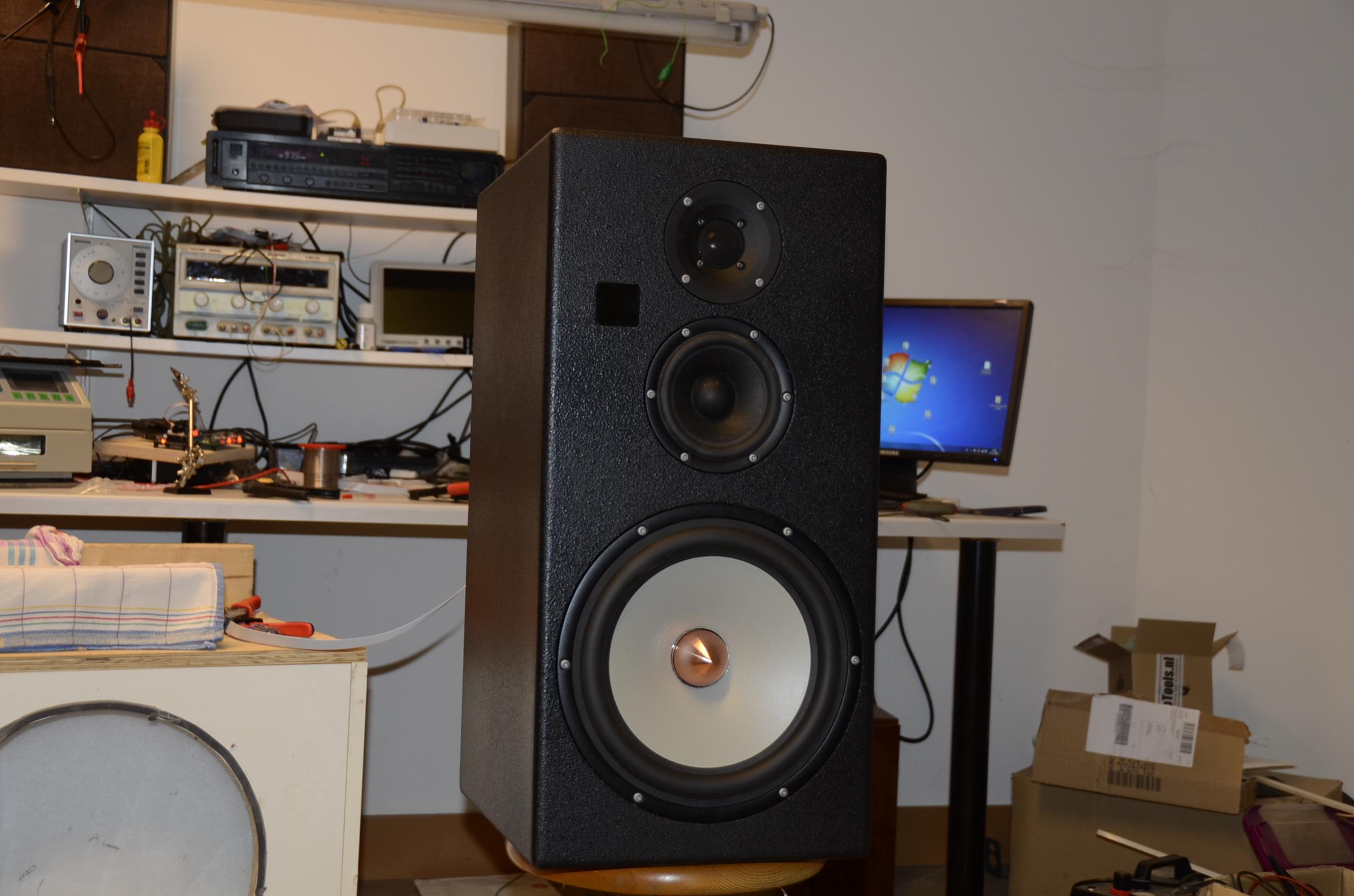

Well, my Fusion 567 ( Seas DXT tweet, Satori mid and 10" seas woof with digital motional feedback ( like the Grimm sub) with a 253 fusion outplayed with a large extend a set with Vivid G3 driven by Mola Mola amps and dac at Hypex....
Interesting! Can you elaborate?
A pity that you mounted the Satori mid and Seas tweeter in the center of the baffle; slightly off center would have been better.
Even with DSP you can not correct baffle diffraction.
