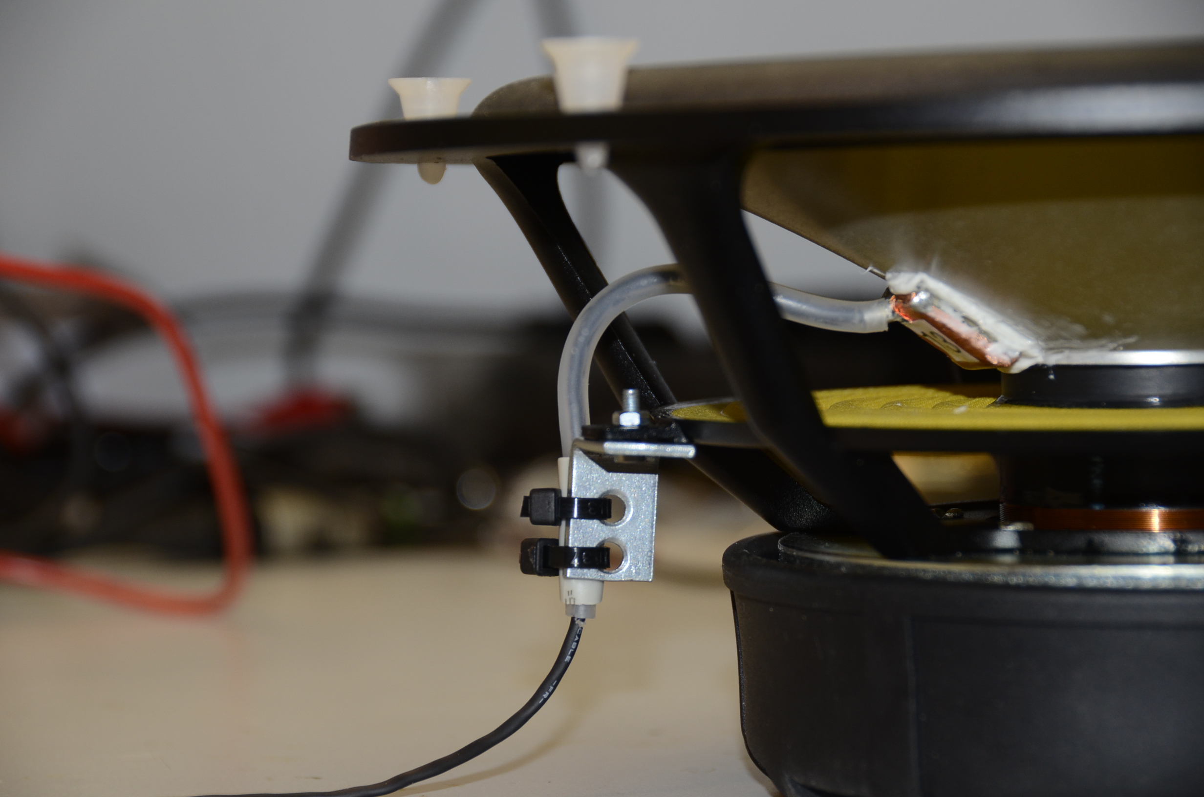

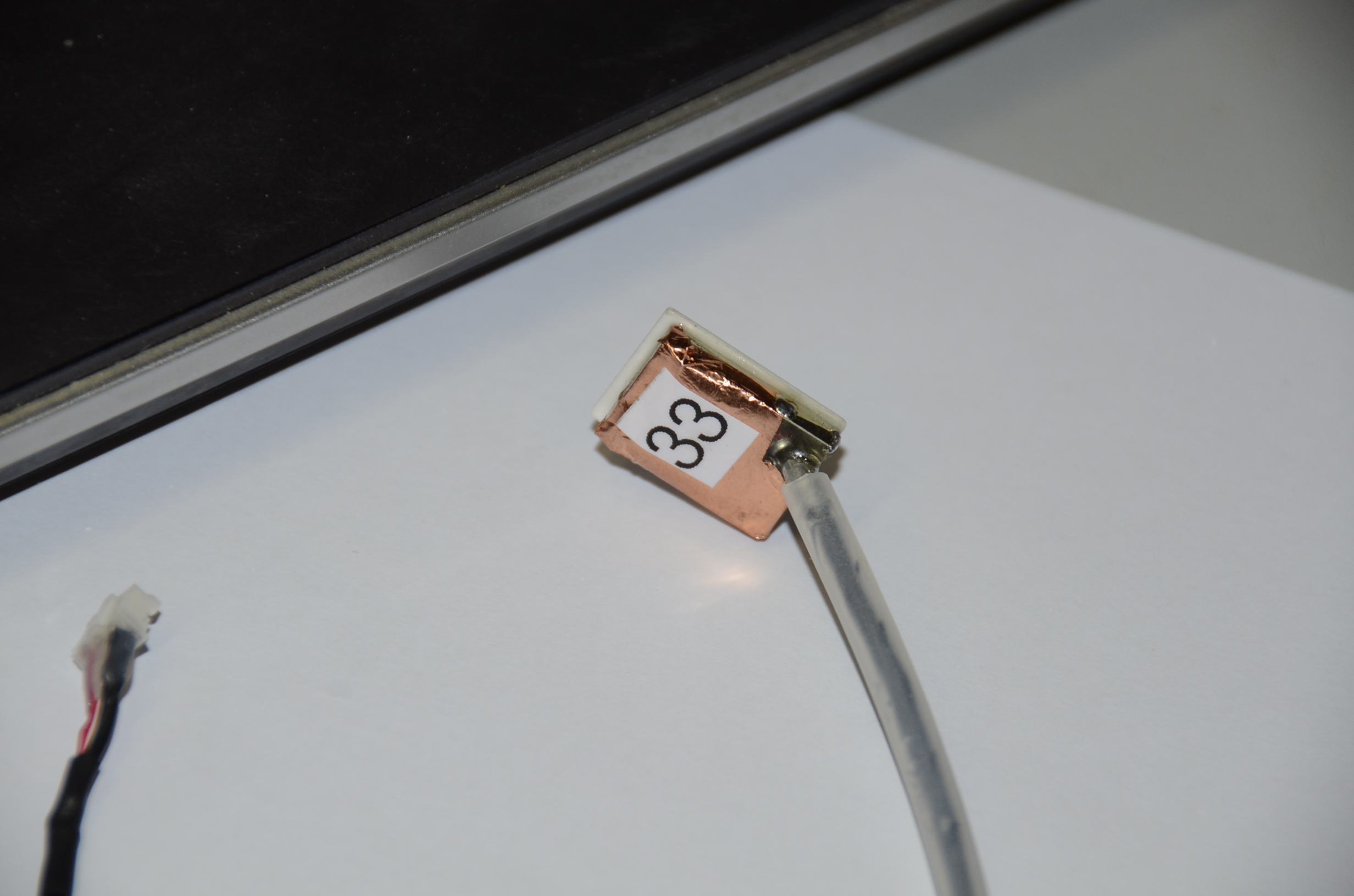

A better one:
781129d1568380088-hypex-fusion-plate-amps-_dsc2647-1-jpg
781130d1568380088-hypex-fusion-plate-amps-_dsc2653-1-jpg
Oh my... Are you saying that I in the near futur will be able to buy a module for my FA253 so that I will be able to use MFB on my woofers? :yikes:
This has always been a dream to experiement with!! :eek:
Please do keep us updated on how this progress! Any timeline already?
It is really awesome how they keep upgrading these amps! And thankyou for sharing these things with us!
