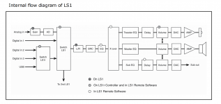

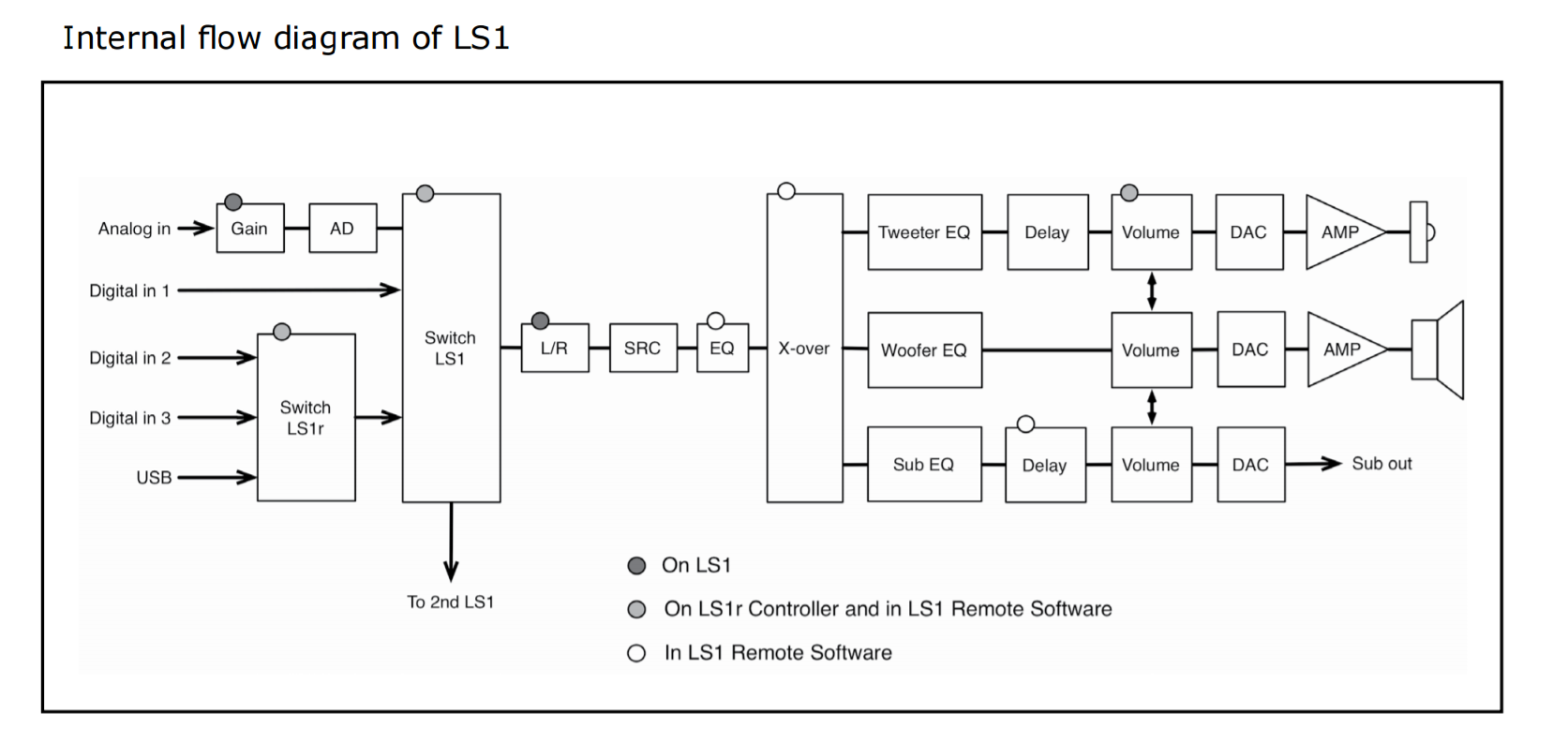

I've been studying how the Grimm LS1 does things. Similar setup, but done with very great care. The master clocks have a very low phase noise, and high stability. Then the link between the left and right channels is done with a high quality CAT 5 cable. So because of the great care taken, and high quality components used, the speaker clocking should be fairly even. But at the end of the day I don't see any measures to ensure perfect sync between the 2 clocks, like there is with IEEE 1588v2. It's basically putting 100% faith that the clocks are dead nuts and won't drift apart over time. I think the system could be improved upon using Ravenna. Also greatly simplified.
In a stereo pair of speakers, what would be the actual problem/effect of a minor long term drift in clock?
Within each speaker everything operates off the same stable clock.
I can't see why the equivalent of a very slow movement of one speaker should matter
