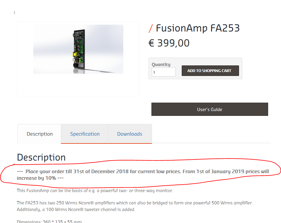

@DannerD the price increase isn't new revised versions, in their email its simply costs have gone up.
