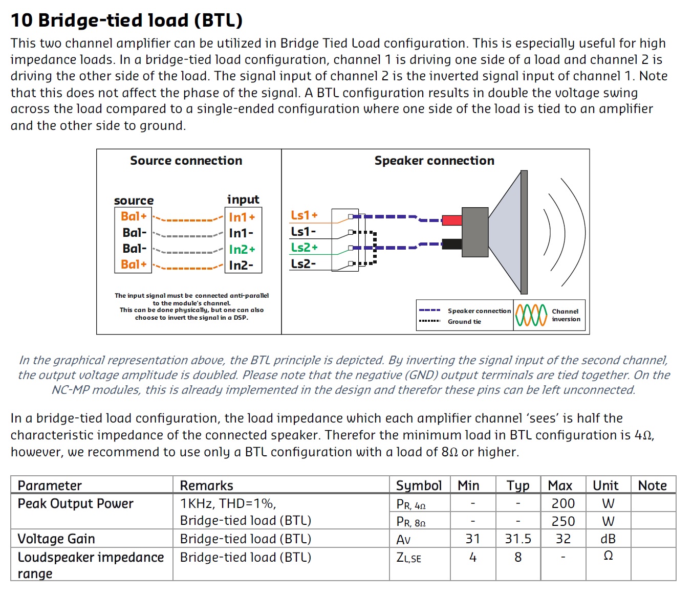

Hi there,
I purchased the 123 Fusion Amp. But I use a 4Ohm Bass/Midrange. I now drive the driver in BTL mode and connected the red and blue cable to the driver (But 8 Ohms are recommended). I left the grey and black alone, do I have to connect the grey and black ones?
Is it possible to turn off one Channel of the Amp?
Or do I have to solder an 8 Ohm Resistor in one Channel and mute it?
thanks
chris

Have a look at this attachment.
Do NOT connect a resistor. Just use both channels. You could potentially burn down your house if you forget to mute:eek:.
