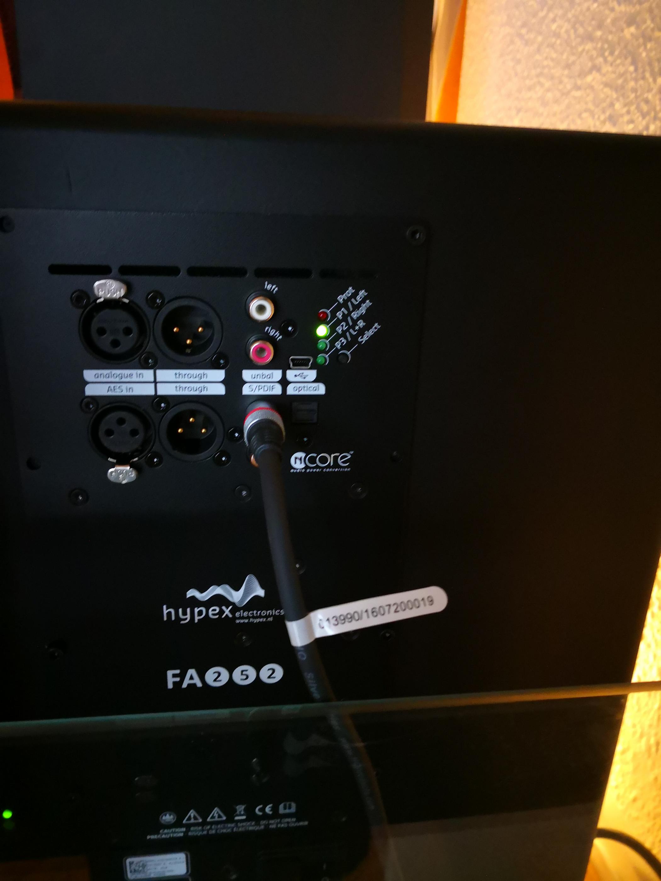

cant get any sound out of my sub.
i have a FA252
i have forced indput to S/pdif
make a filter with lowpass at 70hz
uploadet filter.
turn off my sub
connectet indput cable and turn it on.
tried to get some sound with aome test on youtube. but no sound a all.
so what have i done wrong?? :)
mabye there is some one that will make a totural for noobs like me ;)

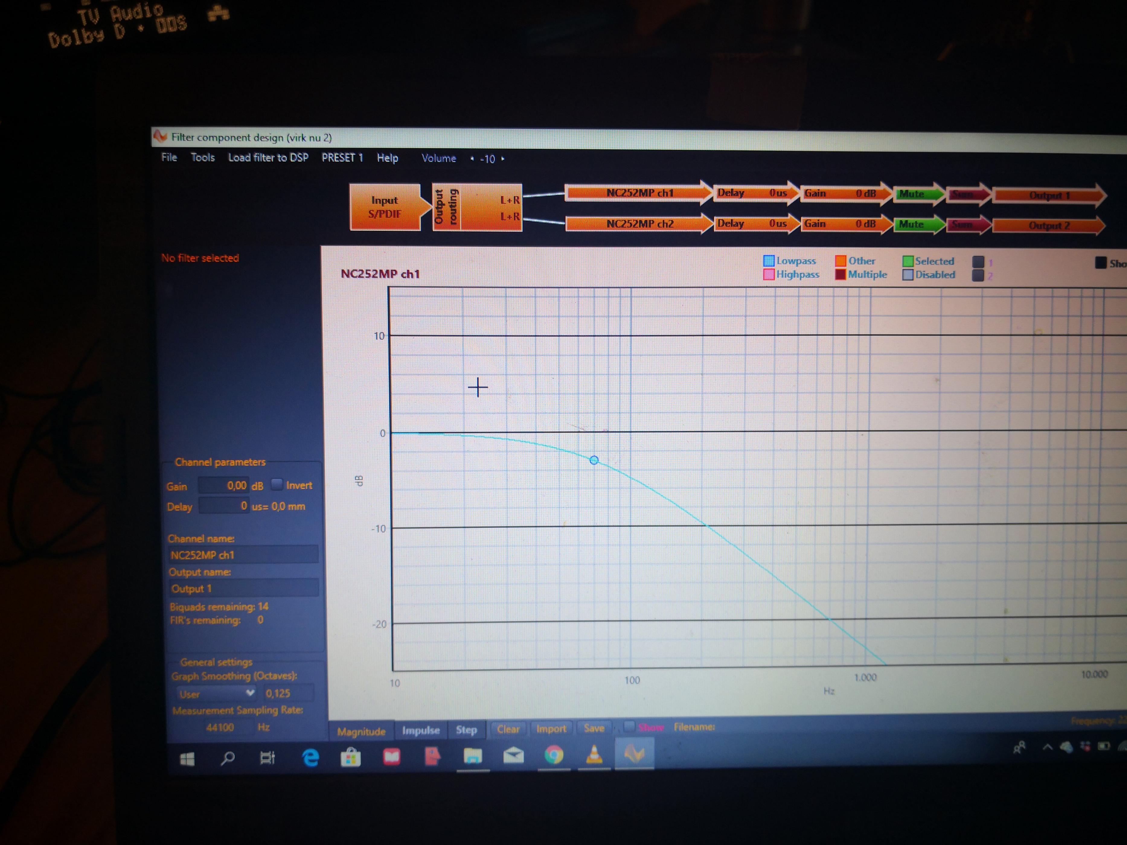

Here i a pic of My filter so far.

Here is a pic of My filter so far.

The gain of the filter is 0dB ;) According to the given link and my setting, it should be at least 10dB, depending on the gain of your amp.

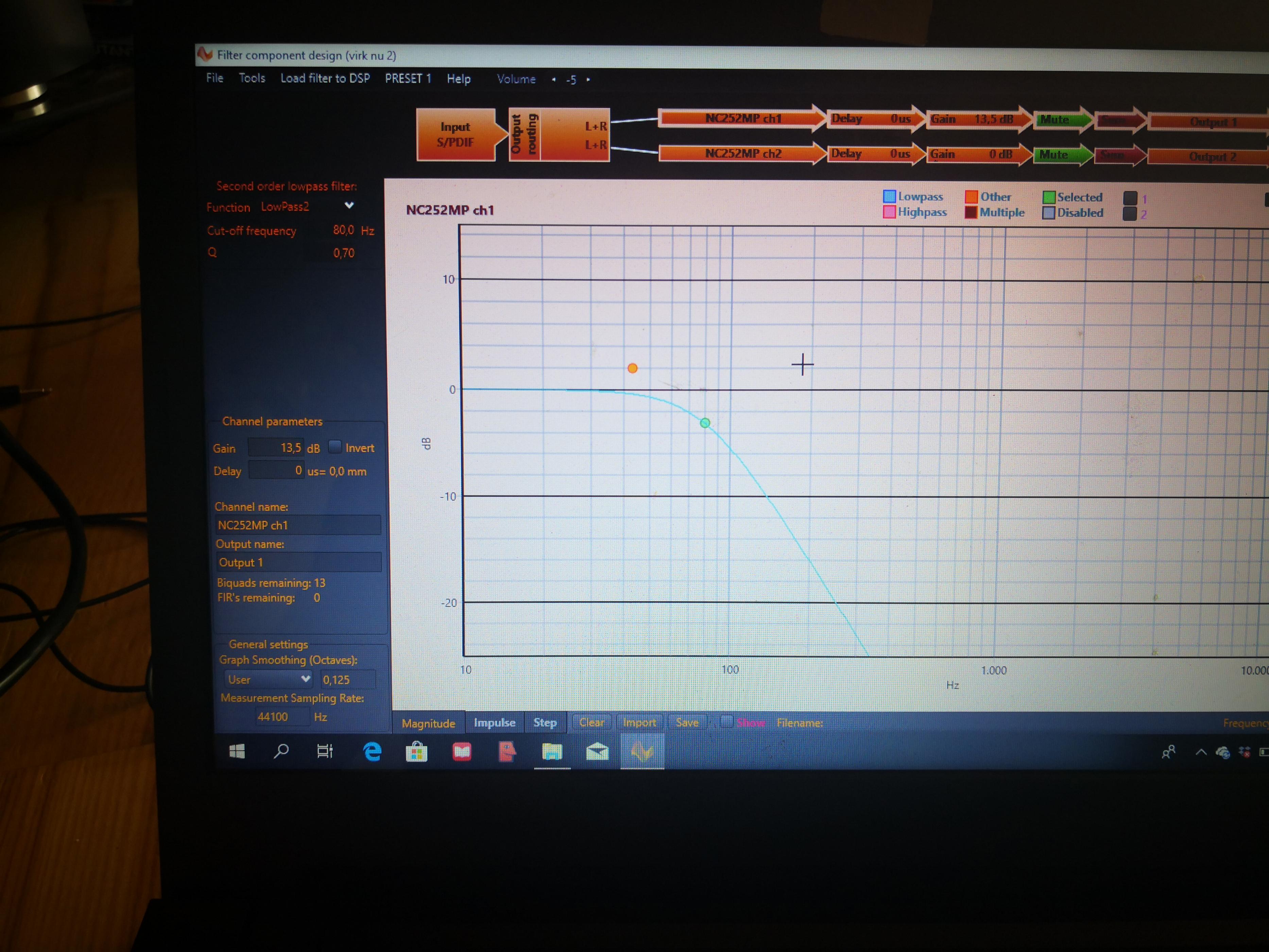

I tired to do as the guide, and still No sound.
Tried to turn the volumen op to max, and still No sound or wibration from My sub.
Any suggestion fore what to try next? 😊

And set volume start up to -3dB from device settings screen. Watch up your source volume when play.
i only have digital output on my marantz sr7012
i have a remote control to hypex so are turning up wile i test on youtube.
