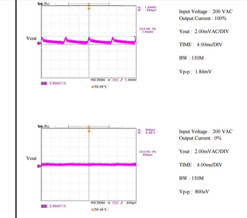

I was thinking about offering my Purestream DAC as a DIY kit. If so I will offer the NZ2520SDA's as an option. You'll also be able to select your own 990 pinout discrete opamp for the gain stage, as well your own caps and TO-220 type regulator for the regulator board. SMPS optional for the feeder supply, but I recommend the Daitron HFD series in +-15v. Pretty impressive P-P ripple noise for a feeder supply. Under the Purestream load well under 1mV P-P ripple. No problem for the Belleson SPZ/LT-3042 combo to clean up with the more than 200dB of PSRR!
