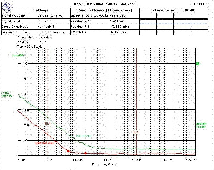

But wouldn't that phase noise show up in the measurements?
Of course it would. Take a phase noise measurement with the Microsemi 5125 right before the DAC board and you'll get a reading. You will find it's much worse than the same grade of clock in 22Mhz.
As an example, look at the 10Hz phase noise difference between the 22Mhz and 100Mhz in the Pulsar OCXO. And remember every 3dB is double, and goes up exponentially every 3dB.

I can get far better performance from a $2 NDK NZ2520SD @ 22.579Mhz, than a 400 Euro Pulsar @ 100Mhz.

It depends on the clock. You can get near equivalent phase noise from a
100MHz clock to a 10MHz clock by using clock multiplication or phase locking.
It depends where you want your phase noise, using multiplication will throw
away HF phase noise floor for LF phase noise close to carrier. Phase locking
will get best of both worlds. I've seen phase locked 100MHz OCXO's with
better than -120dBc at 10Hz. This translates to a 10MHz clock with
better than -140dBc at 10Hz.
Bruno knows exactly what he is doing and you can guarantee that 100MHz
clock will have phase noise characteristics that are superb.
http://www.pulsarclock.com/ds/Pulsar_Clock.pdf
Unfortunately that is not the case. The Phase noise is referred to carrier so
for an equivalent jitter the phase noise of 20MHz clock will be 6 dB worse
than 10Mhz clock. And so a 100MHz clock will have 20dB worse phase noise
than 10Mhz clock - but same jitter.
Now for other reasons, generally most clocks degrade much more than this
6dB per doubling of frequency. So in fact the Pulsar 100MHz clock at -110dBc
at 10Hz offset is a very good spec and equiv to a 10MHz clock of -130dBc.

Clock prescaling or multiplying always adds major jitter, not reduces it. You can't get less phase noise from a clock than the clock has itself. All you can do is try to minimize more from getting into system downstream. I have no doubt he's using greats clocks. But he can't defy the laws of physics. Higher frequency clocks have higher phase noise. The same grade of clock in 22Mhz will have several times less phase noise.

I asked my friendly neighborhood clock guru his take on Terry's statements. Here's what I got back:
Statement: "It depends on the clock. You can get near equivalent phase noise"
Response : "Key word is "near equivalent". But, the way most folks look at things, they will come to a wrong conclusion."
Statement: "from a 100MHz clock to a 10MHz clock by using clock multiplication or phase locking. It depends where you want your phase noise, using multiplication will throw away HF phase noise floor for LF phase noise close to carrier."
Response: "True."
Statement: "Phase locking will get best of both worlds. I've seen phase locked 100MHz OCXO's with better than -120dBc at 10Hz. This translates to a 10MHz clock with
better than -140dBc at 10Hz."
Response: "Only if you start with a really good clock, to begin with. You will not be able to get better than the ref clock. Not sure his math is 100% correct, but it can be done. With a lot of work, and parts. But, not entirely out of the question.
Of course, people will point to SPDIF, and how noisy it is. It is, but only because it needs a wide capture range and fast lock-up time.
Part of the problem is that you can not pull really good crystals very far. Whoever makes the crystals better be good at what they are doing."
So my take is no matter what sort of trickery you do downstream, you will never get better than the reference clock itself.
