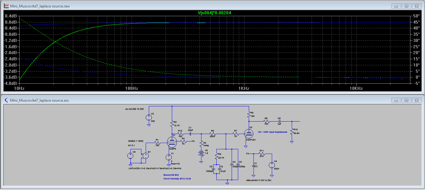

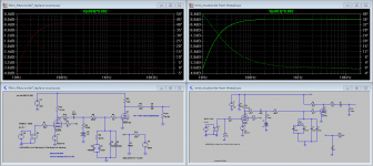

can someone explain where i am making my mistake. when i run the attached with an .ac oct 256 10 20k i get nothing approaching the riaa curve. thanks for any help
I have just gone back and had a look at my simulations and I realized that the .step command did not execute correctly, and in fact as I originally stated in simulations at least the circuit is quite sensitive to the value of C7, and 1uF causes a pretty big roll off in the bass. Can't win for loosing I guess, that said I will need to remeasure the RIAA response but I expect to see the same huge error at 20Hz.. I will do this next week..
I tried a number of substitutions in your circuit and added a laplace transform controlled voltage source to provide the inverse RIAA. The tale is told...
Subjectively there is no lack of bass, and it is actually sounding good - so my suspicion is a few identical cheap caps in parallel may do the trick if the simulation results are borne out in practice. (I expect they will be)

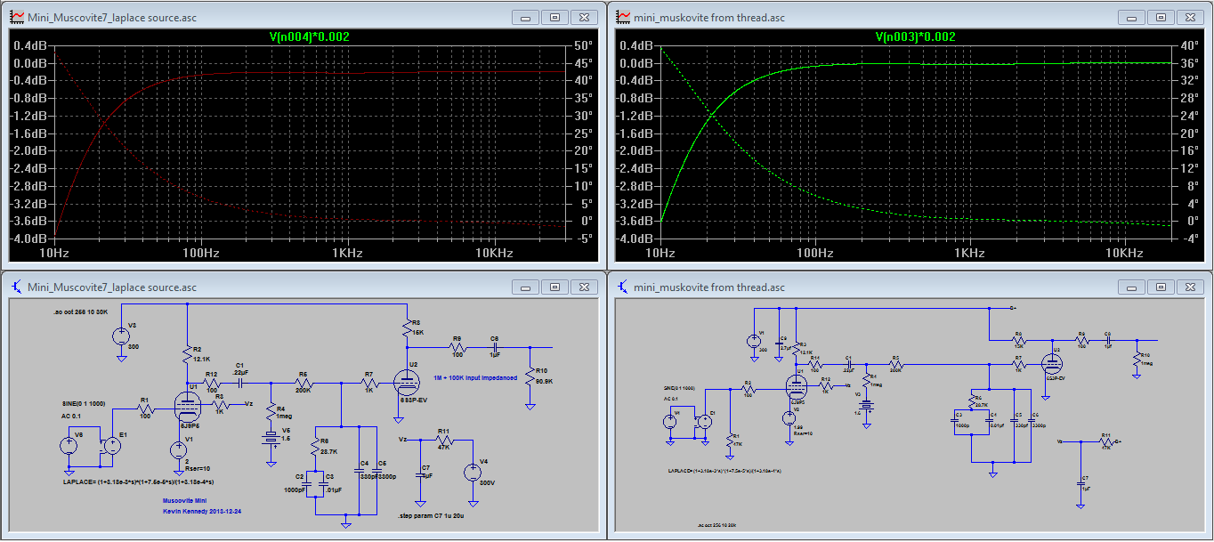

OK I figured out what I did wrong with the .step param directive in spice and fixed it.. Duh..
Anyway I have attached the corrected capture below and you can see quite clearly the effect of 1uF vs 20uF at C7.
It appears a big honkin' cap is actually necessary if you want that last octave within reasonable bounds of RIAA accuracy. My system has no usable output below 30Hz so I can probably get away with it..
