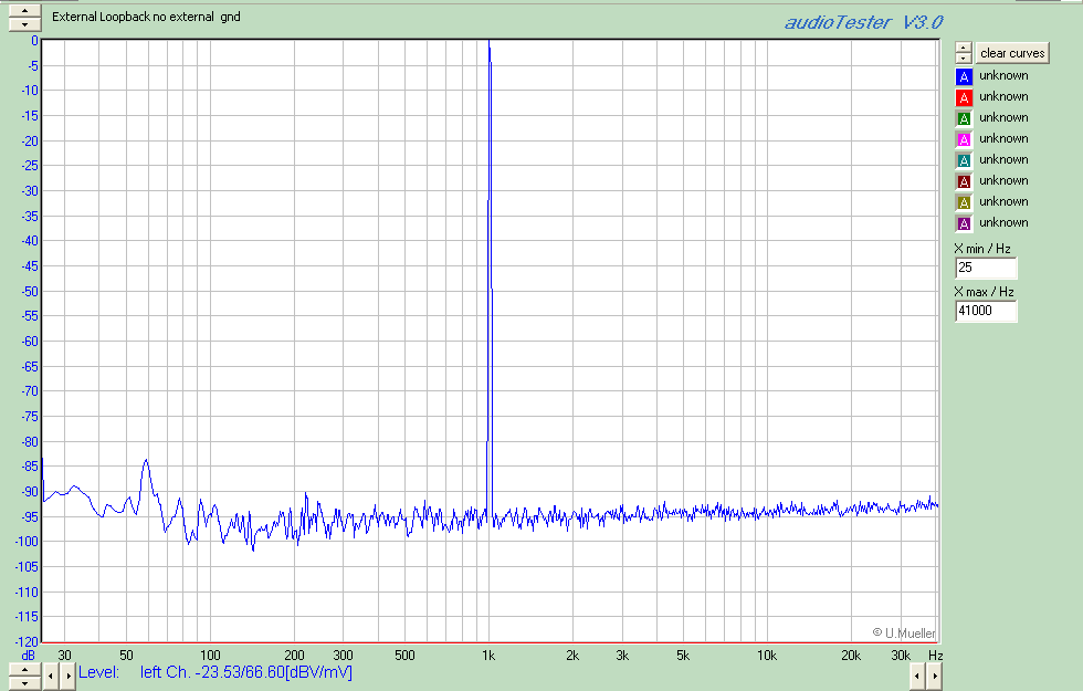

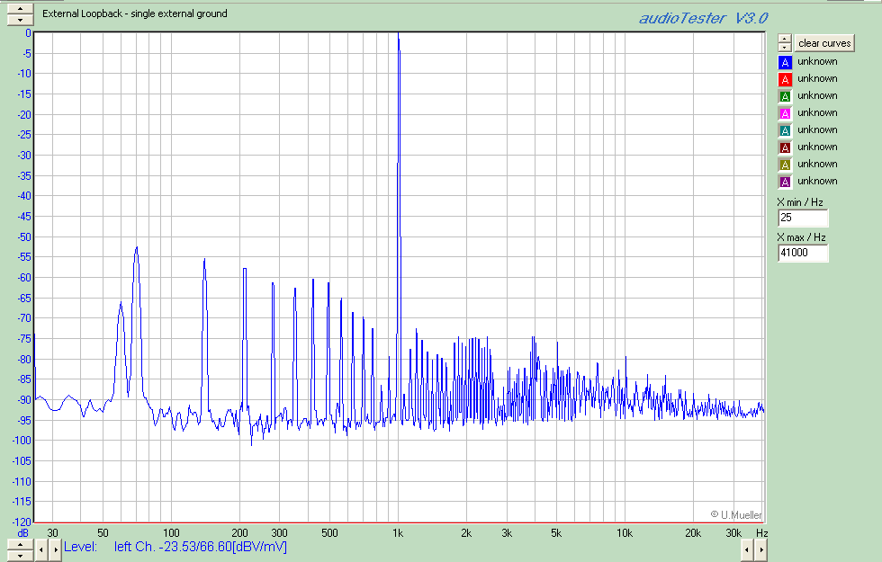

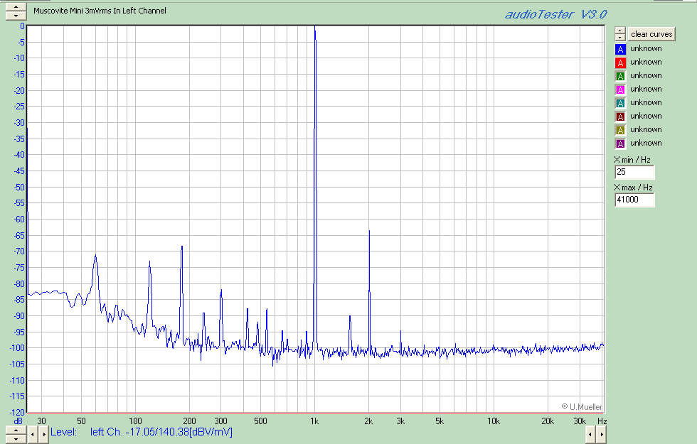

Indeed they are both PIO caps..
The second stage is the dominant distortion source in this design.. The most recent measurements show 2nd @ -63dBr and 3rd @ -95dBr this is with a 1kHz fundamental. (Attached)
Measurements of the 6J9P were pretty impressive in terms of distortion, but I neglected to save the graph. It is a well made tube with good internal geometry. The distortion was stupidly low ..
Notice the pentode 1/F noise is all done by 200Hz, interestingly enough a reduction from 15mA of plate current to ~10mA of plate current resulted in a reduction of 1/F noise of 10dB. I was surprised.
I've attached a recent measurement graph with some trepidation as I am definitely having problems with pick up of line frequency harmonics in low level measurements with external devices. I see this to some extent with any device connected to the measurement setup. The source seems to be leakage currents from the computer PSU, but using an isolation transformer does not significantly affect it. Lifting the safety ground on the server is not something I am willing to do, lifting all other grounds does help to a significant extent.. I plan to try some WE REP111C between the sound card (balanced I/O) and Millett sound card interface providing full isolation between the interface and the front end/DUT.
My system is all unbalanced and my Schick tone arm does not support balanced operation, however both of my other arms do, one is a modified SME 3009 Series II, the other a clone of the 3012 Series II/R which I built from a kit and a lot of SME parts.
Perhaps at some point we can do an all balanced Muscovite with MC input stage included. SY has however beat us to the punch with his latest design in Linear Audio..
(Note: I usually forget to reset the scaling when I change ranges output level here is roughly 1.4Vrms relative to 3mV input, and there is a small uncertainty in the input level as well)
FFT
I have done two measurements using an attenuator to reduce the 1.1V output of the generator to approximately 6mVrms. One measurement is just the external loopback with no external ground paths deliberate or through the parasitics of other devices to mains or mains ground, the other is with a SINGLE external ground point
I do my measurements with all external grounds lifted in order to eliminate ground loops, and I may try powering the DUT (Muscovite Mini) through an isolation transformer the next time I have it on the bench in order to eliminate parasitic coupling through the mains. (Maybe)
At more typical signal levels this stuff would be in the mud, doing phono stage measurements it is a real problem, and I am still trying to come up with a good solution.
The source of all of the nasties seen is the supply in the PC that does the measurements. For safety reasons I am very adverse to modifying the supply and I am not sure in any event that it would help.
Ferrites helped substantially with HF nasties which were also present. The front end is well shielded and this alone was a rather substantial improvement - I am going to see what other things I can do with grounds to help this issue.
Bear in mind that all of this crap is relative to a fundamental at 6mVrms..
