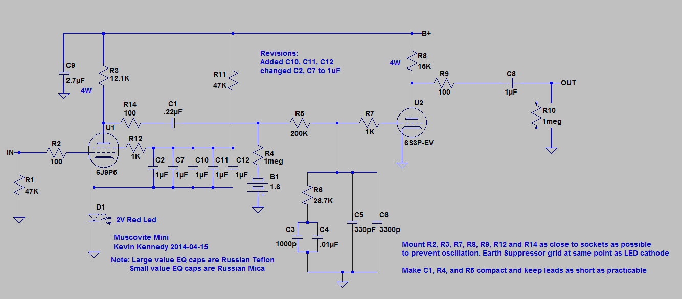

In terms of further possible improvement to the Mini (not the mini II) I would recommend replacing C2 and C7 with five 1uF capacitors in parallel. The problem really is that the screen cap is providing the current for the AC portion of the screen current swing which is why its quality is so critical. Ultimately the K71-4 did not prove satisfactory in this location.
I have switched to a cascode front end so have not yet tried this change, however it is consistent with the direction I have been pursuing with the 6J9P.

I actually did try 20uF with several high quality caps in parallel (0.1uF etc) and it did not work very well sonically. There was quite an audible suck out in the mid range - possibly something in the range of a couple of uF in parallel might have worked.

Something we did back in the Eighties when a relatively large film cap (say 5 microF) was required is split it up as follows:
4.7 microF + .47 microF + .047 microF etc. (10% rule). The smallest values could then be polysterenes for example.
If I'm not mistaken the MIT Relcaps are built in a similar way?

Midrange? Goodness! That's difficult to understand since there should be little voltage across the cap; some sort of resonant behaviour do you think?
Hi Frank, Piano,
Yes the Rel (now Audio Cap) are sectioned usually into 10 equal sections except in the case of a few cheaper ones. (TFT and RTX 10, RT 2 IIRC)
I used to parallel caps a decade apart in value, and tried something similar with the 20uF cap.. Haven't found it necessary in a long time to do this except with large caps of course. (Did it in the GM70 amps for some large bypass caps - worked fine there)
I suspect a resonance as well piano..

From looking at the base diagram of the penthode it seems the suppressor grid is not connected internally but is led out to pin 8 (IIRC).
Did you just connect it to the cathode?
If so, and you have a spare film cap of a few 100nF, do you mind trying to connect pin 8 to cathode through the cap a la Decware or is this nonsense?
Just curious about the effect if any, that's all.

It was directly connected to ground rather than the cathode, and unfortunately I rewired the pre-amp to use the 6N14P so I'm not able to further experiment at this point in time.

My final take on this design would be to say that it ultimately evolved into the cascode input stage Muscovite Mini II using the 6N14P which is a much better sounding design frankly. While I doubt anyone has built one of these yet I would very strongly recommend building the cascode version instead of this one.
http://www.diyaudio.com/forums/analogue-source/254641-muscovite-mini-ii-6n14p-phono-stage.html
The good news is the conversion took me under 30 minutes to complete and eliminates the problematic screen bypass cap issue completely. The 6N14P is extremely inexpensive at this juncture and the ECC84 will work quite well also.
