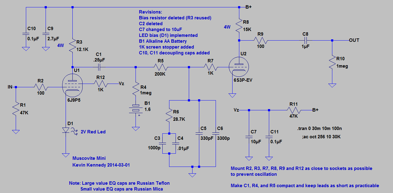

Have you tried this preamp that has a corresponding EQ network with lower values of the serial resistor, say 15-20 Kohm?
I generally like at least 10x greater series resistance because the load impedance with passive EQ varies with frequency and results in response errors due to changing gain which is measurable with pentodes. I have used networks with series resistance as low as 27K with high transconductance triodes with an rp <3K..
Another concern relates to aging effects causing increasing rp in triodes, and decreasing rp in pentodes which will result in changes in frequency response over time.
Distortion is a concern as well.

I decided that in this design simplicity would rule, the 6ж9п has quite high transconductance and is running at slightly over 10mA, the effective source impedance with RL and rp is approximately 9K.
The muscovite uses a relatively high current cascode in the front end and a choke augmented mu-follower in the second stage.
Slew rate is something I think about as well which is another reason why I avoid very low impedance EQ networks. The trade off of course is noise.

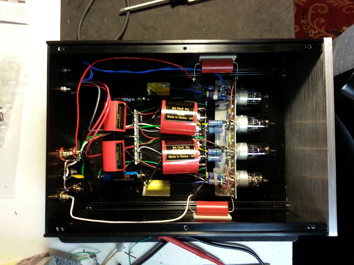

Tonight I finished the PSU for the Muscovite Mini. I built a stereo version of the PSU using 6W6 as the pass tubes.
The whole thing is just packed. I managed to fit three power transformers, a choke, seven electrolytics, two large Clarity SA film caps, a Chinese made regulator for the filaments and the last two pcb I had left over from a long ago project for the HV power supplies which I have modified for the current supply version.
Updated audio chassis schematic (retrofittable)
Some more minor updates for the individuals who are currently building this design.

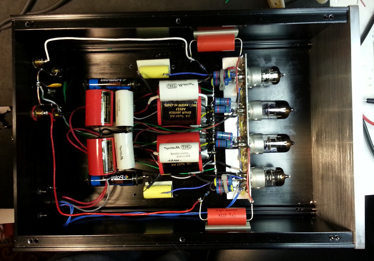

To my considerable chagrin I have discovered that the Clarity SA cap on its own is not of sufficient quality to bypass the screen - it has audible colorations. I mitigated this significantly by installing a 0.1uF RTX in parallel with it. You could probably carry this a step further with an additional 1uF cap. Note that I have not measured or heard any evidence of capacitor resonances as a result of doing this. Since this proved to be audible I shunted the local 2.7uF supply decoupling cap with another 0.1uF.
I have attached an updated schematic here.

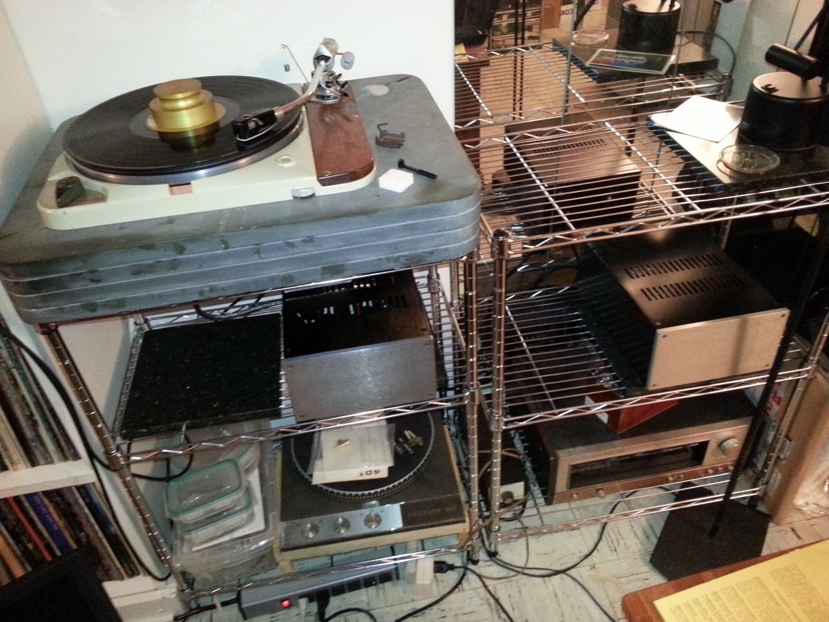

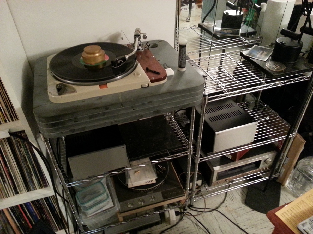

I now have two fully independent TD-124 turntable set ups, the reference comprises the Muscovite, LL1941 suts, Schick arm, SPU Royal N.. The development table currently has a modified SME 3009 Series II, Meister Silver SPU, LL1941 SUTs, and Muscovite Mini..
The ultimate goal was to drive the Mini in the direction of comparable performance to the reference Muscovite. I believe I have succeeded. Anyone building this with sufficient care should be pleased with its performance IMHO.
